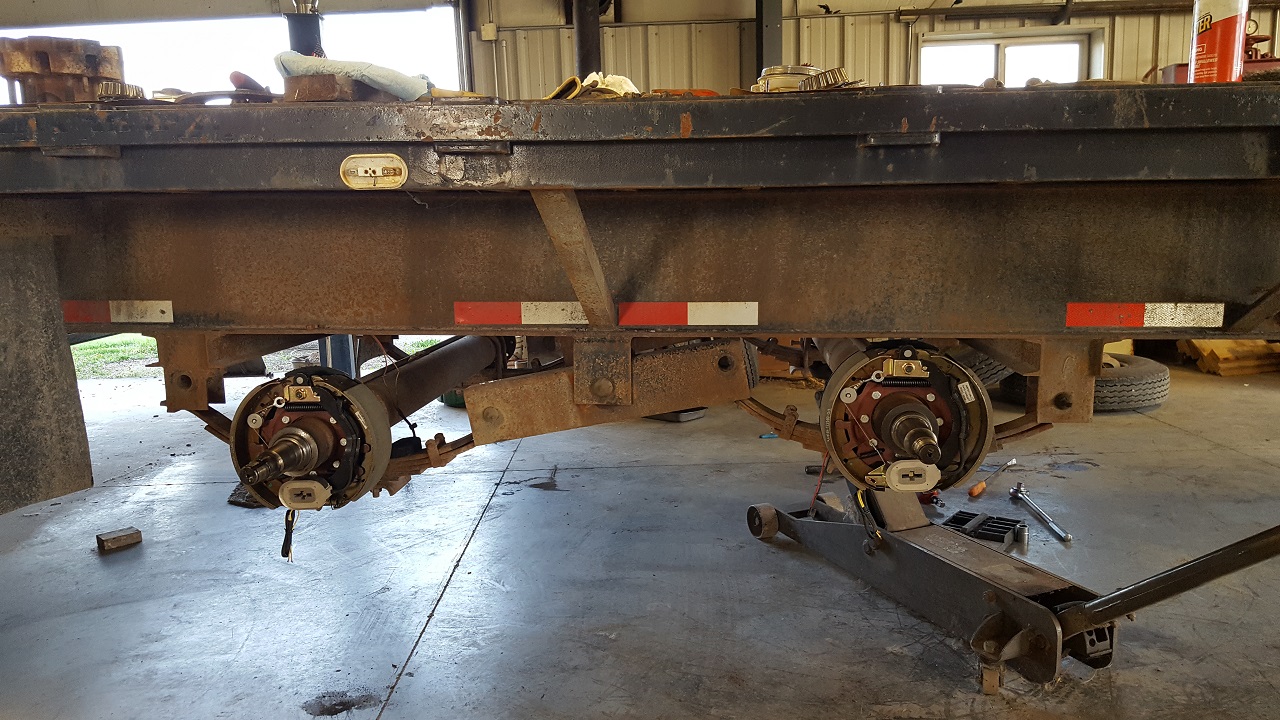

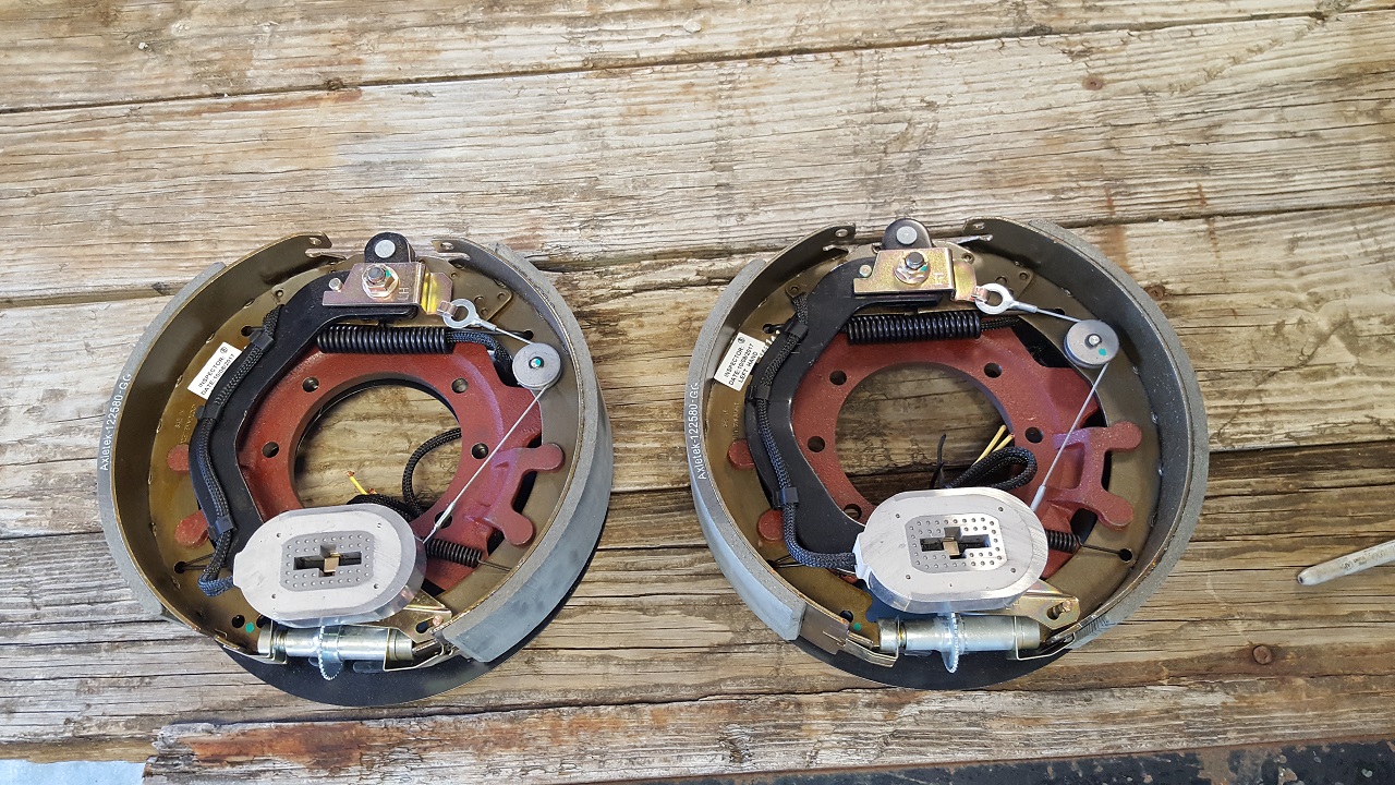

My 20K tandem trailer didn't have enough brake to suit me. A couple of the wheels had seeped some oil at some time. I finally decided to rebuild them. I bought complete units for each wheel. Unwired the magnets, unbolted the backing plate and swapped everything. I can't remember exactly but I think it was under $650 for all four wheels. On gravel I can slide all four sets with a 10K lb load. Empty I run the controller on 2 and can still slide them on gravel. Love my brakes now!!!
While I was in there I changed out my hub oil to hub grease. No more oil seepage on my new brakes.
Also in last pic you can see I had plenty of brake shoe left. They just weren't effective anymore. Did I mention I love my brakes now!!! :)
