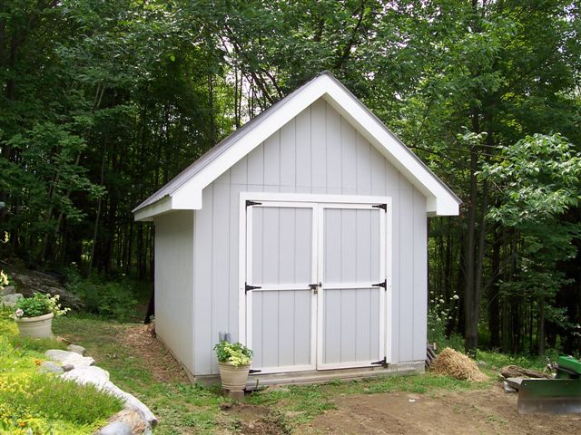

I had a local company come in (pre-tractor days), level an area, compact the sand, and pour a "floating" slab. I had them space anchors for the base plates, 16" on center. When the cement was cured, my wife and I built there rest of the shed (10'x12' footprint with 12/12 pitch roof (I live in VT and get significant snow load). I built my own rafters (simple design) and did all the work except the standing seam roof. I only had to get one good sized friend in for 1 day to set the walls, strap up the rafters, then sheet the roof while squaring up the rafters. The doors actually took more time than anything else. I'll try to find a pic.
Note, sideing is T1-11. Not my favorite choice but within the budget when built. The shed is now 4 yr.'s old and with all that "extra room", it was filled to the brim the 1st year /forums/images/graemlins/frown.gif.
Tom
Tom

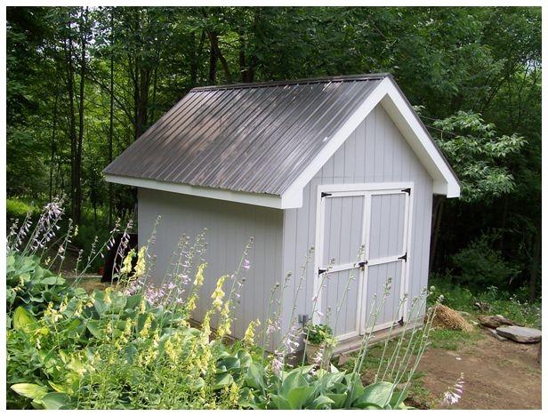

Sorry, having trouble posting this second pic. This is a "side" view from above. So far (4 years now), no problems with 4' snow loads. The T1-11 was not my 1st choice but it fit the budget.
Tom

Tom, Great pics. I like the Hosta garden as well. That is exactly what I'm looking for. I have about 4 sheets of T-111 left over from a project. Lots of 2x4's as well. just need some plans on how to cut. The Costco plans look pretty good.

Thanks. If I had any plans, I'd scan them and post but, I really built the shed from some quick sketches. One thing I did that doesn't really show in the pic's is a 2' overhang in the back. "Eventually" I will build a tool storage cabinet under it for hanging up all the tall tools like pole saw, shovels, etc... For now I have a cartopper hung back there off a pulley.
If you like the Costco plans, I'd go with them. I don't think I kept a good record of the $'s I put into the shed. I probably could have saved $'s by using a kit but my wife and I had a good time working on it together. The hosta garden was our 1st garden project, again it was pre-tractor. There are two more gardens above that, and one out front. The hosta's were supposed to be thinned and many transplanted but will have to wait as they got away from us this year.
