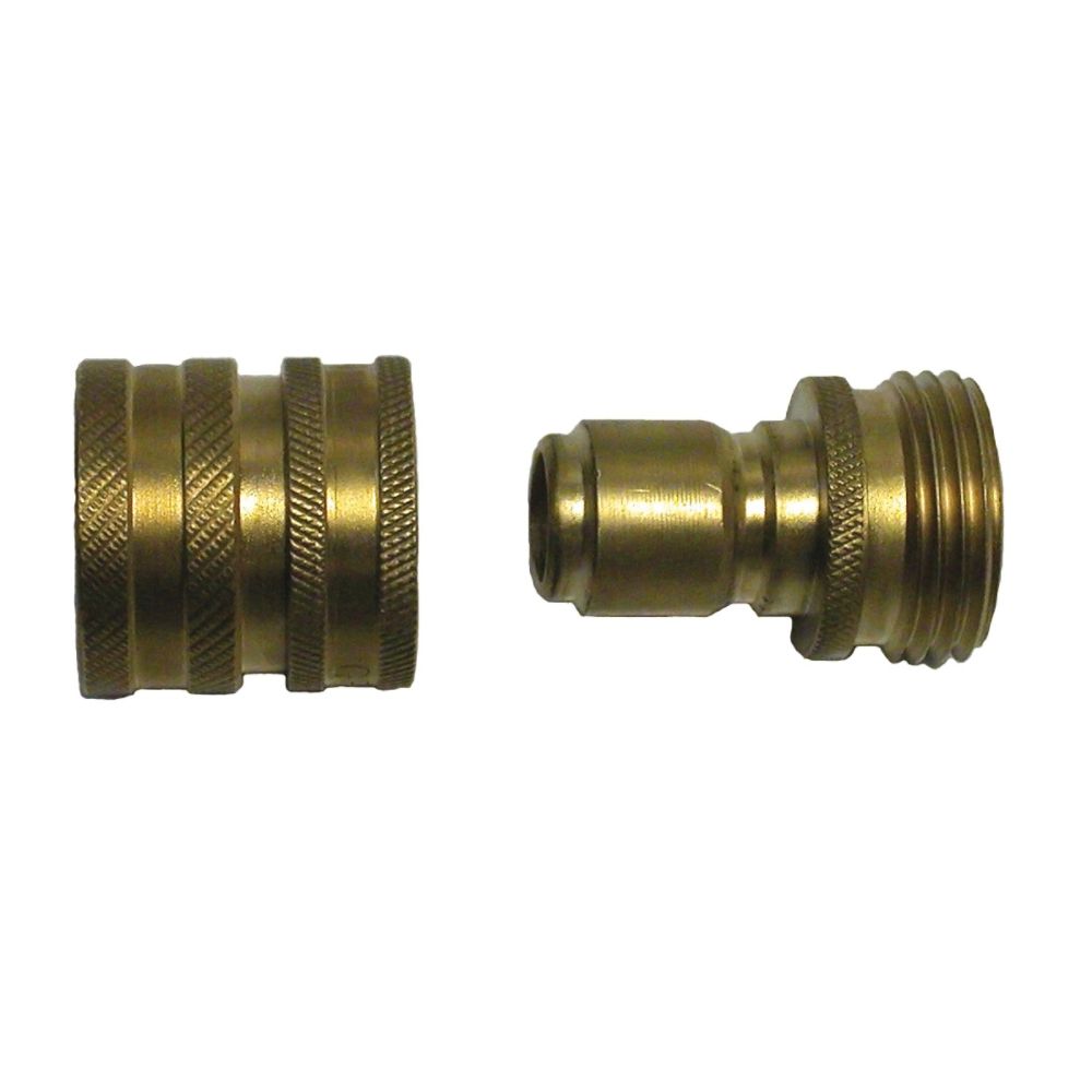

Install something like this in the tank
Get a hose quick connect to go with it.
07175187000
It may restrict the flow a little, but the convenience may be worth it.

yep... float valve and qd....

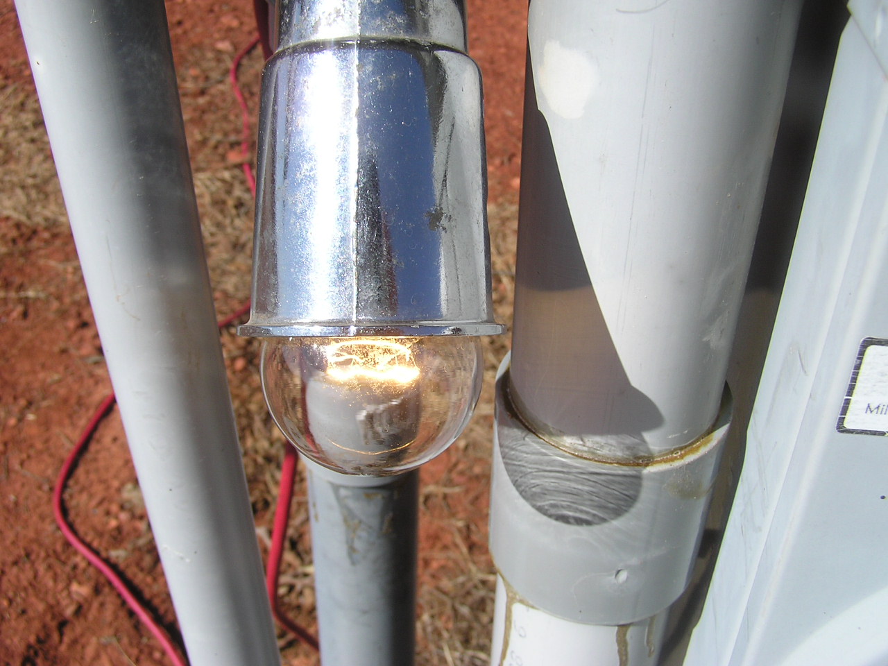

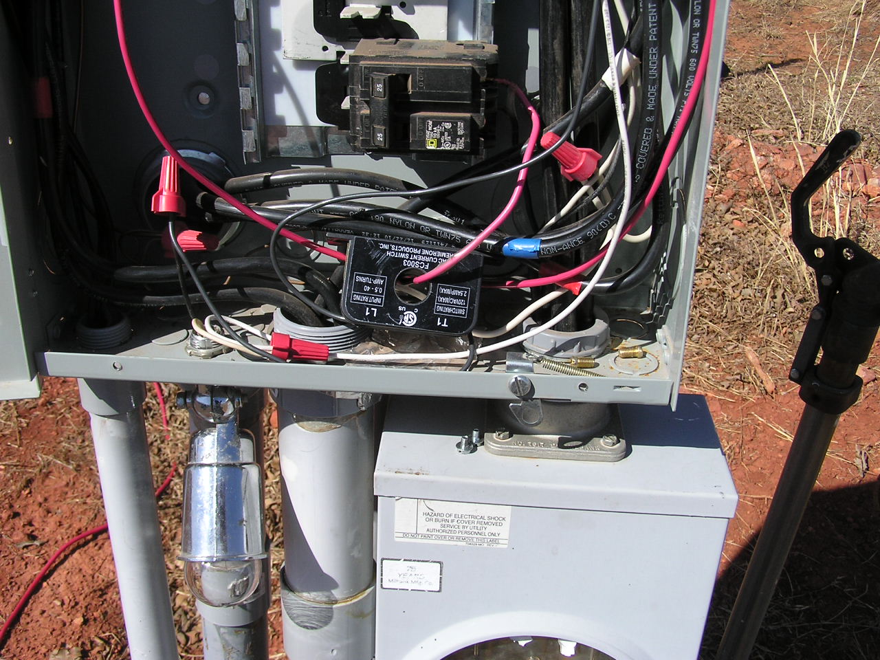

BSVLY No problem, sometimes it is best to ask to get the simple answers as NEW things are made all time and no one can keep up with them all. I didn't know about them 16 months ago & was looking for something to automatically cut off the WELL PUMP if it runs too long. I lost a pump because the Amish Concrete crew's 9 yr old helper turned on the hose set the handle lock & cleaned up tools & played in the water. it ran well dry (Not un-common for my well) and it was after VERY DRY summer.
Now if my pump runs for more than 8~12 min straight it will "lock out" requiring a manual reset. I didn't find one to buy cheaply enough (240VAC single phase no neutral) so I built my own 240VAC panel system that now takes all the PUMP LOAD off the pressure switch & runs on the 240VAC.
