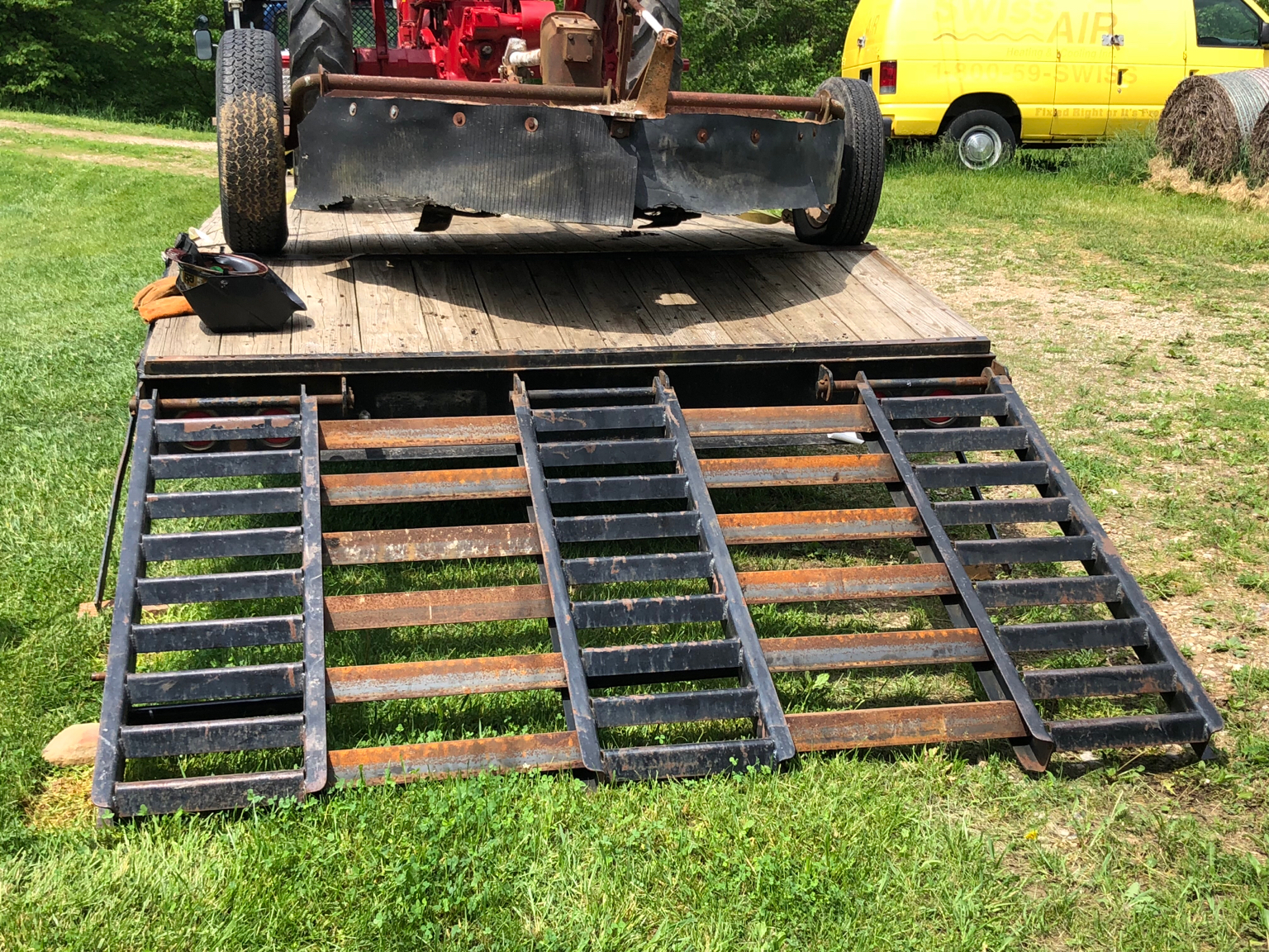

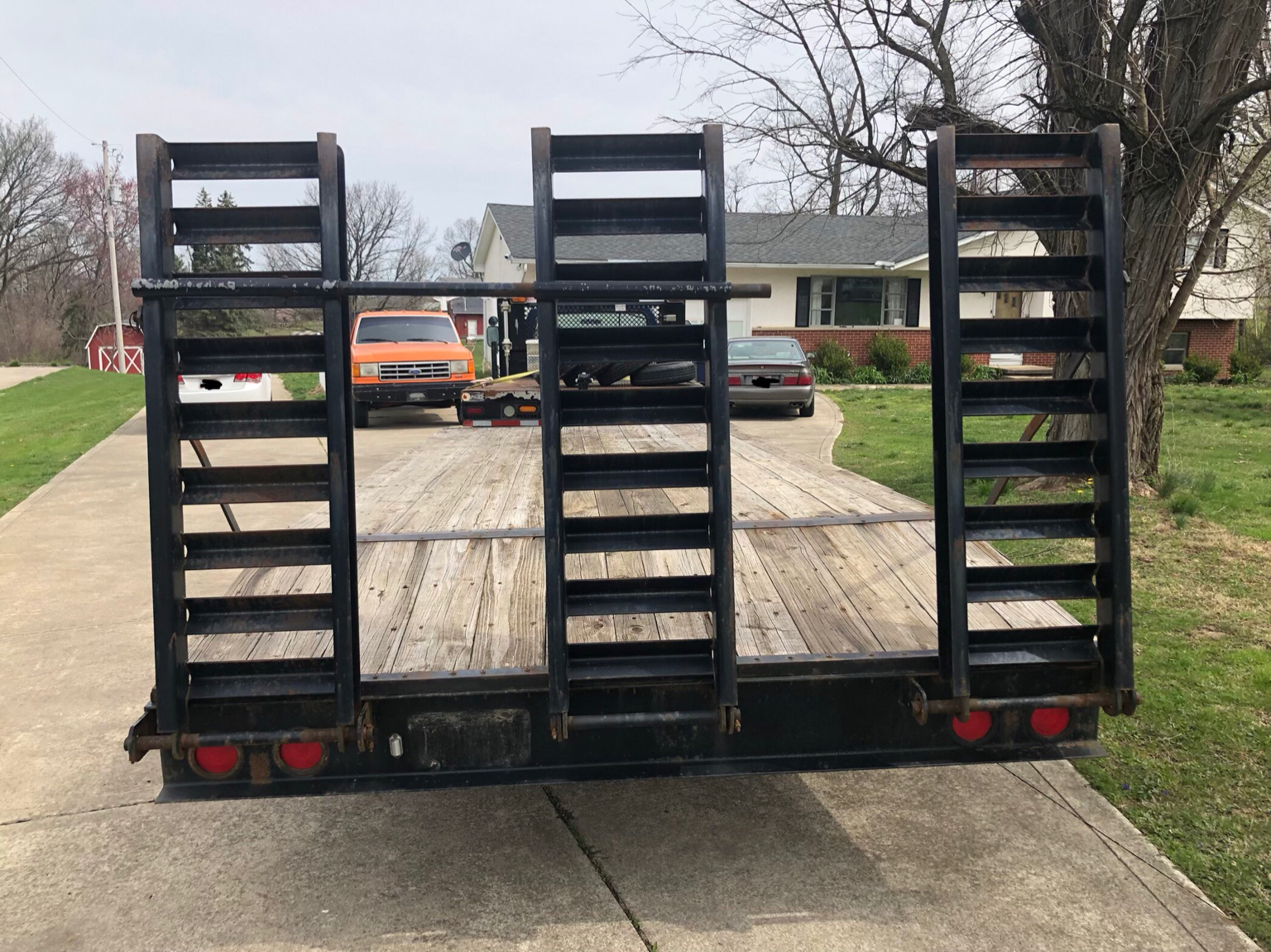

I bought a 20ft deck over trailer to replace my 16ft with rails.
The 20ft deck over came with 3 ramps on the rear, I was told it was built for hauling tricycle trailers. The ramps don’t adjust to a useful enough width for most things so I decided to have a buddy come over and make it one gate. Here’s before and after.
Next I need to have him build feet on the ramp so it doesn’t lift the rear of the truck so much and want to push the truck while loading.
How far off the ground should the feet be? So it doesn’t pinch and get stuck.

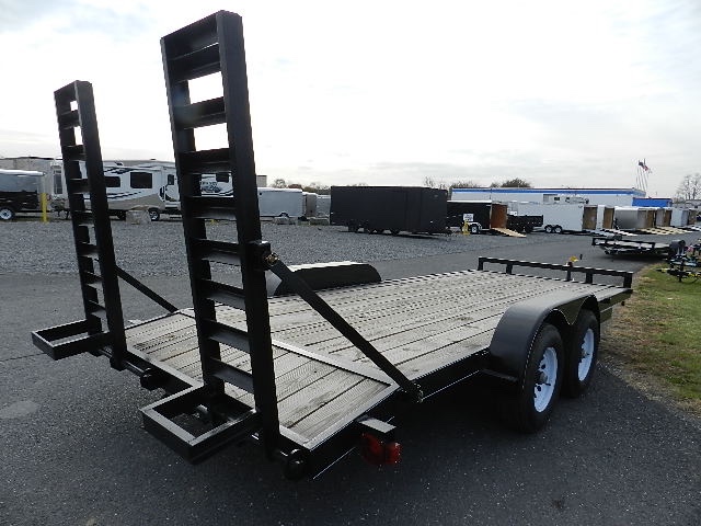

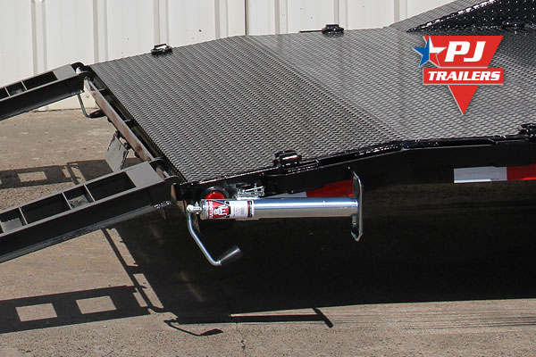

I will prob have him do something like this.
I would like this but idk how much I want to invest in ramps lol IMG_0738.JPG

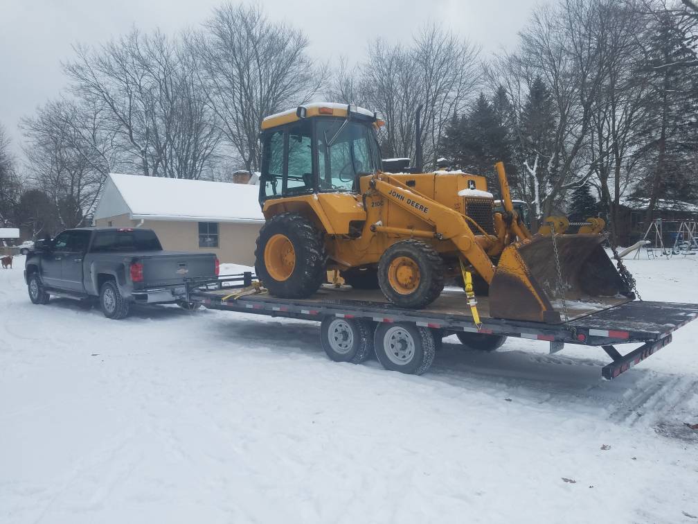

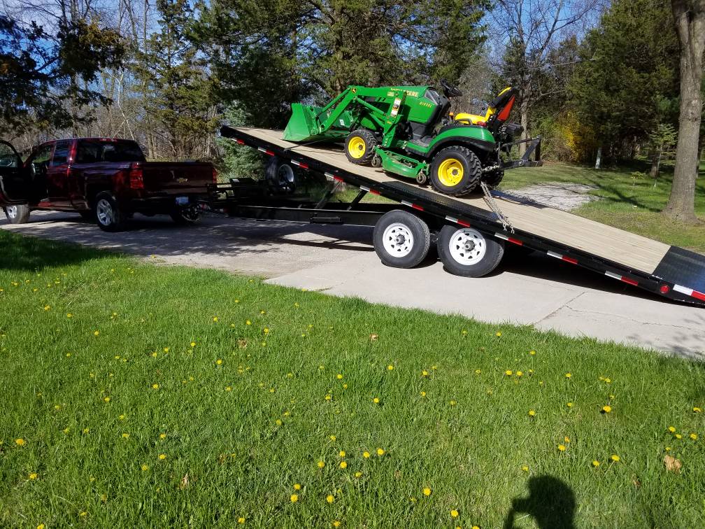

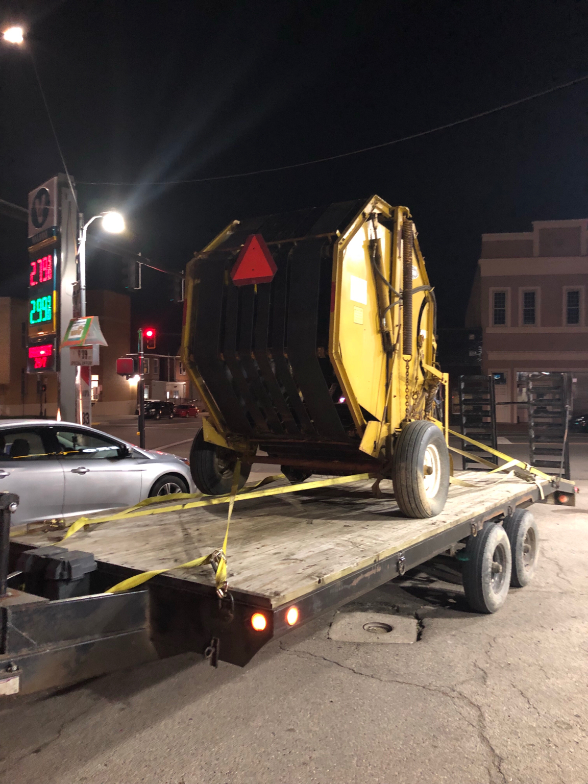

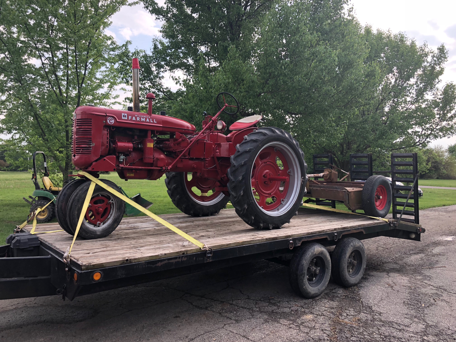

Random pics of trailer in use.

With the trailer sitting level the feet should contact the ground gently.
Do you have springs on that ramp? It must be heavy as ****
Ahh. Read your post. Usually the spring ramps have a bigger diameter tube the ramps swing on
   / Need some measurements on Ramps for trailer
I don’t have springs yet, I will be adding them soon, currently it’s too heavy for one person to easily lift, I prob could but don’t want to by myself. I will be adding springs and lots of them.
I was thinking like 4-6in above the ground on the feet.

I’d go for 3-4 inches off the ground on level ground. It’s not the end of the world to have to back up to get the ramps down if the supply was too long. I honestly don’t see the spring assist working at least with the standard design. The mega ramps on my Big Tex run out of spring assist and half way up and it’s about all I want to get them the rest of the way up. I’d want hydraulic or something powered on that ramp.

I’ve used a trailer with those. Even my old trailer with support post that were too long and required backing up and pulling forward the fold down/up the ramps was less hassle.

Only prob with the feet is it makes the trailer another 2ft or so longer because the feet stick out so far.
I kinda like the idea of the jacks on the sides but that would be a bit time consuming to crank them both down so idk lol.
