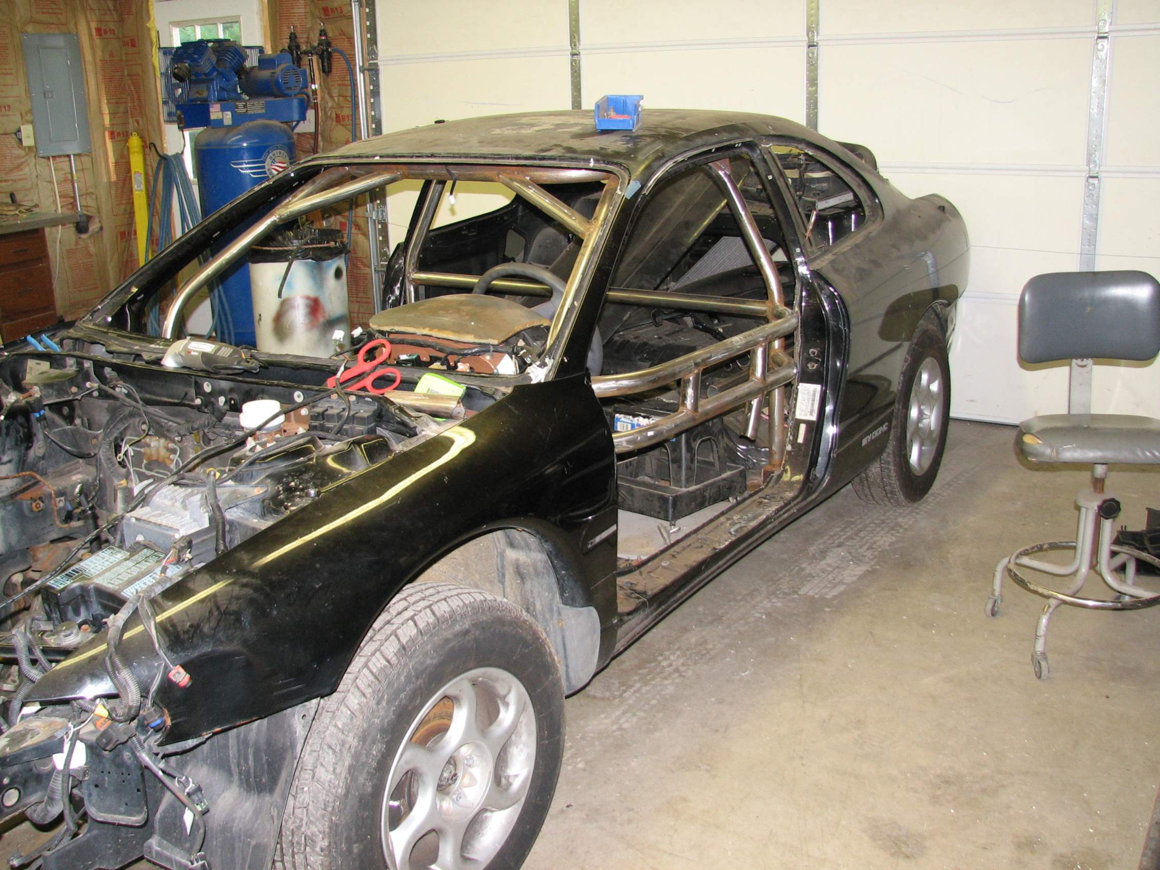

Here is our first tubing job. It is still in process.
