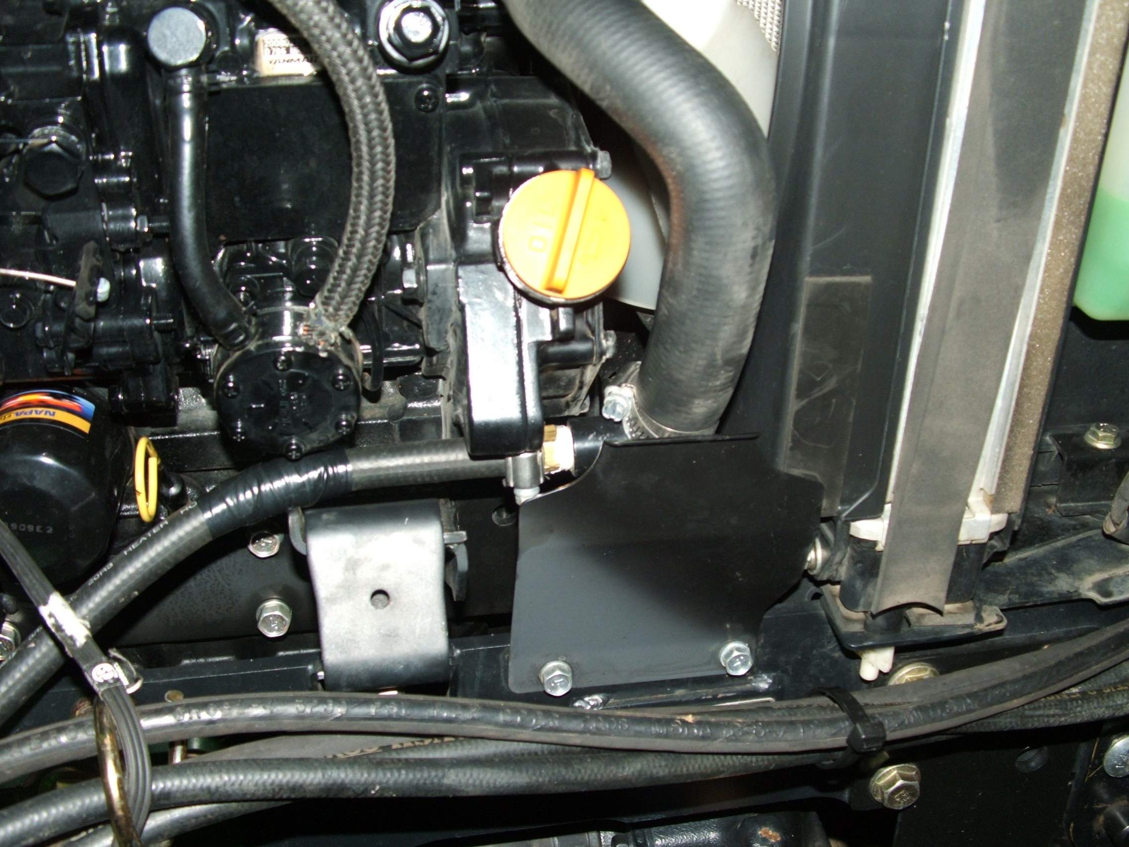

Have you look also at the possibility of the radiator drain plug? Its on the right hand bottom of your radiator, white plastic wing nut style. You can partially see it in this picture just below the rad and above the hoses. Could be a little loose and let a few drip once in a while.:thumbsup:
