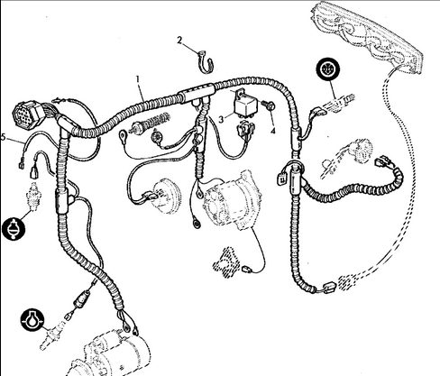

My 2155 electronic temp guage is not accurate. (always says its overheating and its not) I tried a new sending unit and no luck.
I have aprox 3.5 volts at my wire when I check voltage at sending unit. when I disconnect wire from sensor (open circuit) guage reads all the way cold, when I ground circuit it reads all the way hot. which leads me to believe sending unit is bad. So I replaced. And no luck so I think in my guage their is a short at a certain temp the guage shorts to ground, causing needle to go hot.
So Instead of replacing a very expensive guage I thought I would add an aftermarket one. Do they make a add-on electronic guage? Or should I just get a capsile type? How accurate are they? where do I get either?:confused:

more than likely its the wiring harness under your left foot under foot plate. there is a wire in the harness that is loose. I replaced that connector after replacing everything and have never had anymore issues. My gauge use to flicker back and forth before I fixed it.
   / Need some help on adding a temp guage to my 2155 #5
Have gauge cluster ground connections been cleaned & tightened??
I think there's no wires under left foot plate on a JD 2155 that has anything to do with engine temp gauge. Photo showing engine coolant sensor wiring to bulkhead on firewall then wiring goes to gauge in dash.
