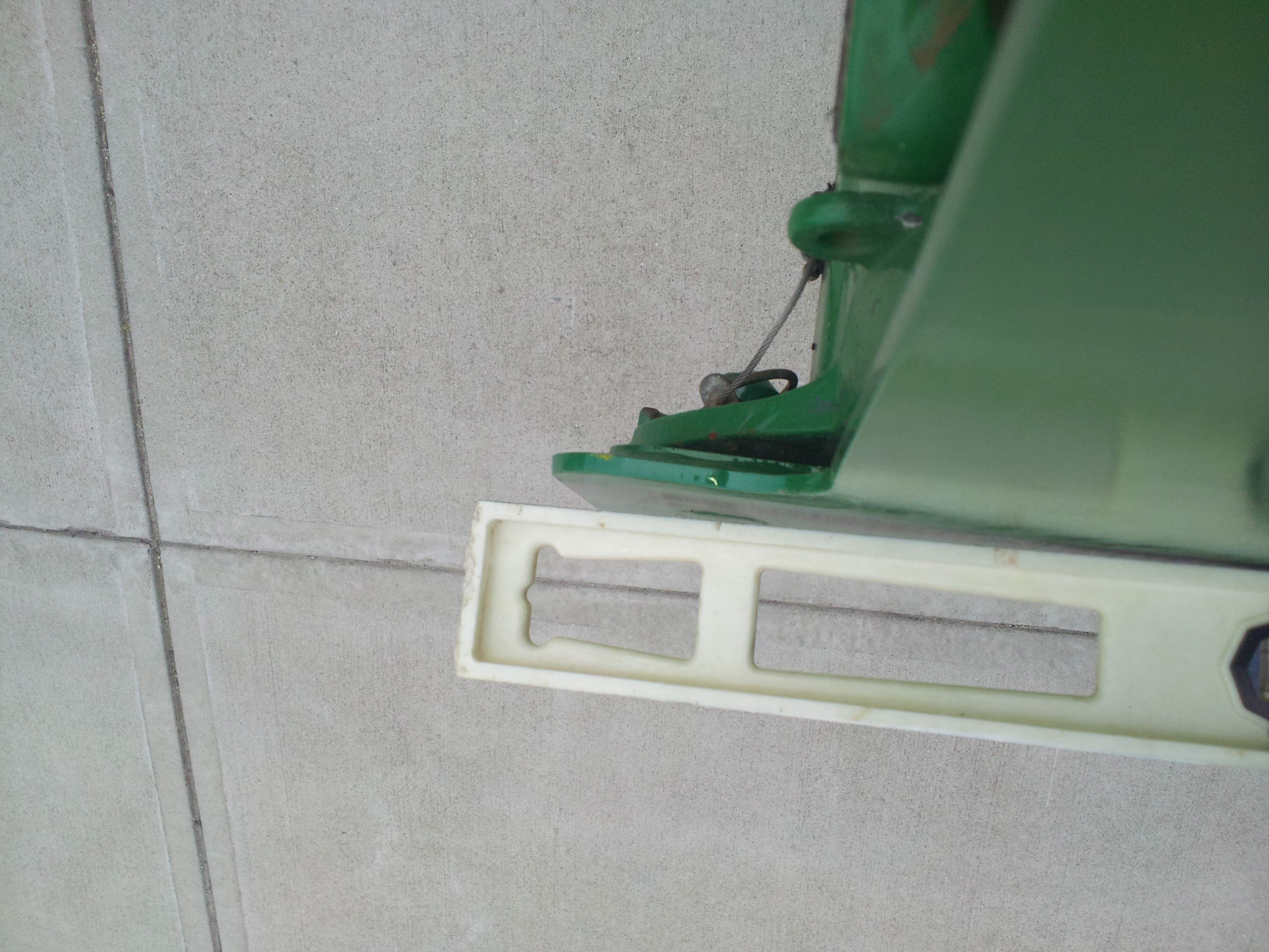

I have a 300CX FEL on my tractor. It uses the Deere Quick-Attach system. I thought it would be easier to buy a "blank" mounting plate that already had the necessary hardware in place to use as a starting point rather than to try and fab that up myself. So, I bought a blank mounting plate from (an unnamed vendor well known on TBN). The plate is 1/4" thick steel. I was initially happy with it as it seemed to fit OK (pins lined up, etc.) but upon closer examination I ran into some things that have me kind of concerned. That's where you guys come in! :thumbsup:

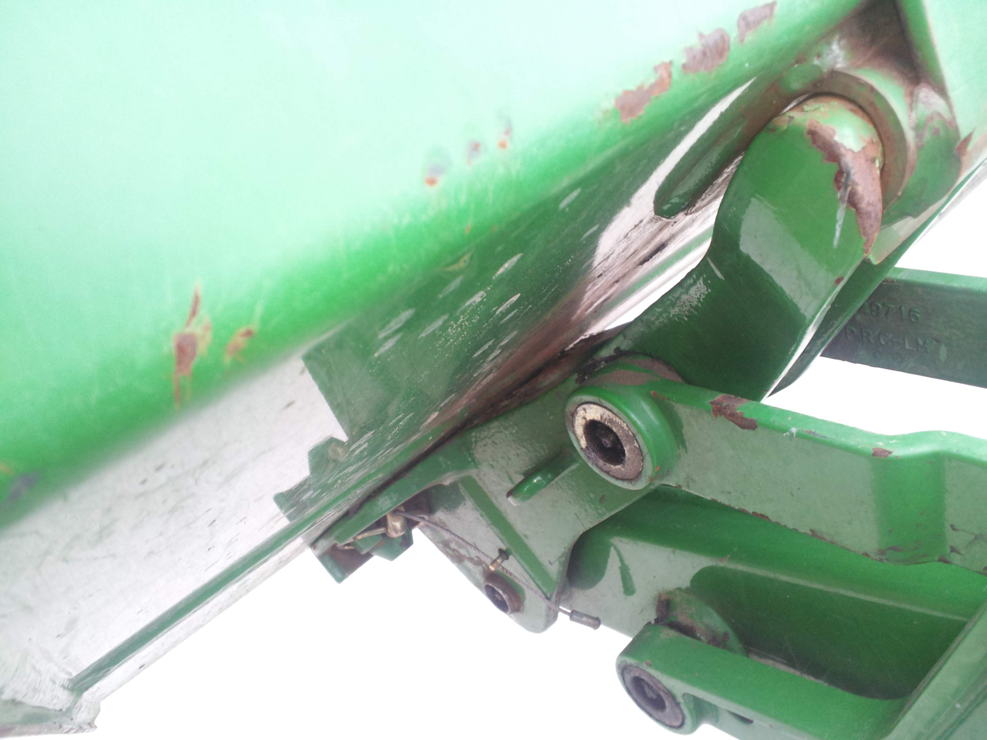

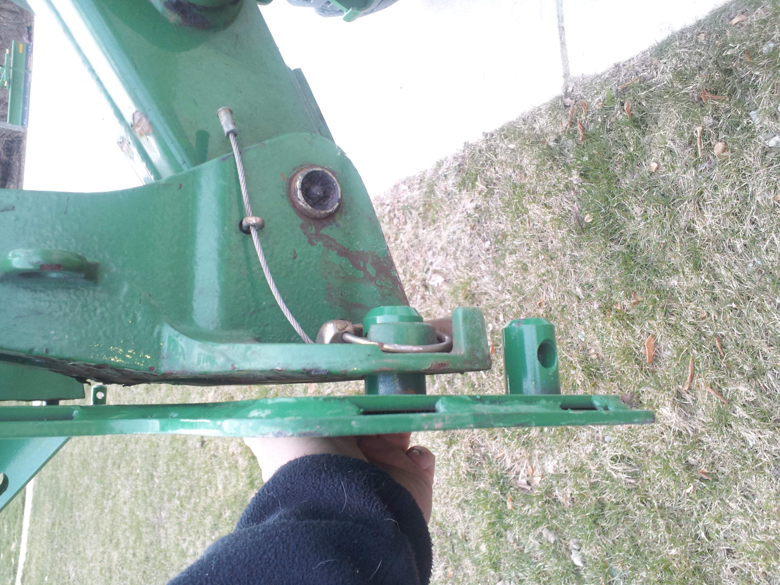

The first thing that I noticed was a lot of "back and forth slop" on the bottom pins. As you can see from the picture, there's well over a half inch of "slop" from having the retaining pin hole drilled too far back.
My concern with this is that the implement will bang back and forth as I go from pushing to back dragging to dislodge brush. I'm afraid that will put stress on the "ears" that are welded to the FEL arms. Am I wrong in my assumption? This might be able to be solved by using some washers on the pins to keep that from happening though.

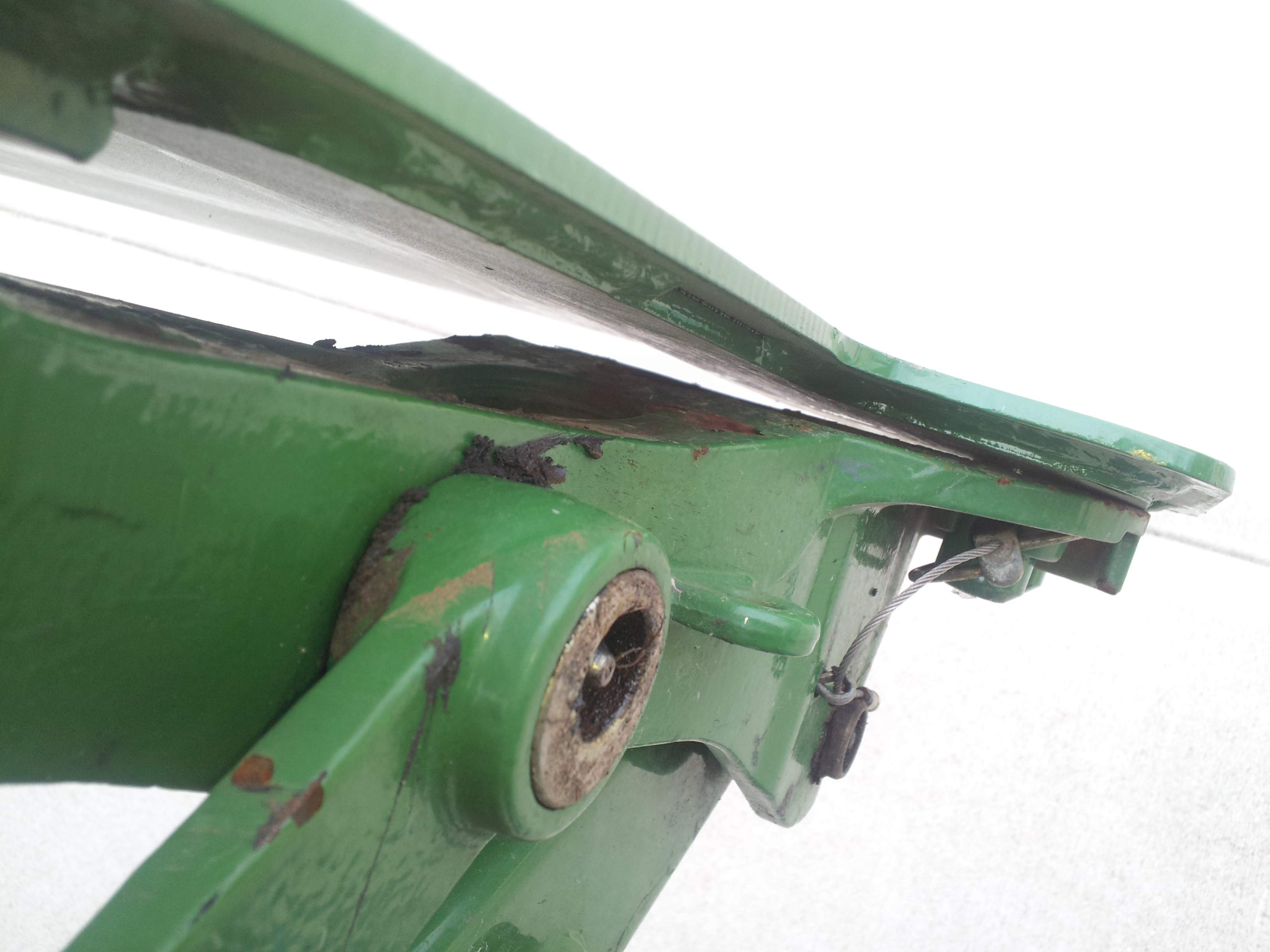

The next thing I noticed was "daylight" where the back of the plate was supposed to meet up with the FEL mounting area.
This is as tight as the two surfaces can come together. There is about 1/4" of space where it should be flush. Again, my concern are the "ears" on the FEL where the pins go through to attach to the loader. The plate should be resting flush against the FEL mounting area. I will be putting a lot of pressure on the mounting plate while pushing and uprooting brush. I don't think those "ears" are designed for that amount of stress. Am I wrong?

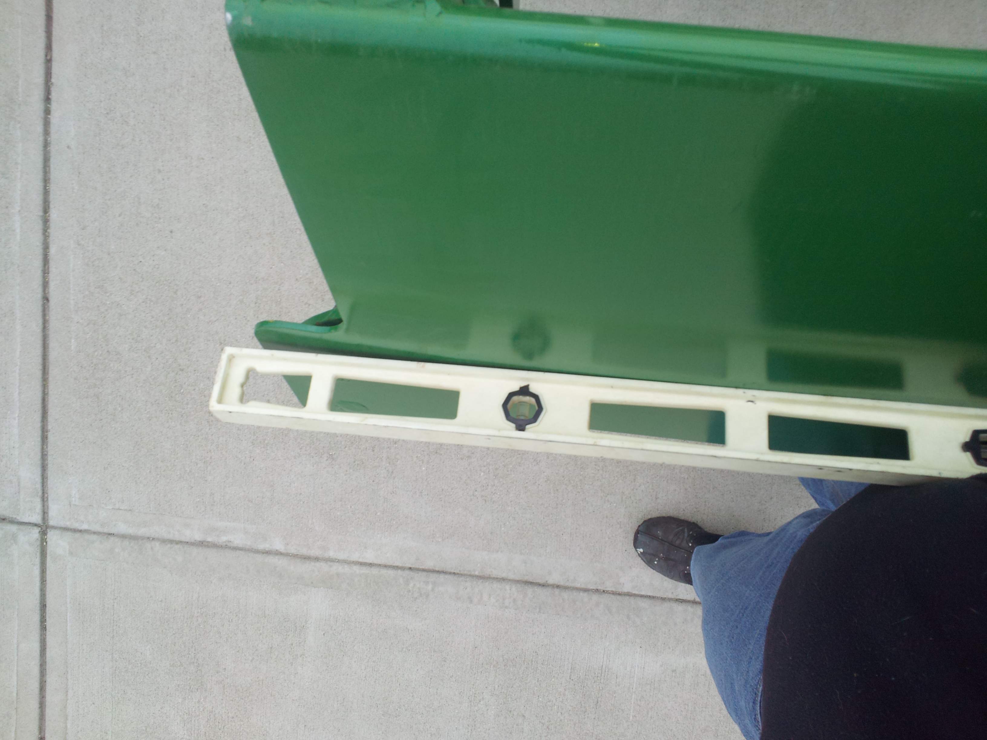

After looking at that space, I wondered just how flat that the blank mounting plate was. As you can see from the next pics - it ain't very flat!! :confused2:
You can see from the second pic, that the plate starts to bend around 11" in from the end of my straight-edge (a 4' level). The first pic shows the 1/4" that it's out at the end. The other side is identically bent. The plate itself is approximately 51" wide, so only 29" of the plate are actually flat! :mad: I'm planning on using 2" x 4" x 1/4" tubing for the frame on this tool. Is it possible that the tubing could be clamped and welded against the plate to straighten it out? Keep in mind that I don't have any kind of press to try and do this, so I'd have to use big C-clamps to hold it together until it's welded. Would it even be possible to do without a press of some sort? I'm concerned about 2 things with this approach. First, would the stress of the bent plate cause problems to the tubing welded up to it? Second, if I straighten out that plate, then the mounting pins will end up a bit too wide so I'm going to have to grind part of them off.

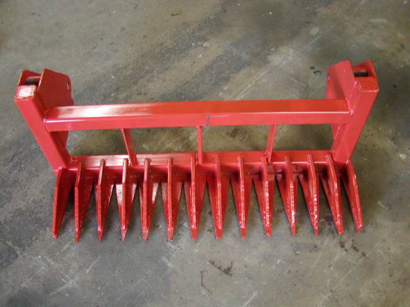

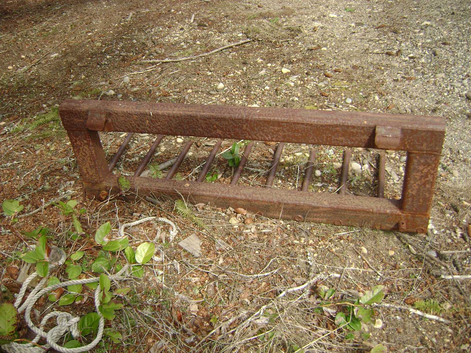

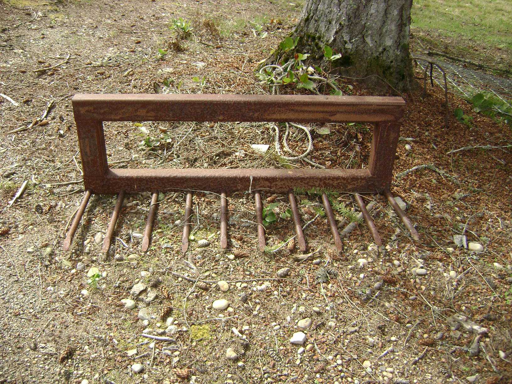

I'd return that plate! And build my own root fork. I through this one together out of scrap laying around. I have the 420 front end loader, which looks like pretty much the same mounting as yours.

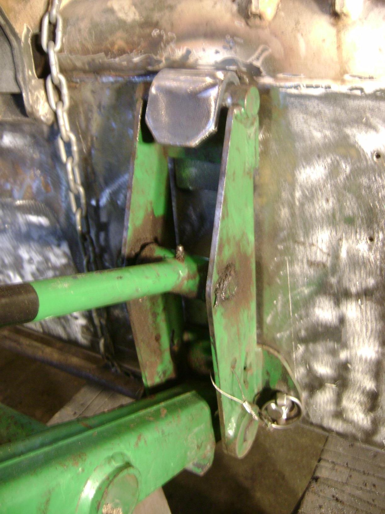

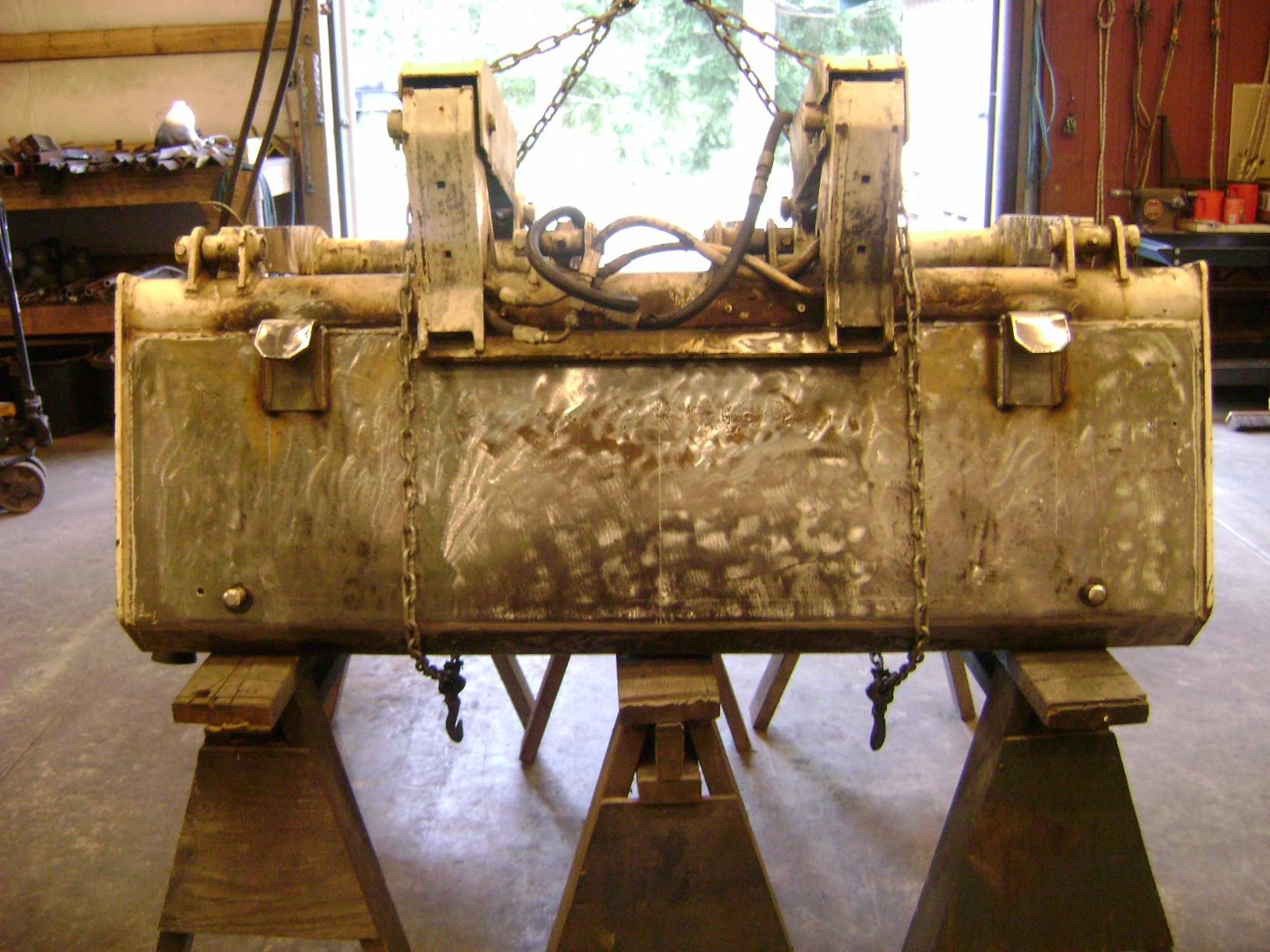

Here are some better pictures of a grapple I converted to fit my tractor.

JD sells those "quick hitch" parts. 2 cast steel top hook's and the 2 bottom pins. At least they did about 8 years ago for my 540? loader.

If they won't take the plate back, post more pictures of it. But from what I can see in the pictures you already posted it looks like it's laminated. So heat shrinking it back in line may be out of the question. You might have to block the plate up, and drive your tractor on it.
Far as the pin holes being in the wrong place. Grind the plug welds off, push them in further, and re-weld.

I built a hay spear frame for my JD loader. Basically the fabricated upper link looks like what Shield Arc did in post 3. Bottom link is just some round stock with a point ground on it and a hole drilled for the pin.
The lower pins only get worked when you are back dragging. If it bugs you and you want to do it on the cheap with no welding, just make a few washers out of 1/4" stock and hole saw or two. Put the washers between your frame and the lynch pins. You could try squeezing the plate with clamps and your 2x4 stock to see if it will bend back. Understanding why it bent is also good to know. I have bent stuff by welding too long of a bead at one time on stock that would bend. Typically welding newbie mistake and I am a newbie.
   / Need some building advice #10
Any reputable place would take back a warped or otherwise defective plate like that. You paid good money for it. Why should you have to have spend of a bunch of time and more money trying to fix something that is defective? It's not like you used and abused it and want it replaced. All you did is see how (badly) it fit on your loader. You should get a full refund including shipping. That plate should have never been sent out the door.:muttering:
