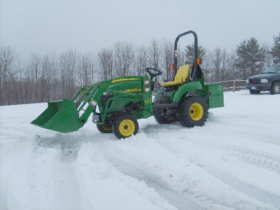

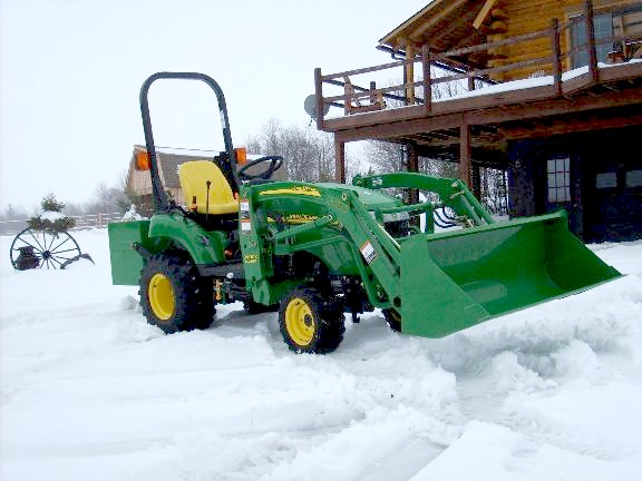

So far I have 10 hours on the machine. I have loaded and moved 8 small pickup truck loads of horse manure. Cleaned out the barnyard with the loader. Mowed some of the field with the rotary cutter just to try it out. Plowed and moved snow from our resent storm Monday 4/16/07 (pictures attached). I have not been able to mow with the mmm yet. So far I am impressed with the tractor.
