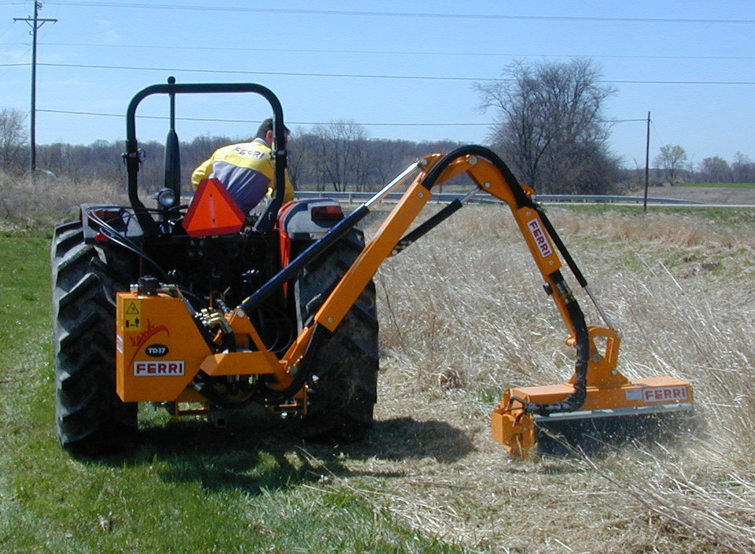

I'd personally be looking for a way to stay off the soft bank on any size machine with it leading to water... I'd spend the big money on a tool to keep me up off that bank (RMB1445), then pick up some old heavy iron on the cheap and build a protective cage on the right side and go to work. I have it on good authority from a couple different dealers and reps at BushHog their ratings are more weight dependent than HP. As long as you have the weight you don't need the full recommended power to still operate the unit at its full capacity.
Another model, and dummy should have some protection from flying stuff, but you get the idea:
Understood. I do plan on keeping far enough back to not only see a problem, but I usually walk the area ahead of time to try to see any potential problems.
