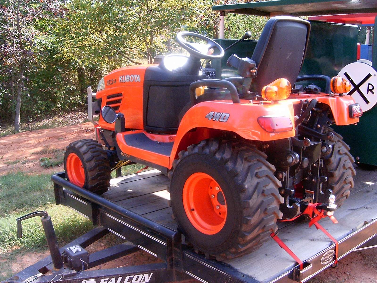

Looking to buy a brush hog. I want to contract pasture and large lawn jobs with my landscaper neighbor. Has anyone had experience or opinion of an LMC Clipper 400? Dealer sells them for less than $600. Gonna pull it with my BX24. I've read people talk about KK mowers not being able to lift high enough to load on trailers without modification. Is that something I'll have to modify too? Anyone have pics or video? I've had my Kubota for over a year, contracted some driveway and ditch jobs, done a lot of landscaping in my own yard, cuts my grass, pulls my hay ride wagon, and my 30' trackless train when my little tractor can't handle the hills.

Bush hogs generally don't give a finish cut on lawns, especially with dull blades although some will give a decent cut. But, I have to ask the question since you have a MMM, why not use that for the big lawn jobs?? I am pretty sure it will cut the same yard faster than with a 4ft bush hog. Also, a 4ft bush hog will take a bit longer to cut same size pastures than a 5ft or 6ft will so keep that in mind when you quote a job. As for loading, it really depends on high the trailer deck is off the ground, and how long your ramps are as to whether or not you will need to modify anything.

I cut a neighbors yard last summer, 2-4 foot grass, 2 acres. Took 4 passes, once with mmm up high as it would go, waited two days, cut a little lower, wait, cut at 4" twice. It looked good after the last time but I could have done it faster with the first pass with a rotary. There was so much hay I could have bailed it. But yes you're right, I will use the mmm on lawns, rotary on pastures. The reason I inquired about the lifting height is in another one of these threads somebody was talking about using the same tractor with a 48" King Kutter. They had to do some mods to the mounts to be able to get enough lift to operate it normally and to get it up a ramp onto the trailor. Don't know if this due to cutter or tractor. My trailer is about 19" high with 6' ramps.

Great tractor, Old Max. I'm not familiar with that one but by the looks of the tires it probably bigger than my BX24. From what I've heard on the forums here, a 4 footer is going to be the safest load on this size tractor. One thing I have heard a lot is the BX24's 3PH doesn't lift a rear cutter very high without modifying the mounts of the mower. I don't know first hand I don't have any implements to attach to it yet. In fact it's still in the box. I've had it for over a year but you can still tell I'm a newbe. I do however find things to do with it though. These were taken today. That's Heinz driving it for me.

That is a nice tractor. It is a lot smaller than my Yanmar though. I would definitely not go any larger that a 4' cutter with it. You will probably need some weight on the front too.
