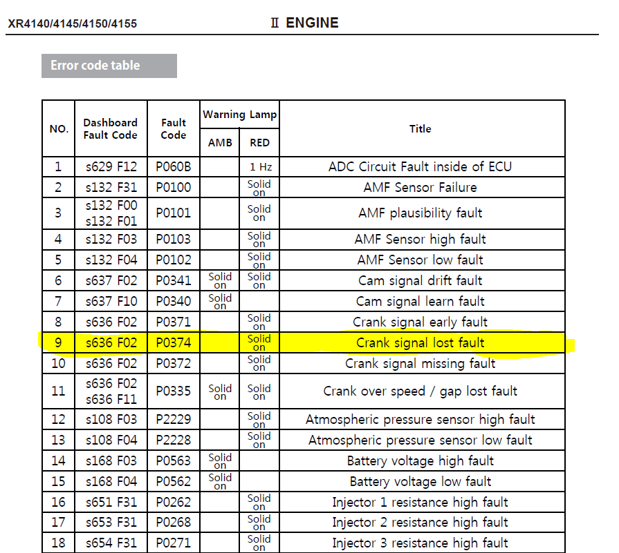

I had an error code pop up the other day when I was getting ready to remove the snow from my driveway. I have over 2 miles of driveway to keep clear. Error code F02 636 P0374.
The first dealership told me they would have there mechanic look it up and call me back.
Haven't heard back from them yet. The second dealership said there mechanic was not there. The person I was talking to looked up the code and told me to check the connections at the ECU and crankshaft sensor, I asked him where the crankshaft sensor was located, because I had already looked for it and did not locate it. I read on another thread that the error code was for the crankshaft sensor. he stated on the side of the engine near the fan, I asked him sitting in the drivers seat is it on the right side or the left side of the engine he told me he couldn't tell by the picture. I told him that is why I need a manual so I can have a better chance of fixing my tractor. He just told me that there is no manual available. So any help in finding a repair manual would be greatly appreciated.

PM me with your email and I will share the service manual with you via dropbox.
Here is what I found:
And the fix is several pages.
   / Need repair and parts manual for XR4140HC #4
Try this:
  • p0374- XR engine error code.pdf
