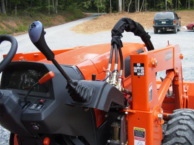

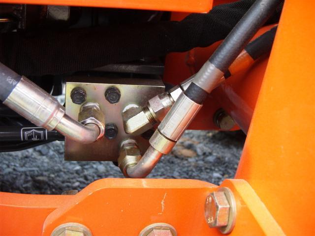

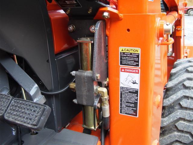

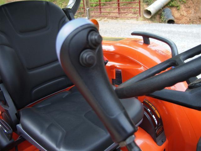

Don't settle for that set up. Talk to another dealer who has a better back ground in hydraulics. Mason Tractor in Blue Ridge, GA took the Kubota handle off my FEL and installed a handle from a Speedy Loader. Then they added a diverter valve at the rear FEL support and tied it in to the hydraulic system and that gives me push botton control of my grapple.
Pictures are attached to see the set up. If you need more info about Mason Tractor PM and I'll fill you in.

</font><font color="blue" class="small">( that gives me push button control of my grapple )</font>
Hi Charles - I must have skipped my Ginko Biloba this morning - could you please describe exactly what buttons get pushed to open and close the grapple, then go back to the regular loader function, and what if any loader function (raise, curl) gets "diverted" when you're using the grapple?
   / Need remote advice on L5030 w Cab #10
If you look at the picture that I call picture #2 you can see the two buttons on the front side of the FEL handle. The top button closes the grapple and the bottom button opens it. These are electric switches that control the electric diverter valve in picture #3. They are connected into the main oil supply for the FEL so it doesn't divert any function it just takes from the available oil supply. So if I'm raising the boom and push one of the buttoms the oil is split between boom up and grapple open and both functions slow down. In my last picture you can see where the lines tie into the tractor. Now when I remove my FEL I have to disconnect the four factory lines plus the two new remote lines they added. It works great it's just a litte hard to show all the plumbing with pictures.
Hope that helps.
