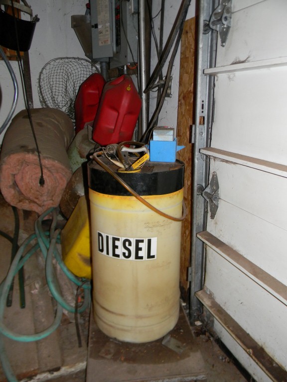

Yes, I have both. The electric pump (1st one I listed) bought from Advance Auto that I power with an spare trailer brake battery. As a regular buyer at Advance I get discount coupons and / or manager discount so my price was under $40. The pump uses 3/8" ID hose.
The manual pump I use for transferring hydraulic oil or any other type oil or fluid. I never used the manual pump for fuel but guess it work transfer fuel easier than oil.
