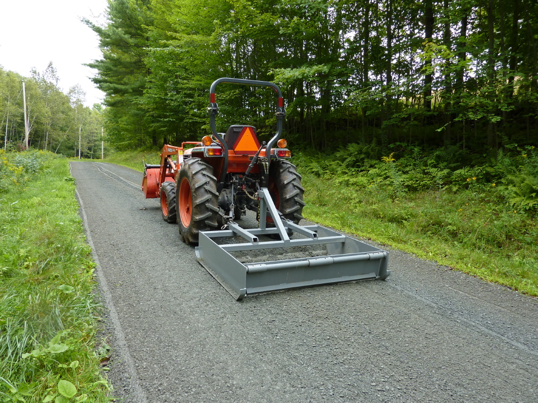

I have a mile of road to maintain. I did it for 10 years with just a rear blade. Last year I built a grading scraper. It has made a huge difference in my ability to efficiently maintain a good road surface. I still use the rear blade to reset the road contours where necessary after mud season but the grading scraper is my "go to" tool for surface maintenance. Mine has fixed blades. Unlike the adjustable LandPride unit Mpking has. I might add that I don't find the fixed blades a handicap.
When I add new gravel I tailgate spread the material then use the grading scraper to even it out. Then pack it with a full truck of gravel. Then I use the rear blade to set crowns and contours. Repack it. Then finally go over it with the grader and repack for the finished road.
Everybody has their favorite road tools and methods. But for my situation I consider both the rear blade and the grading scraper indispensible.
The road surface in the picture is five years old. The grading scraper remixes the top layer of gravel and makes it like new.

Gordon, your road looks great. Super nice.:thumbsup:
Did you go back to your rear blade to pull the excess on the edges back into the lane.??
   / Need Rear Blade Help #5
The only thing I used was the grader/scraper. The road material doesn't spread out to the sides because it is contained by the side panels. My blades are straight so it just mixes the gravel and lays it back down. There is no crown on that section. I have it flat and pitched slightly to the left so all the water goes to the low side. The right side ditch is very small because of ledge.
