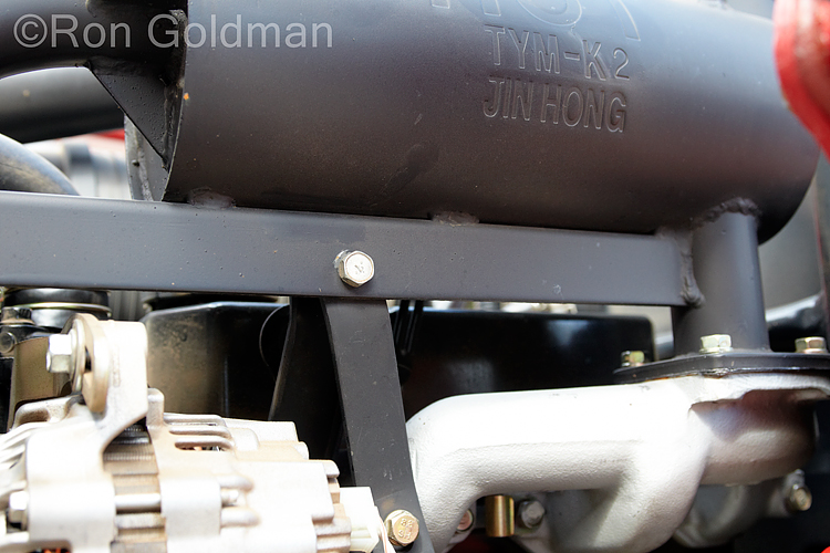

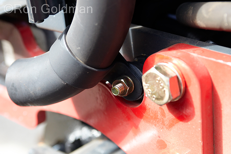

Can someone please take a picture of the lower mounting point of the redesigned K2 muffler? I am finally installing mine after my weld broke on the original muffler and I can't figure out how the lower part connects up.
I thought someone already posted a picture of the new muffler on the forum but I cannot find it.
Thanks a bunch.. in advance.

Mine was just a fork at the end instead of the hole. Used the same bolts and washers. Must be something really new if yours is not like that.
   / Need picture T273 re-designed muffler #6
Here are 2 images of the mounting points. There is the solid bar that runs along the bottom of the muffler and has a v shaped bracket that bolts on in two spots and then there is basically a pipe strap at the bottom of the exhaust pipe itself. That is it other than where it bolts to the manifold.

All done and yes they are the same. I have been running with the old muffler after I welded it for quite some time and finally the lower brace broke again. I had got the new muffler from my dealer around a year or so ago and no directions on installation. Not that it was very difficult, just that there was extra brace that I wasn't sure where went. The pictures were a huge help. Thanks again.
