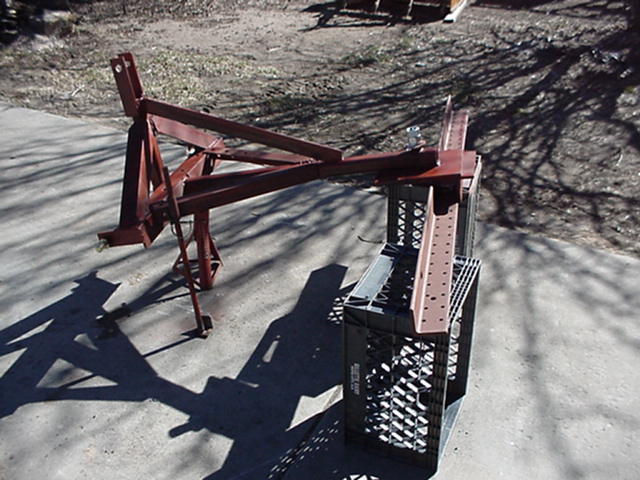

NEED PIC\'S OF GAUGE WHEELS
I'm building a 60 inch landscape rake, just getting it ready for paint and then put the tines on. I want to build the gauge wheels myself too, NEED SOME IDEAS(PIC'S)

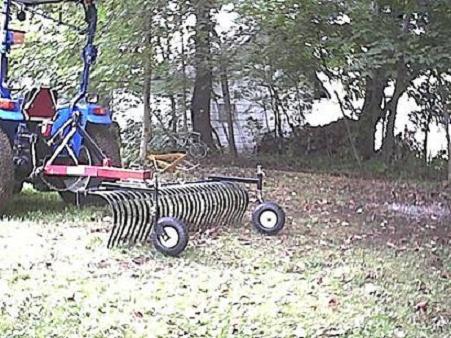

I see I'm not the only one to refuse to spend a lot of $$$ for something I can build. When I checked out wheel kits for my landscape rake I almost fell over with shock.
Went to Tractor Supply, bought two 10" wheels and fabricated the spindles out of scrap metal laying around. They rotate 360 degrees are height adjustable every 1 inch and I even put grease fittings. Its not pretty but for 25 bucks in materials and a hour labor I'm at least 150 ahead.

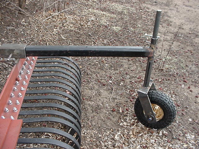

Re: NEED PIC\'S OF GAUGE WHEELS
still needs paint ,thought I would finish welding and the wheels before the last color goes on.( got to wait for the wife to do the painting) I don't paint
Pic 2
