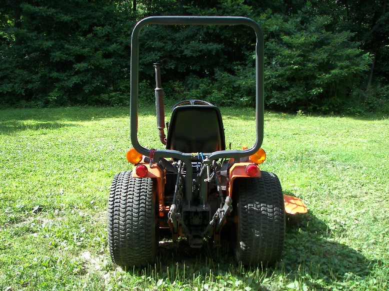

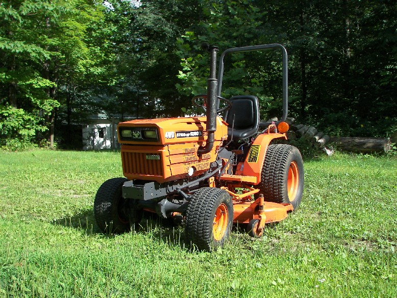

I would go for the heaviest one with the most hp. It will work better with the larger brush hog and work better for plowing. That being said 4wd makes the world of difference in these smaller machines. I believe Lefty has the machine and price you need. If you can't get him to part with it, I have an '85-'86 B7200 HST, 4wd, locking rear diff, 2 speed rear and mid pto, 3pt with position control, 17hp, speed set/hold, with a 60" MMM, with 834 Hrs for sale for $3950. I believe it weighs a little over 1300 lbs. I ran a 4' brush hog behinde it and never had a problem with HP. I would not connect the center link on the 3pt though. The cutter is too heavy to lift without front end weight. I don't know about running a 5'(I don't think I would even try the 6') it depends on the situation you are using it in. I actually tried my 4' a couple of times in my field and liked the way the 60" MMM worked better. I have always plowed snow with it using a 6' light duty blade. When it is angled it still covers the tractor tires. By the way the B7200 has adjustable width rear tires and mine has the optional extra big and wide turf tires. There has only been 1 time I was really haveing trouble plowing and that was when we got 14" of snow at one time a couple of years ago. Then the 6' blade was too big for the tractor and would push it sideways when angled or just couldn't push that much when straight. Chains probably would have helped.
Anyway, I realize I am far away, but I thought the info would still be helpful and let you know what else is out there. I don't know what your time frame is, but if you take some time and look around you should be able to find a good deal. Maybe not as good as Lefty, but there should be plenty out there. Especially with the current economic situation.
