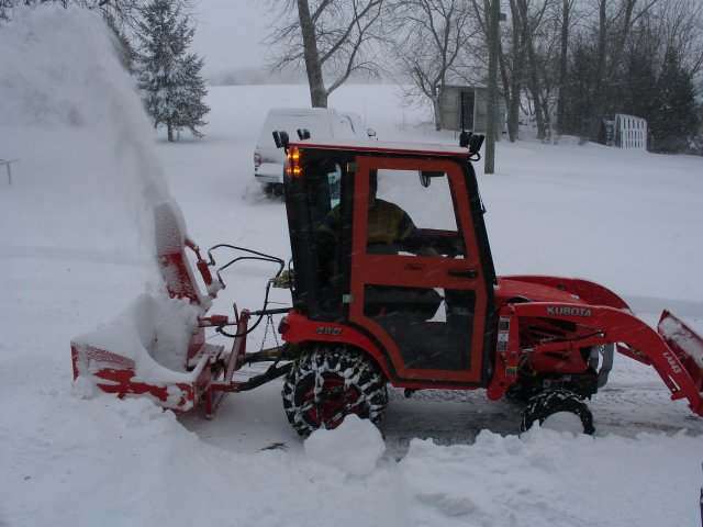

I always had a tractor with snowblower at the rear and never try one in front so I can't tell for sure but the set-up rear snowblower/FEL works very well. You can blow as well as pulling hard with FEL without the need to leave your seat to add or remove any attachments.
Skippy,
I noticed you have the same tractor I do. Can you tell me more about the model blower you have in the picture. Did you have to buy a conversion kit for the hydralic chute controls? Also, what is the make and model of your cab? Thanks.
