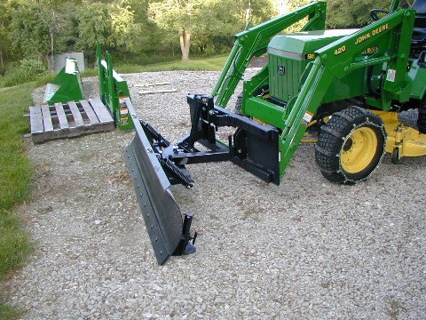

If I am picturing correctly what you are describing, the only way your plow / bucket is going to float, is if you manually put the loader into the float position. This is going to allow the loader arms to drop until something stops them by making contact with the ground. This something is going to be your A frame that is under your bucket. Kind of like a plow shoe.
My front plow is attached via a quick tach assembly. I find that I cannot run it in the float position because the loader arms will drop until the quick tach plate and locking pins hit the ground.
In the attached picture you can see how my plow arms are pinned into the quick tach plate and tower, pretty much like they would be attached under a pick up frame. There is enough play to allow the plow blade and A frame the ability to rise and fall and to ride independantly over the terrain.
When I plow, I just set the bucket dump angle so that my plow blade sits pretty much straight and then I drop the loader arms till I hear the usual plow blade being dropped sound and off I go.

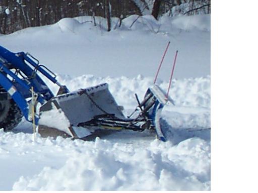

If I did not have the quick tach set up, I would have attached my plow to my buckwet using this method (picture attached)
I would suggest using a bracket like this verses putting the A frame under the bucket.

   / need opinions on front bucket snow plow, again ? #5
Setting it up more like this I think you would be able to set you loader into the float position. The loader and bucket will float as normal and the plow blade and A frame will also be able to float somewhat independantly of the loader.
Make sure you blades trip ability is still functional.

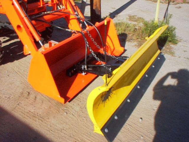

   / need opinions on front bucket snow plow, again ? #6
Here's my setup...simple, but works out fine.
When plowing, I set the bucket bottom level or just slightly angled to vary the pitch of the snow blade, but about 3-4" above the ground. The plow blade just rides the bumps and goes with the surface of the gravel drive.
I don't have a top mount on the plow. The chain is simply for transport..so the weight of the plow doesn't torque the bottom of the bucket. Its a lightweight " snowbear" plow so the total weight is about 225 pounds or so. A great advantage when pulling it off to stack snow with the bucket.

I really can't disagree with the leading edge mount. The issue would be making up some sort of clamping arrangement to mount the plow side to the lip. I'd worry more about that going side to side ( slipping along the edge ) and loosening from the abuse.
I had no real issue drilling the bucket bottom to bolt on a mount. The holes provide good drainage when moving wet material /forums/images/graemlins/grin.gif

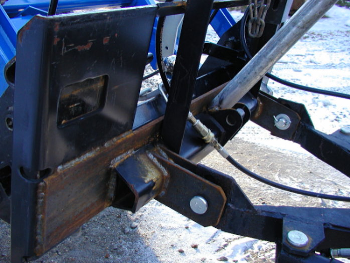

There are 2 considerations that have to be dealt with here. First, the blade needs to be able to float independently of the loader boom as others have pointed out. In addition, when the blade is in the normal operating position, the pivot for angling it must be perpendicular to the ground. If it is not perpendicular, when you angle the blade for side casting (either manually or hydraulically) one end of the blade will rise and the other will fall the same amount. Then the low end will gouge the road surface.
I have a JD front blade on the 420 loader on my 955. It connects to the Quick Tach on the loader boom and has its own float with respect to the connection on the boom. See attached photo. When operating you have to be careful to judge just how far to lower the boom each time to get it at the same place so that the blade pivot ends up perpendicular to the road.
