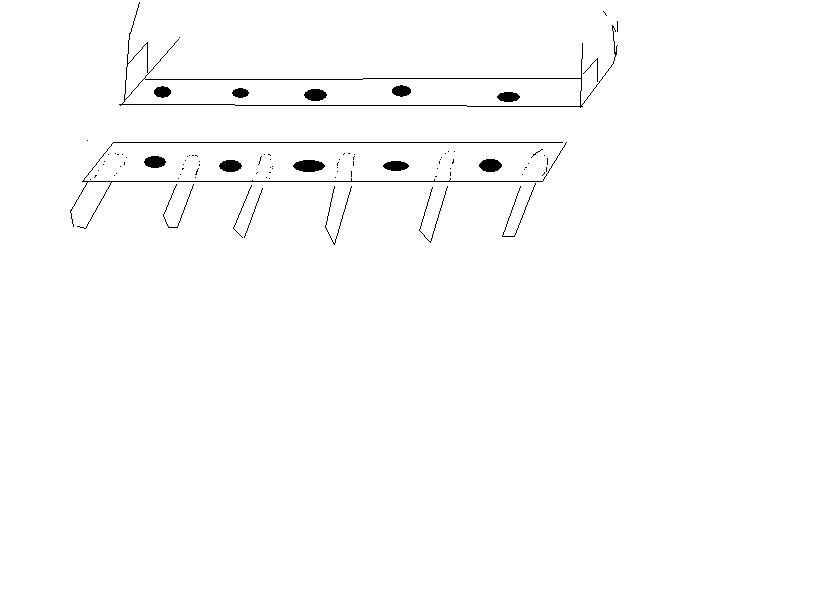

The bucket on my 57 hp tractor is 60" wide. It's just a basic bucket with a flat blade. I plan on moving/digging alot of earth, rocks, roots, limbs and other hard materials with it for the next few years.
I've looked at many toothbars, but want to build my own. Every toothbar I've seen bolts onto the 2 sides of a bucket (one bolt on each side), and they also have a lip or something like that on each tooth that hooks around the existing cutting edge of the bucket.
I was thinking about making a toothbar that would bolt on directly to the bottom of the bucket instead of the sides. The toothbar would still have a lip that would overlap the existing cutting edge, and the bolts would have a "backing plate" on the other side of the bucket that it's mounted to.
Does anyone think of anything wrong with this idea? I thought that the existing bucket might be a little weaker with the mounting holes that would have to be drilled into it, but I really doubt that I would be removing the toothbar once it's bolted on.

it might be nice to remove it easily so you can level or backblade sometimes without the teeth in the way
   / Need opinions on building a FEL toothbar #3
Lots of bolts to remove and they are in a high wear zone. Are you saying it will hook over the cutting edge for support? The way you have it drawn the bolts take all of the stress. A detail sketch would help.
Overall it can probably work but I would consider it not as good as the conventional method.
