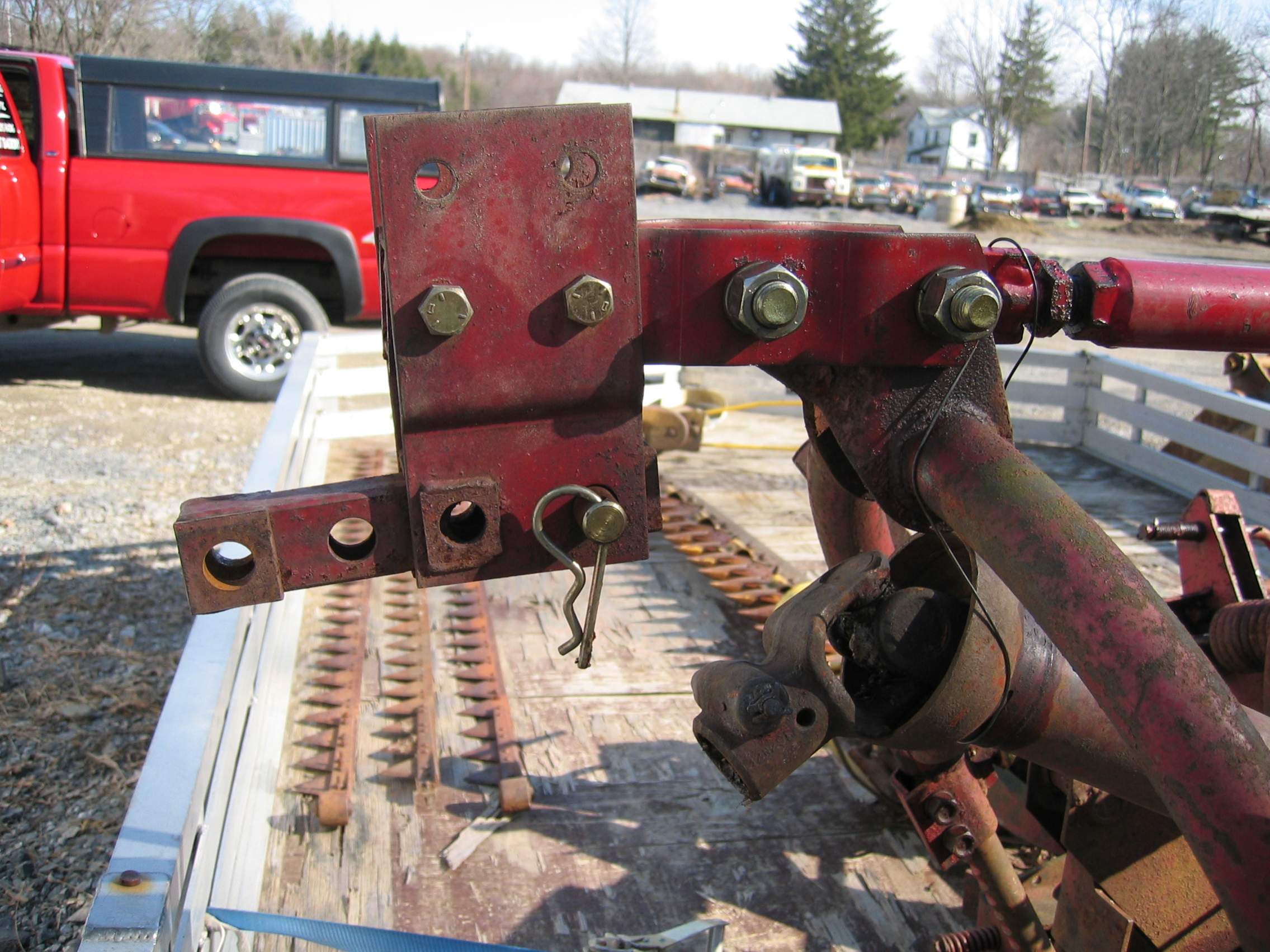

Is there a down loadable one available?? I picked up this mower off "craigs list" for $850. Came with three sets of knives and a box full of spare parts. But now I need to figure out how to set it up for my Ford 2000.
It has some kind of after market adjustable mounting bracket on the tractor end of the top link. I'll try and get a pic and post it tomarrow.

Here's a pic of that bracket on the top link. Again, I'll be attaching this mower to a Ford 2000 gas tractor. What is it used for?

It looks to be part of a kit used to attach the 450 to small compact tractors. Got your OP manual yet?

Got the owners book. Just about answers all questions. Yes, that bracket is for smaller tractors.
