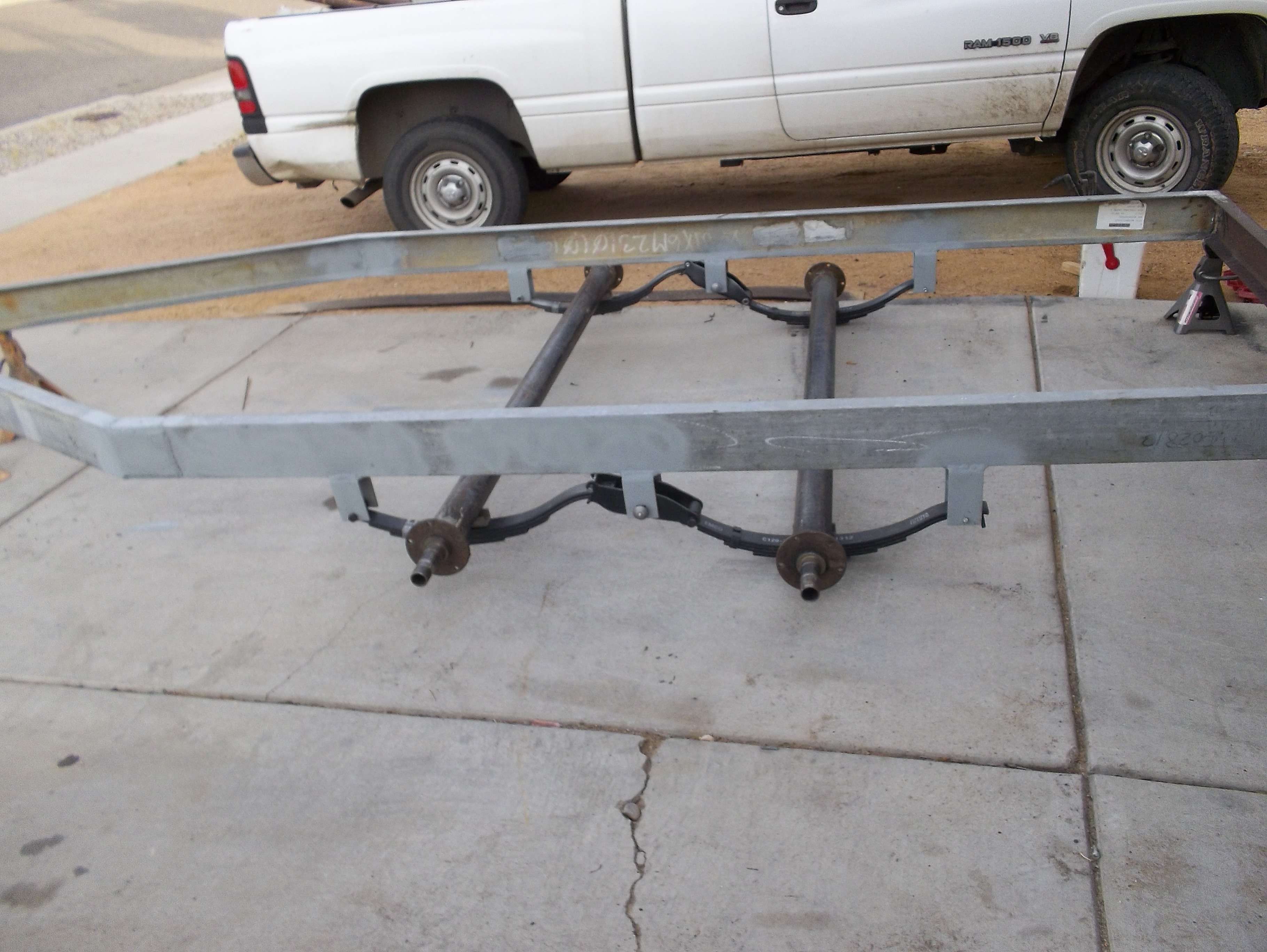

I would, and have, use used mobile home axles, wheels and tires from a mobile home dealership or from craigs list.
I bought them with springs attached for $100 and 14.5" wheels with tires for $25 each. Axles and tires are rated at 6000# so you can really load them up. I would not get a new tire for a wood hauling trailer because they will just rot out anyway.
The axles are straight so you just cut out the length you don't need and reweld. Maybe scab a chunk of 3" angle iron over the joint for strength. I have 2 trailers right now that way and they are great, and not afraid to take them over the road. If a tire goes bad just get another one with rim for $25,

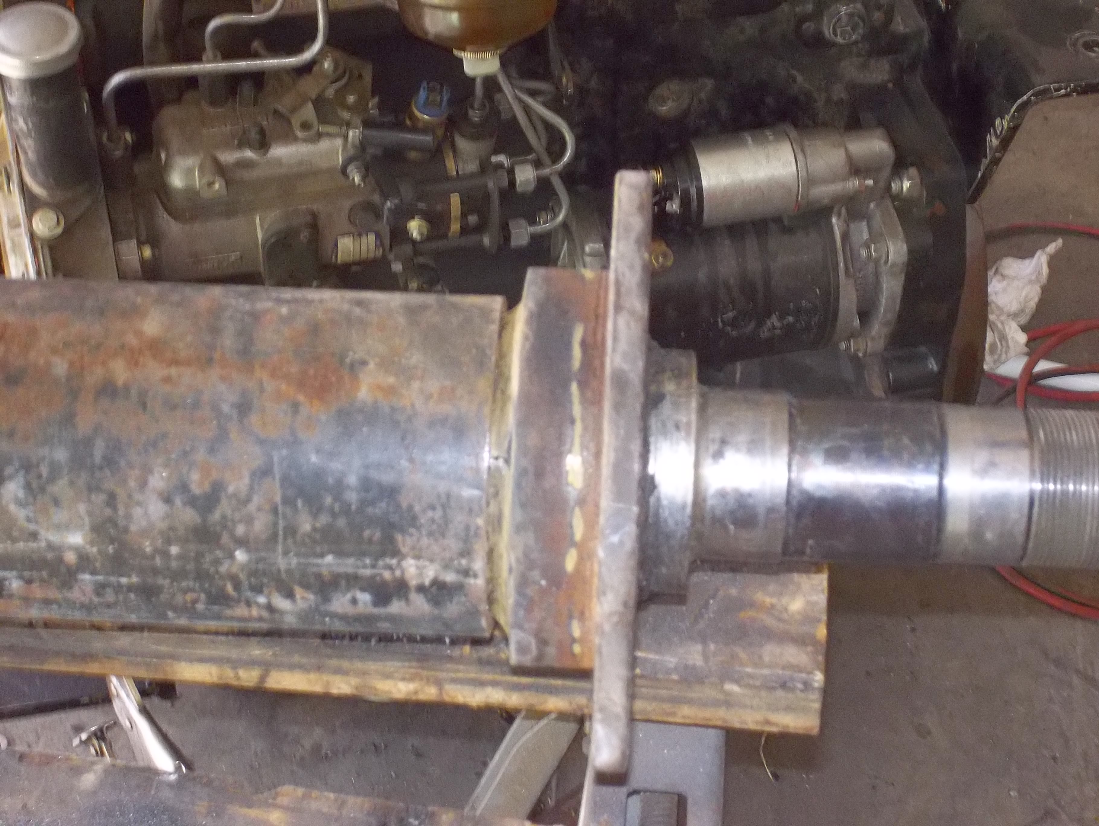

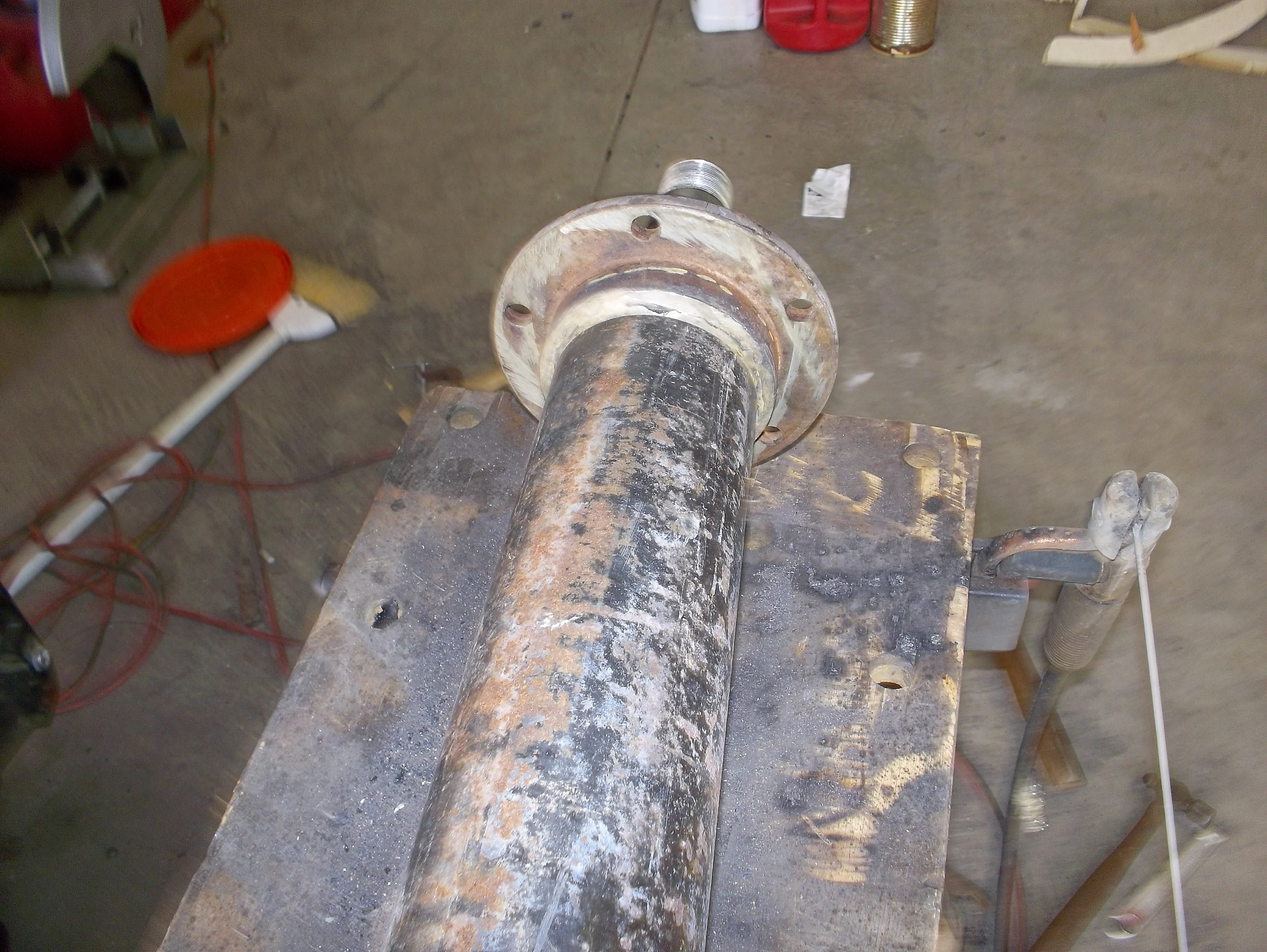

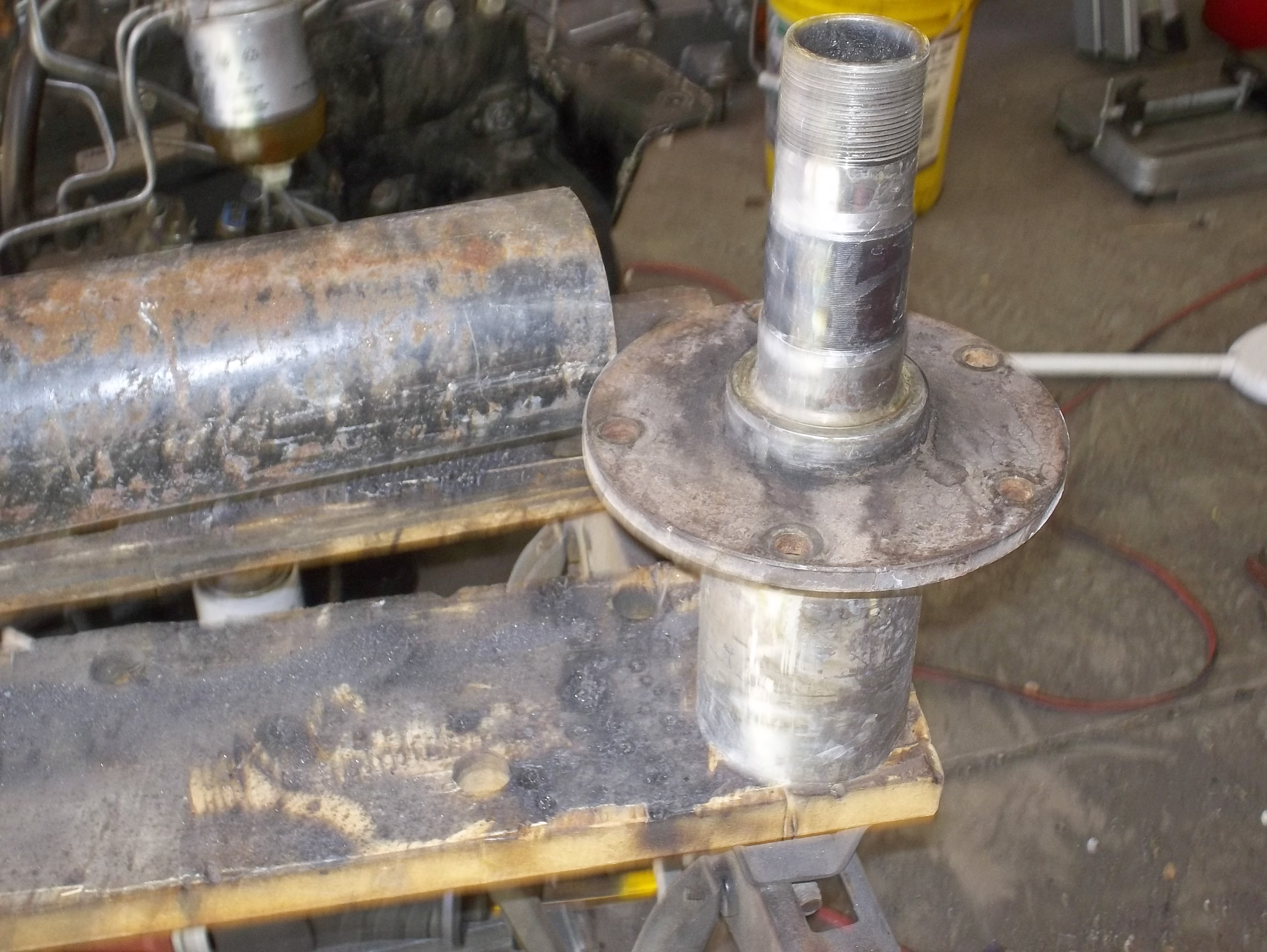

If you go the MH axle route, there are hub retro-fits that will take you to 16" tires.
I have made many axles by using Ford, Dodge or Chevy 1 ton rear diff housings and leaving the hub and brake assy in tact. If you cut the housing outboard of the spring perch, you should have a 3 to 4 " stub. I use sch 40 3-1/2 id for the axle portion cut to the desired width.
Depending on the pipe you are using as a tube, you may have to hone the ID to get a VERY snug fit on the hub stub. Some times you may need to clean/brush/grind depending on the crud on the hub stub.
Sch 40 tube and 1 ton hub s/b about 8,000 rating

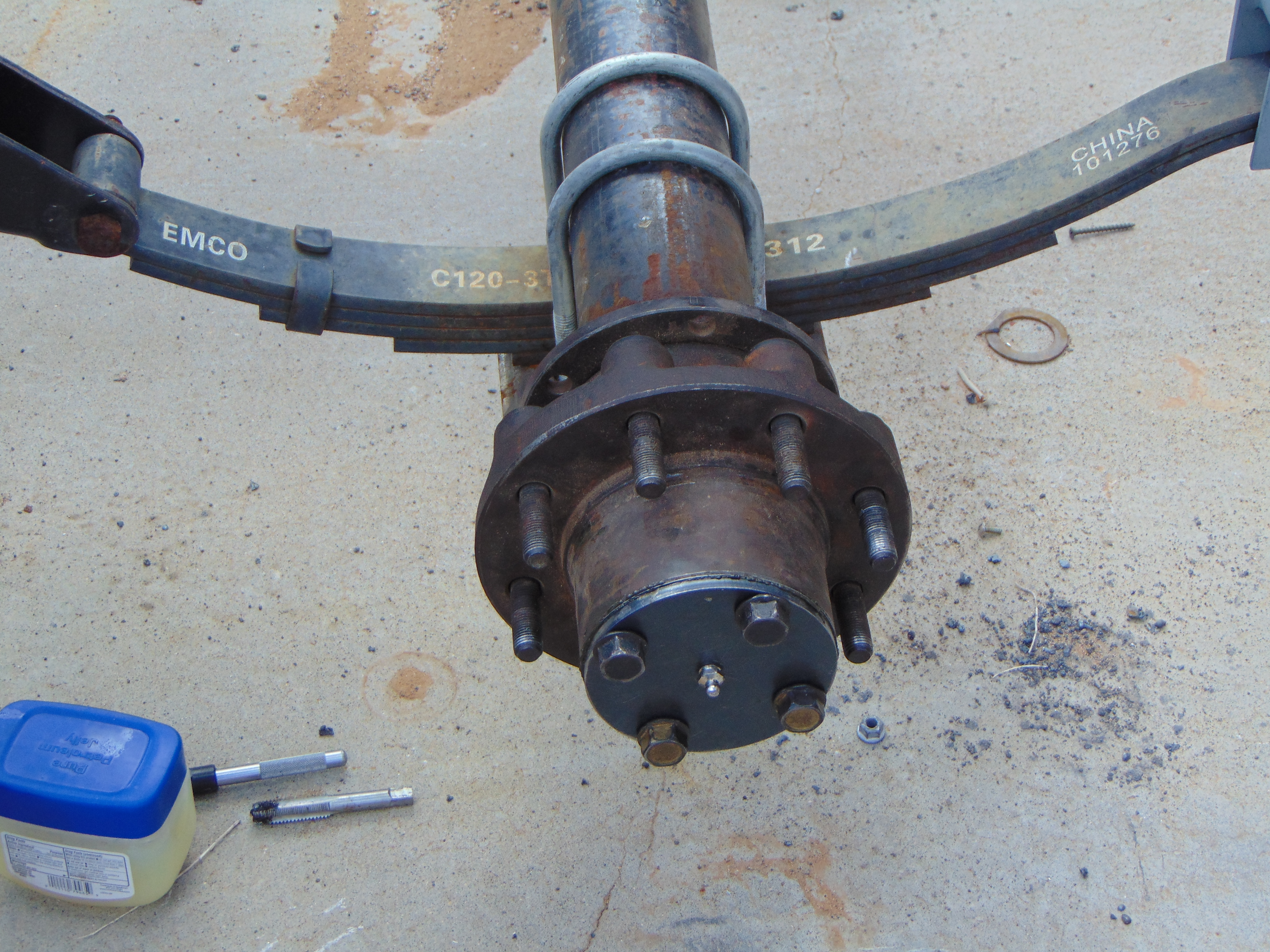

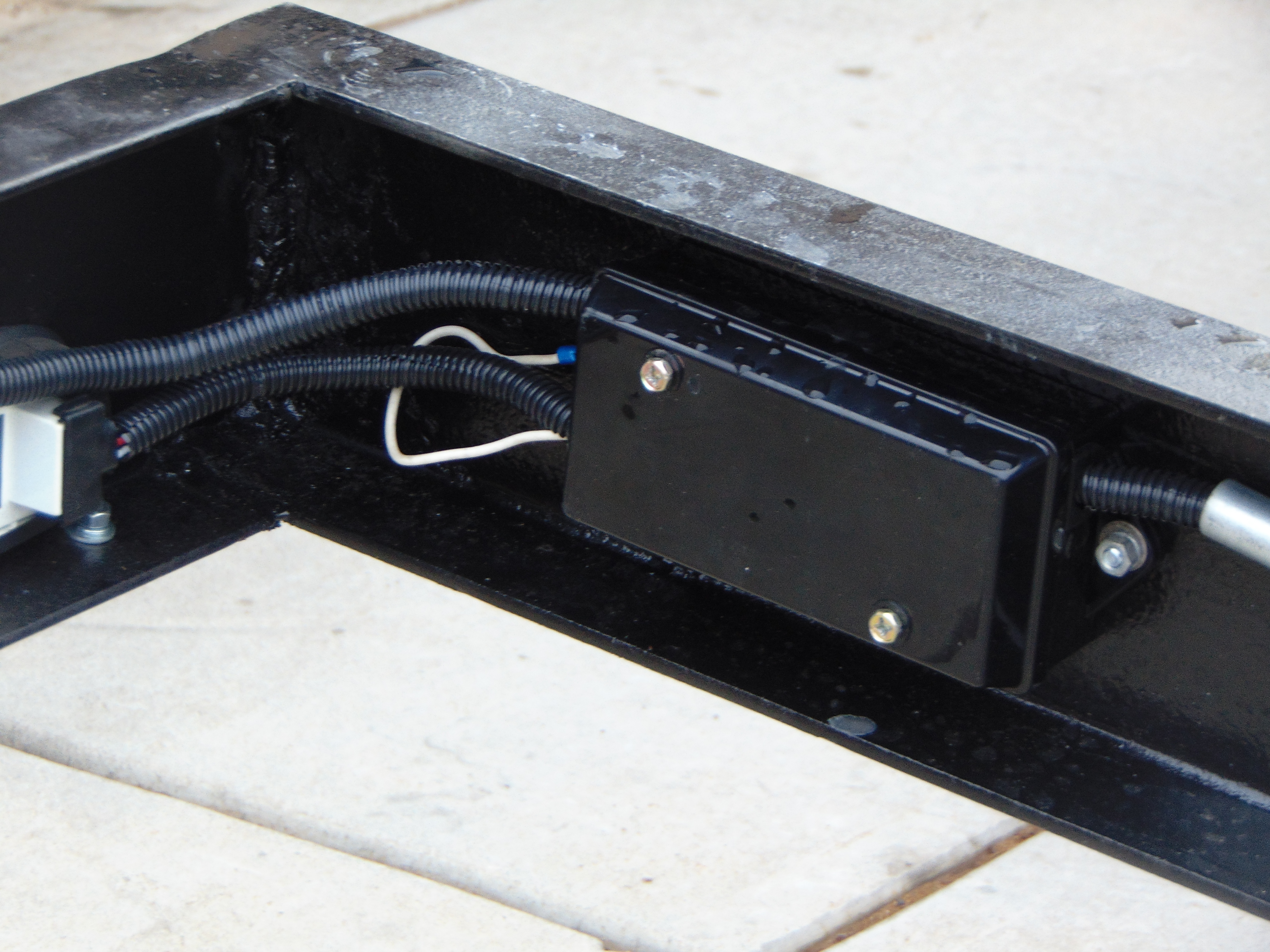

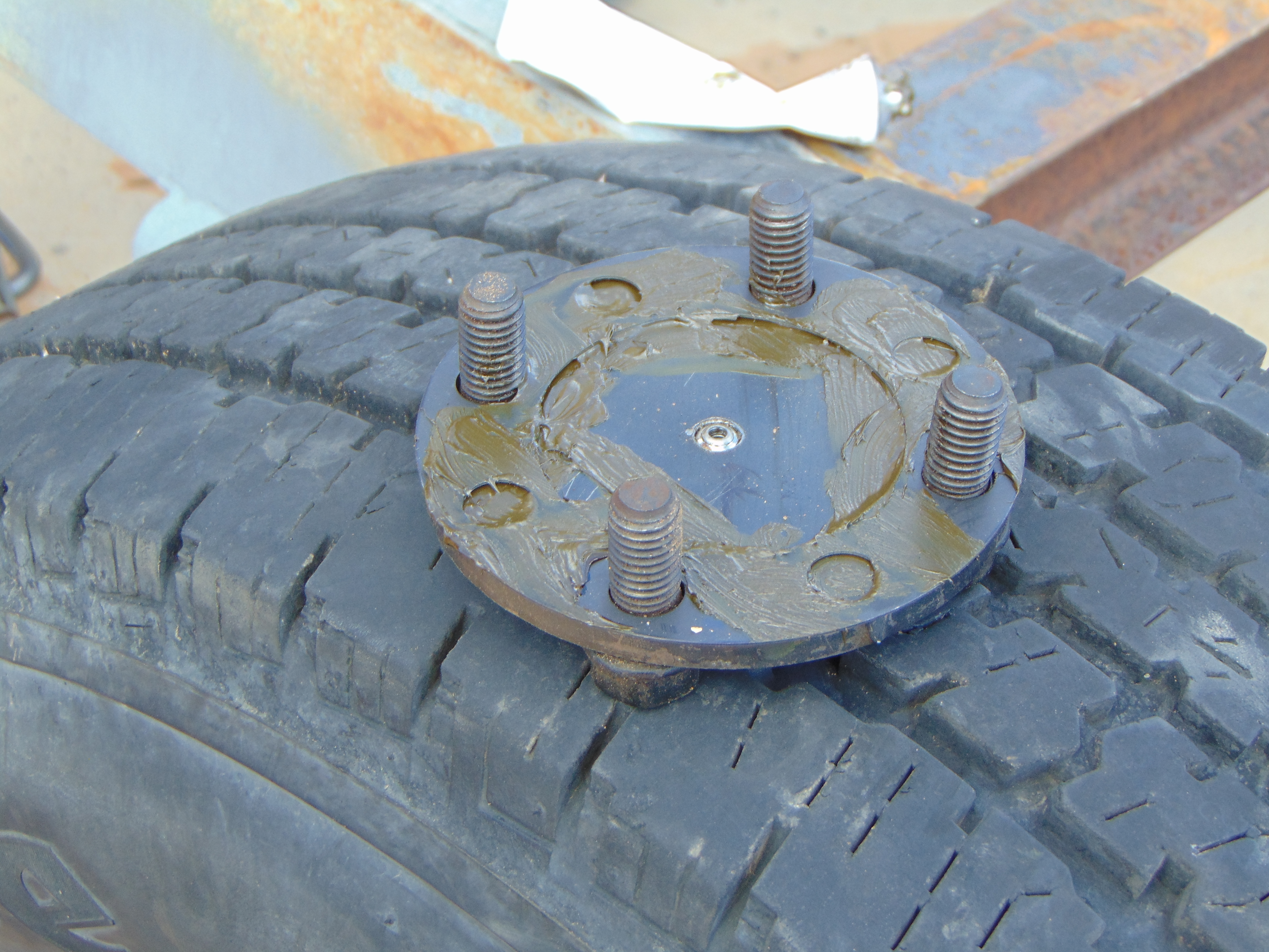

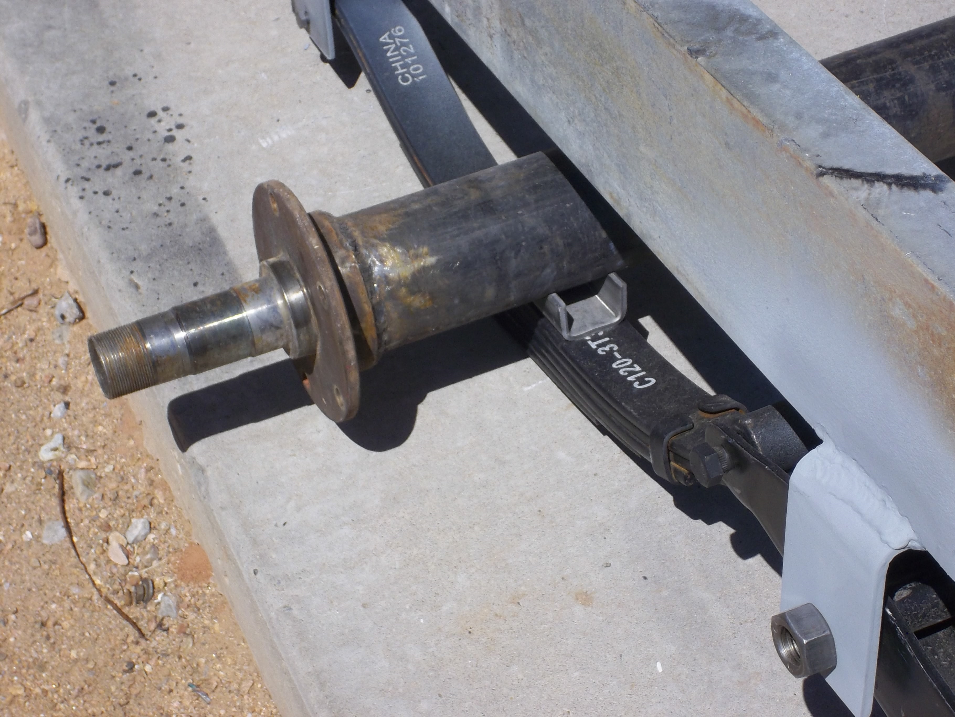

Here's a few more pic's

Eastern marine has trailer axles available in 2in incraments for a decent price. Get one thats got the grease zerk in the spindle.
There was another custom width place that i had found when i rebuilt my 6.5x12ft trailer but i think eastern marine was cheaper.
