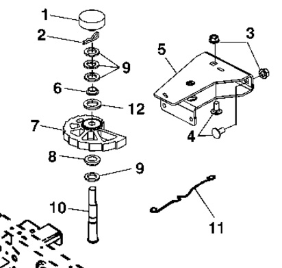

Yesterday I got a 2007 X728 Ultimate series with 4 wheel drive, 54" deck. I have the tractor manual but no deck manual. I turned the deck knob to almost full up and raised the deck. Now I cannot turn the knob to adjust. It is stuck. I took the plastic knob off and gave it a shot of PBB, but still cannot turn it. This series JD is totally unfamiliar to me, and any advice on how to free this up to get the deck moving again would be appreciated. Also any tips on how to remove the deck would help. Thanks

You may have caused the problem by turning the deck knob up before raising the deck to full height.
Here is a schematic of the mechanism under that knob (key #1)

Definitely need to only adjust that from full down. Put it all the way down and the knob should be freed up.

I suspected the problem was self inflicted. Thanks for the replies. Do I need to remove the deck to fix this, and if so how does the deck driveshaft disengage?

Put back (forward towards the deck) on the outside ring on the coupler

Thanks for the help. Got the issue straightened out-and will definitely NOT make that mistake again.
