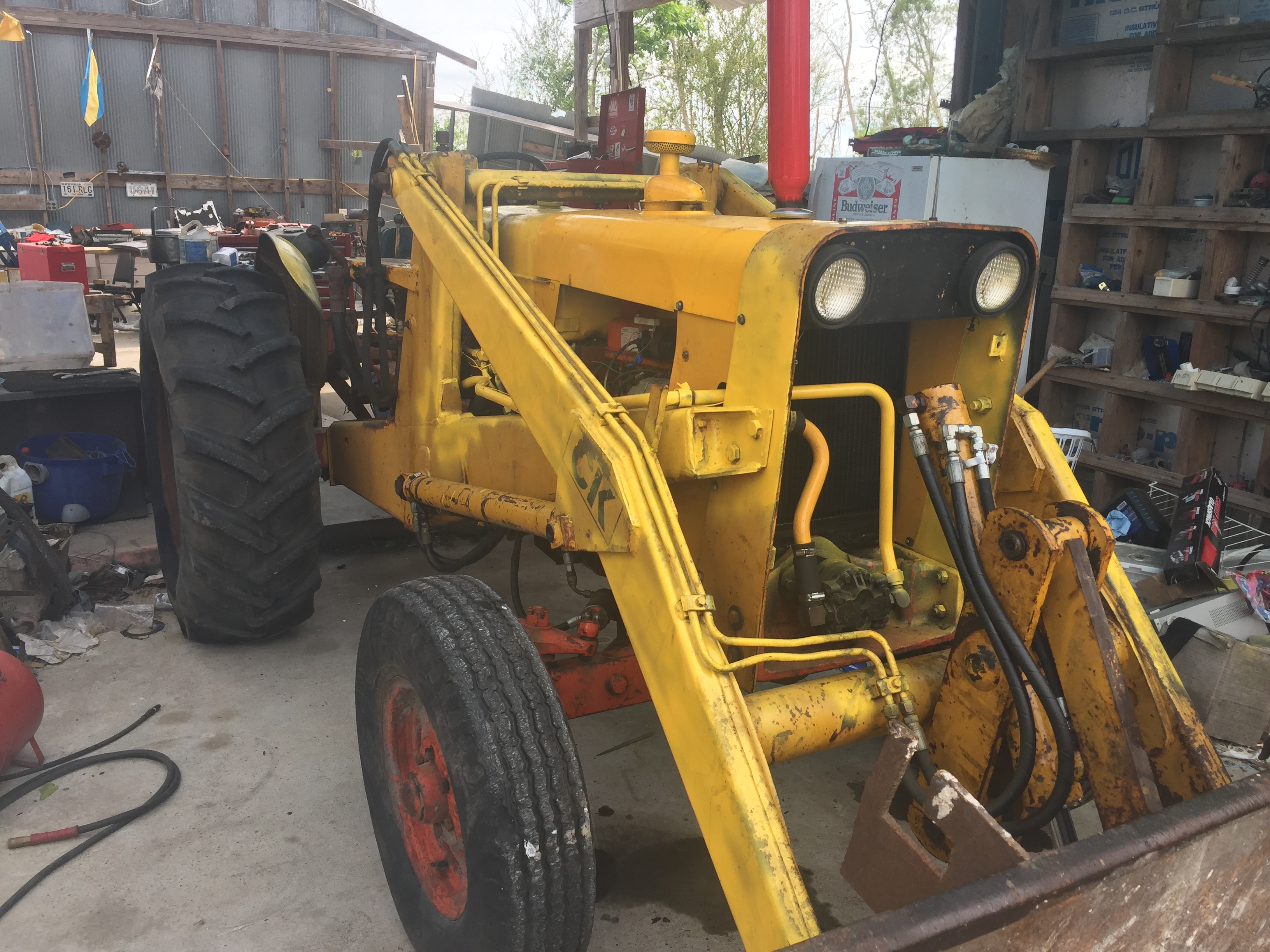

Well I've pegged my Fun-Meter. The head has been removed and is being overhauled. I decided to replace a leaking front oil seal while the head is being refurbished. A major discovery is that the front pulley does not have enough clearance to come off the crankshaft. What is the best why to get clearance between the engine and the massive hunk of metal that the front axle is attached? Many expletives have been avoided.
There appears to be a groove worn into the pulley by the old seal. I've been led to believe that the pulley can be fitted with a sleeve and a larger diameter seal. Has anyone had any experience with this technique?
/ Need Information #10
This is where some pictures really come in handy. I really don't want to insult mine, or you intelligence, but I'm assuming you've removed the flex drive plate, the hydraulic pump drive shaft hooks to, on the front of the crankshaft pulley. While I have not had to remove the pulley on my 480C, I have a on the old 310B with gas engine, and there was more than ample room to get the pulley out.
I looked in my service manual, which happens to be laying right beside me, in the photo's such as they are, it shows removing the pulley while in the machine. On the other hand, it appears the whole front end is wide open, and we both know that's not right.
Other than removing the motor mount bolts, and transmission mount bolts, then raising the front of the engine enough to clear the front end casting, I don't see how you can do it any other way.
As for fixing the groove, from the crank seal, there are aftermarket kits that use a Speedi-Sleeve to fix that. This one will run you $56, the seal to match is $13. Although at this vendor, they appear to be out of stock. https://www.epsstore.com/index.php/engine-exhaust/crankshaft/a155893.html It shouldn't be too hard to find another vendor though, that does have them in stock.
/ Need Information
#11
This photo shows the pulley as being trapped.
After dropping the big hunk of junk iron the pulley came free and the old seal was removed. A new seal is on order.
