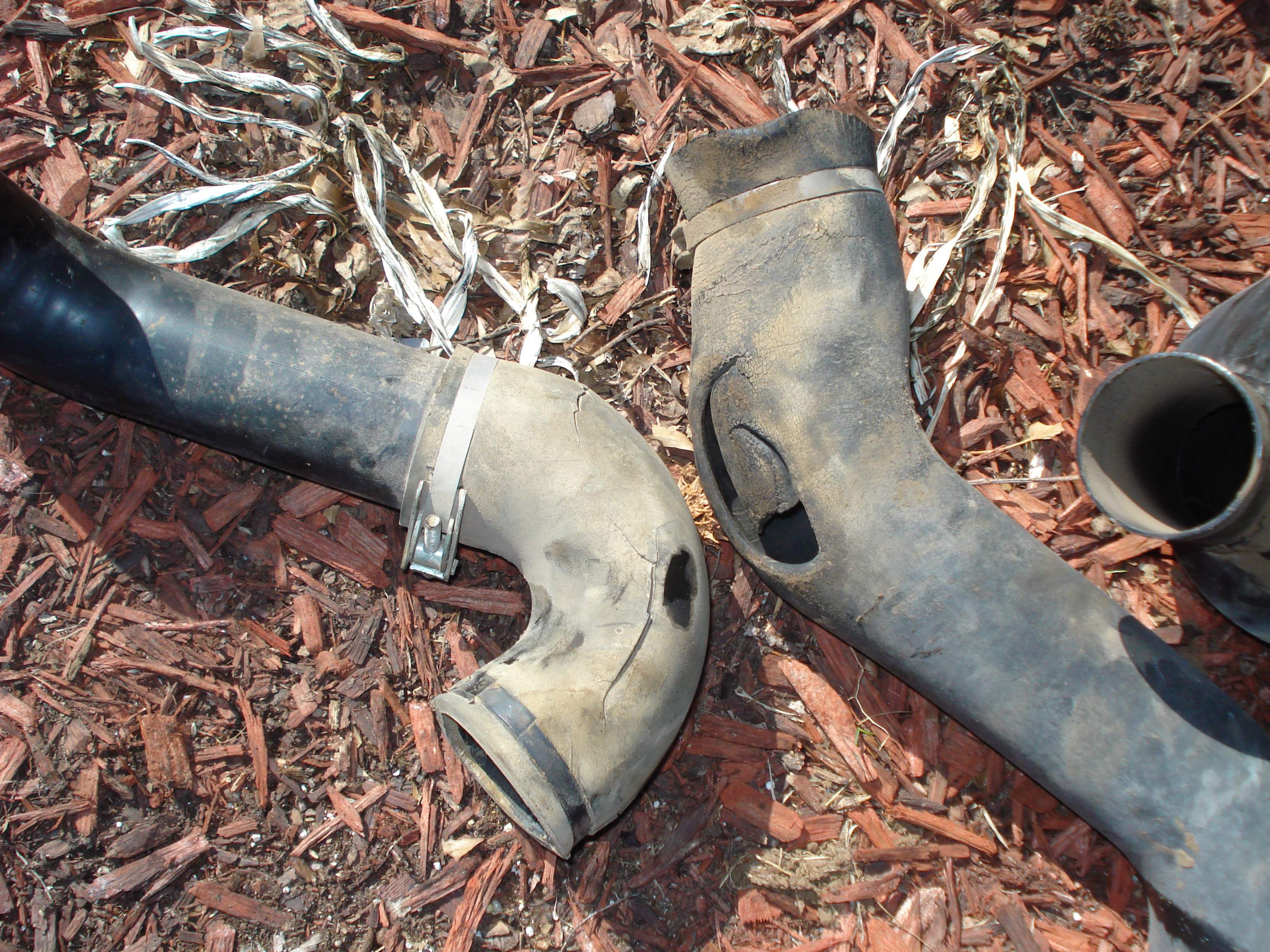

5. Got to checking the tractor out and find out the air cleaner system is shot. Holes in the hoses, oil bath fallen off, dirt everywhere. I'm sure its been sucking dirt for a while. "Dusted engine" situation so I've read. I don't know how this would be directly related to the dry radiator issue.

I am going to fight my usual inclination on this deal and actually take the engine apart before I order parts...who knows, maybe I'll get lucky and only need to replace the rings and bearings a call it good. Here's a picture of what probably caused the "dusting" issue.
I learned today that the head gasket was replaced by a real shop not that many hours ago (100 maybe). That bothers me because I may have a crack, although the radiator issue seemed to come about all at once, although I can't say for 100% certain.
