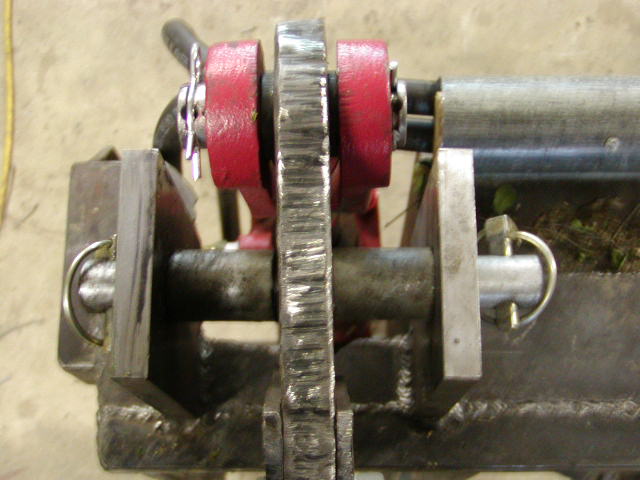

I have built a root rake grapple and used 1" steel rod for the hinge. It is spanning 5" with the grapple attachment made of 3/4" steel plate, centered in the 5" and is operated by a 3" dia cylinder.
It seems to hold the hydraulics OK, but I hung the grapple on a tree & it bent the 1" pin a little, but not beyond use. It also blew a hydraulic hose at the same time.
So when I decide to replace the pin, I will want to try to make it stronger. Because of the pivot clearances, I do not want to go to a larger pin.
So what are your suggestions?
Would heat treating the pin make it stronger or just harder?
Or would it be better to try to close in the 5" span?
Thanks for any suggestions?

Neal,
Definitely close up the clearance to a minimum. With no clearance, the pin is in pure shear-very strong. More clearance means shear plus bending stress. Heat treating is better than nothing but you need to know what the metal alloy is and pick a medium hardness to avoid brittle failure. Only some alloys can be hardened full thickness. Mild steel can be case hardened(surface) only and probably won't gain much in strength.

well its kinda hard to picture just how its setup but i assume you mean that in the center of the 5 inch span the 3/4 thick plate thats the grapple is welded to this piviot pin and then its just open air to the 5 inch opening, could you weld gussets in this space, also closing the 5 inch opening would help alot since a pin is always stronger in shear than in bending. also what material is your pin made of, just mild steel? something like case hardenened shafting, or 304 stainless would be much tougher, or possibly an old truck axleshaft machines smooth on a lathe, they make an extremely tough pin but are very hard to machine but they are about the ultimate for toughness a picture of what you made would definatly get some more insight tho on how to improve this setup

For a beam (your round stock) supported on both sides the bending moment is directly proportional to the length ie 1:1. the amount of stress you can handle is proportional to the moment of inertia (cross section) and material strength.
Given that you want to keep the pin the same size, both shortening up the span or increasing strength of the steel will help. ie - @2.5" ILO 5" you could handle 2X the load. @2X steel strenght you could also handle 2X the load. Maybe a combination of both.
A word on inertia: For a circular section I = pi*diameter^4/64. It is diameter to the 4th power. Big bang for the buck here.
A 1.25" pin would be 2.44 times stronger. A 1.125" pin would be 1.6X stronger. A 1.5" pin would be 5X stronger. Maybe you want to re-evaluate changing pin size?

Attached is a picture of the hinge.
I can add some metal inside the uprights, but must leave enough room for the cylinder end (horseshoe) to pass between.
