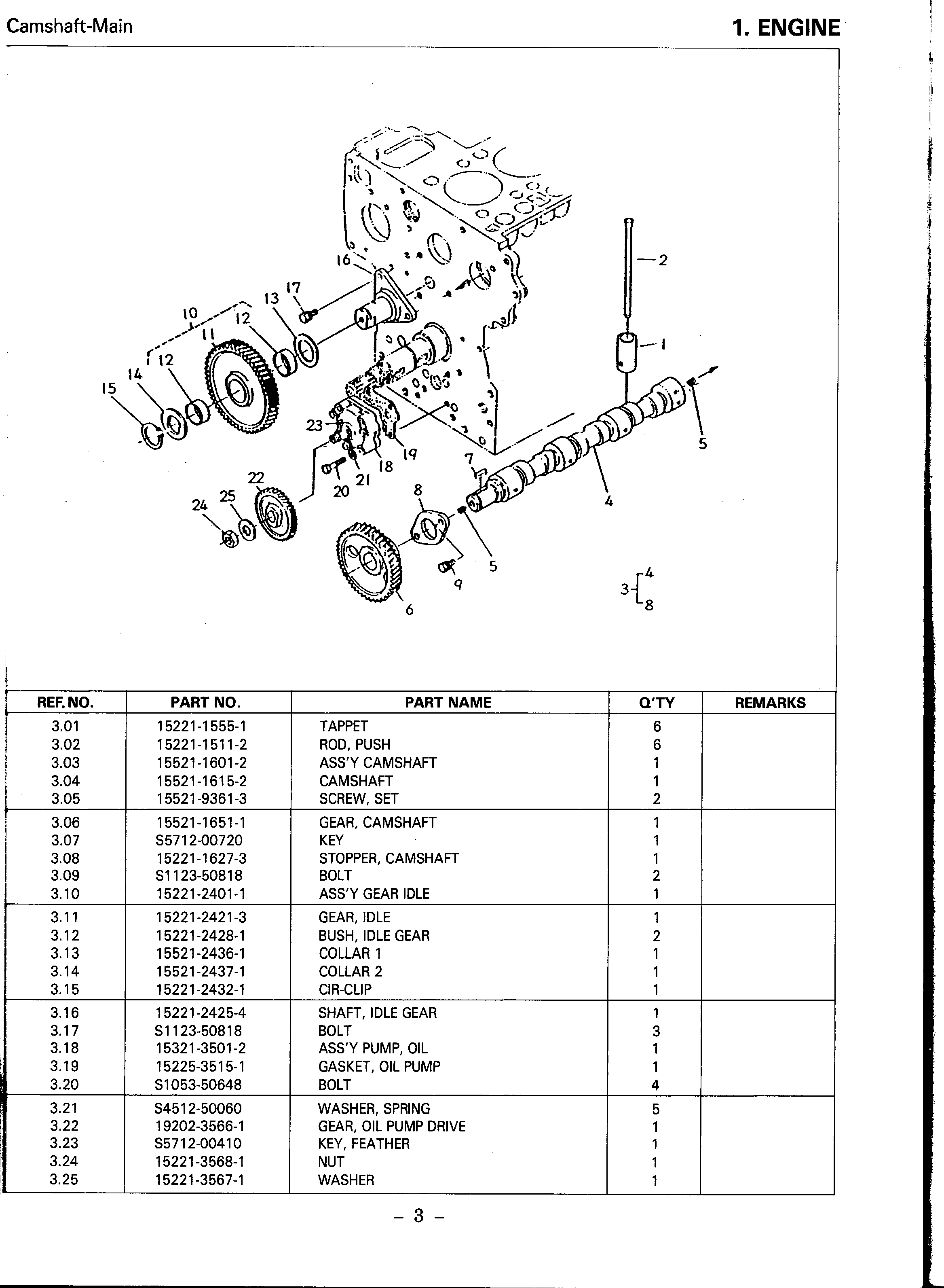

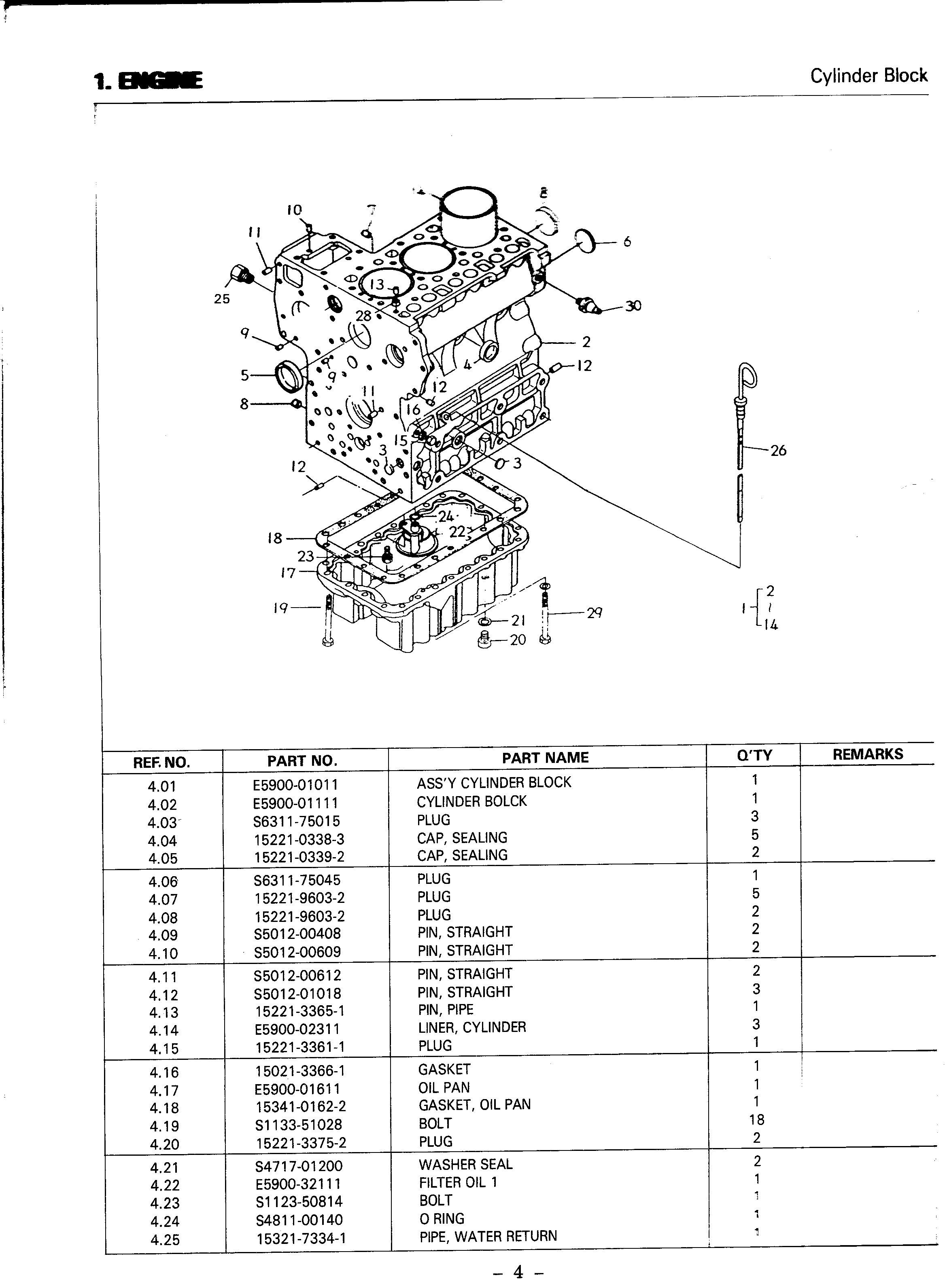

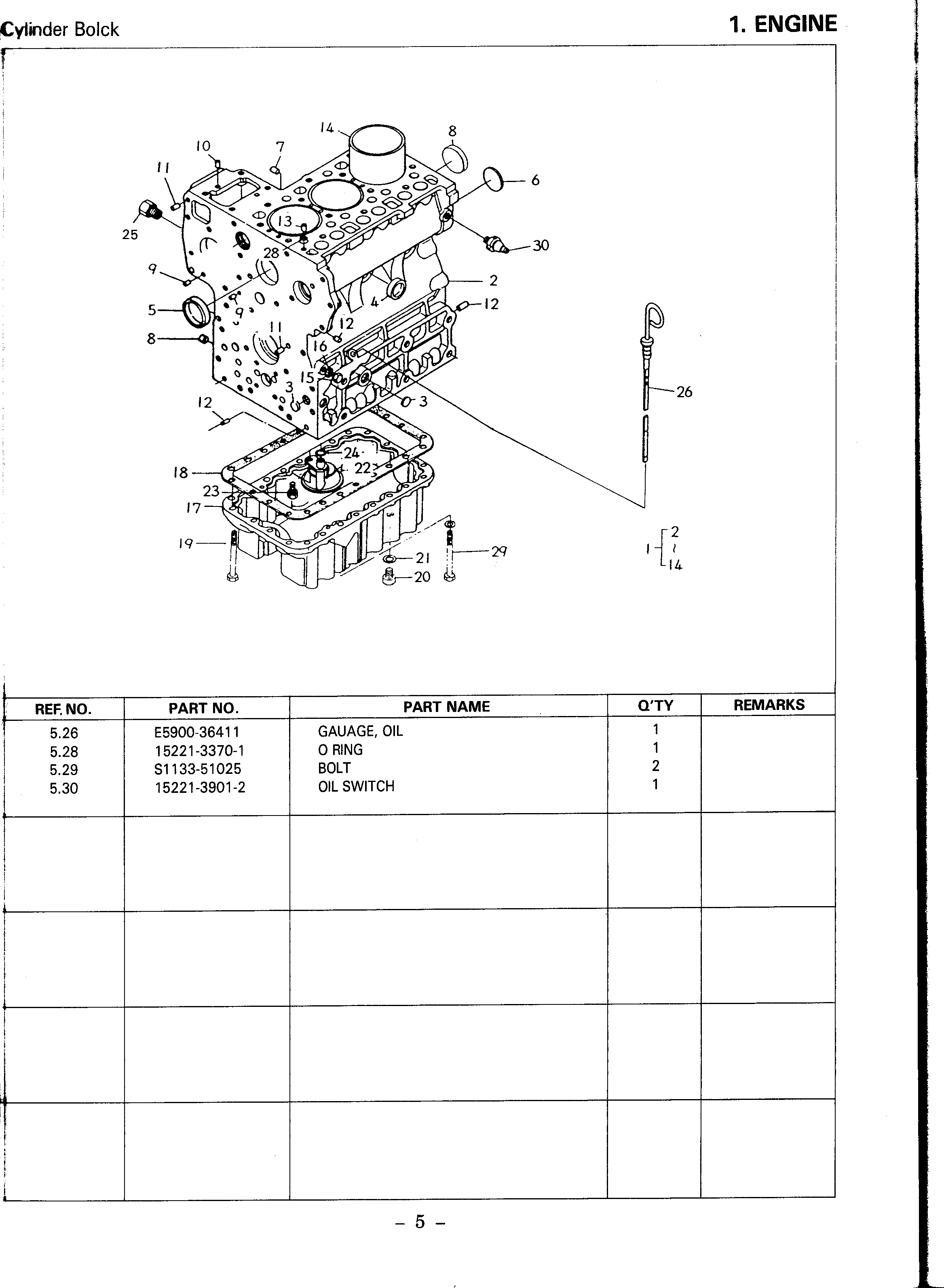

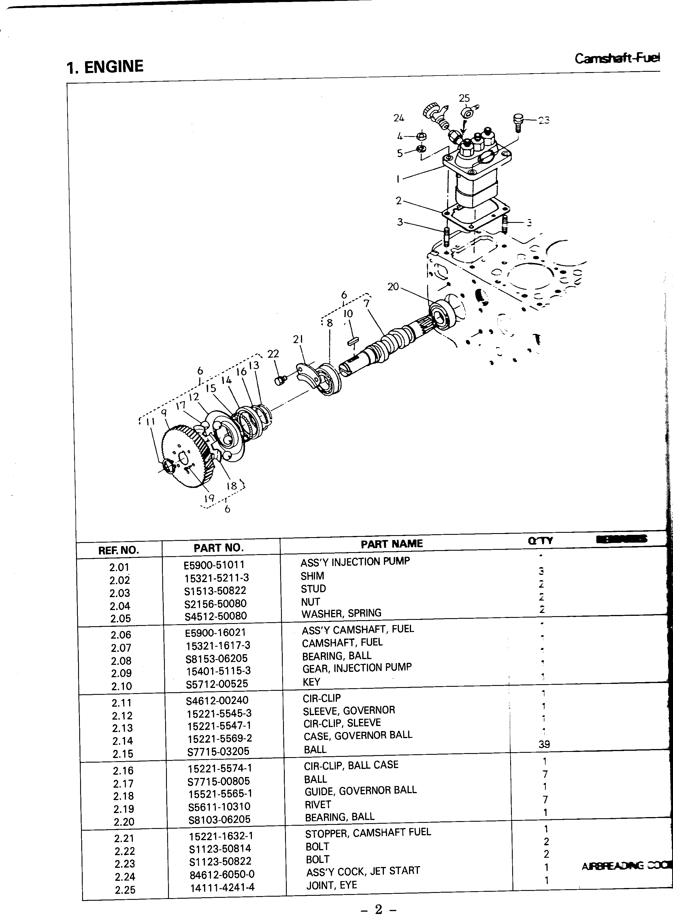

My minor oil leak as turned into a major stream... I have a mid 90's LK 3054 and it appears its coming from the Front Crankshaft Seal (although I haven't completely confirmed)
I'm looking for someone who has the Illustrated Parts beakdown for this Engine. I'm an aircraft mechanic by trade so just need to identify the parts and then I'll order... I can't afford to be down long.. We set an all time record for snow in one month.. Over 65" at my house in less than three weeks.. With a 2500 ft driveway... Well you know...
Anyone? Please?
   / Need info for Oil Leak on Mid 90'd LK 3054 #2
Hope these help.
