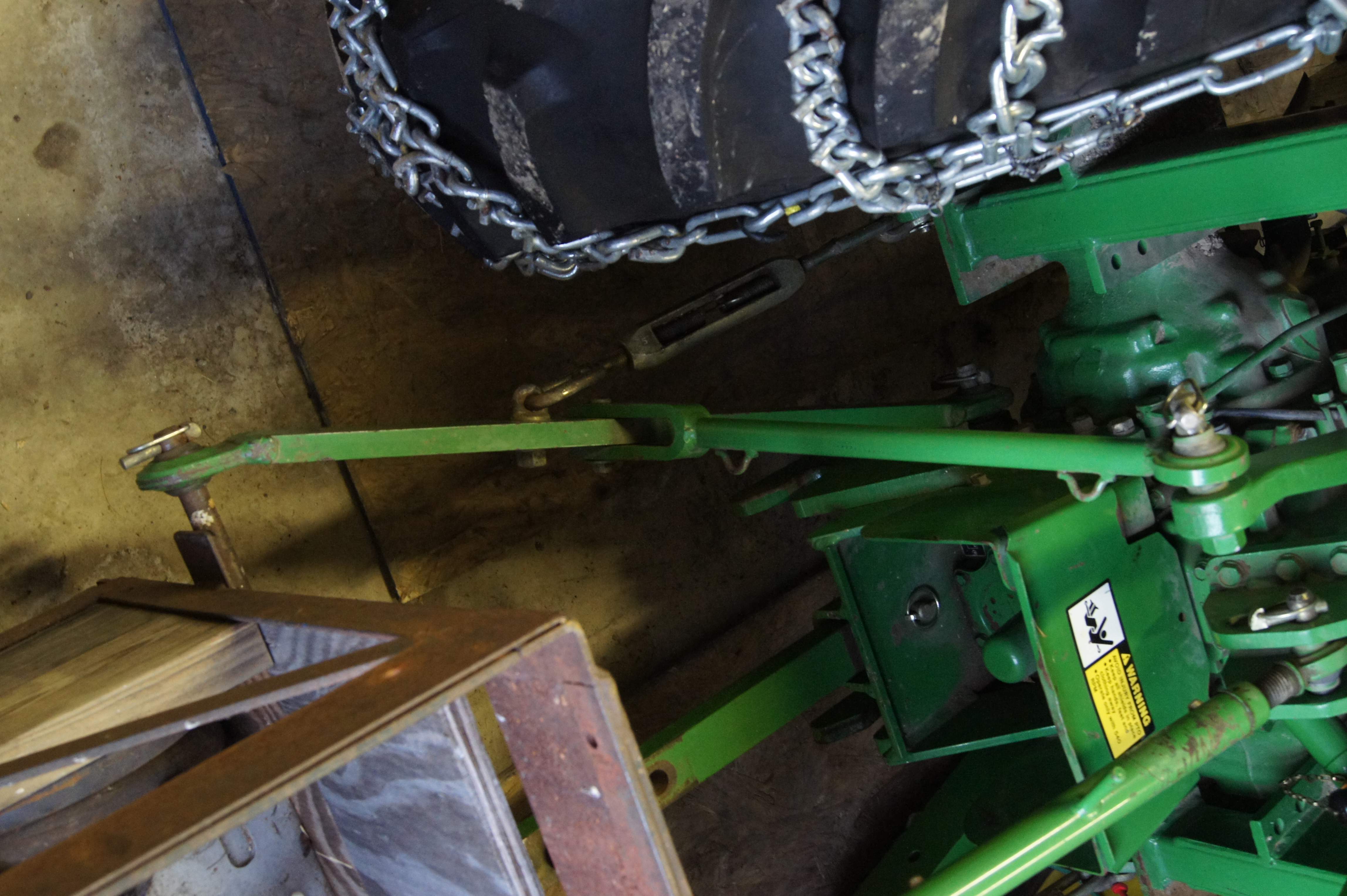

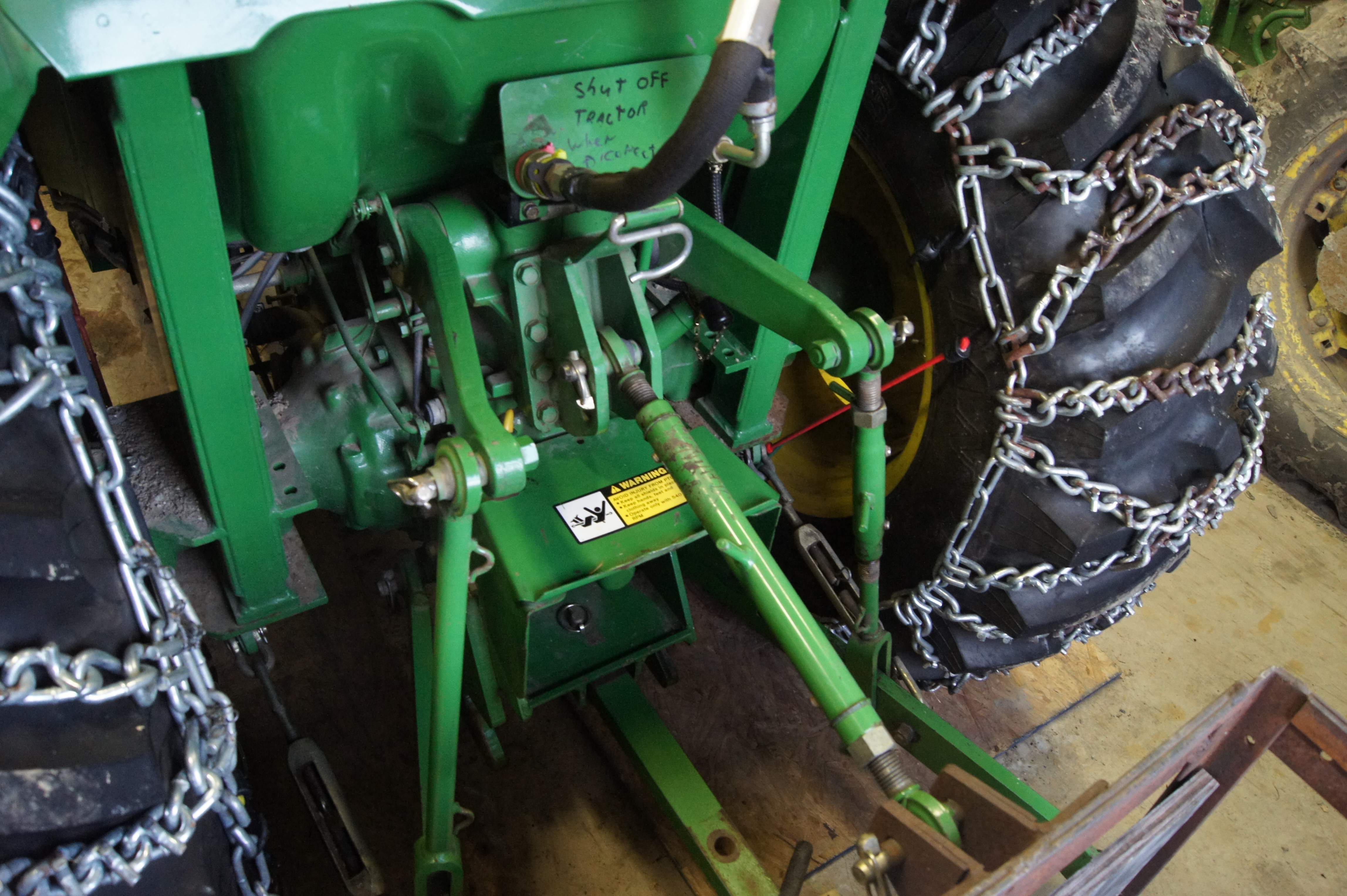

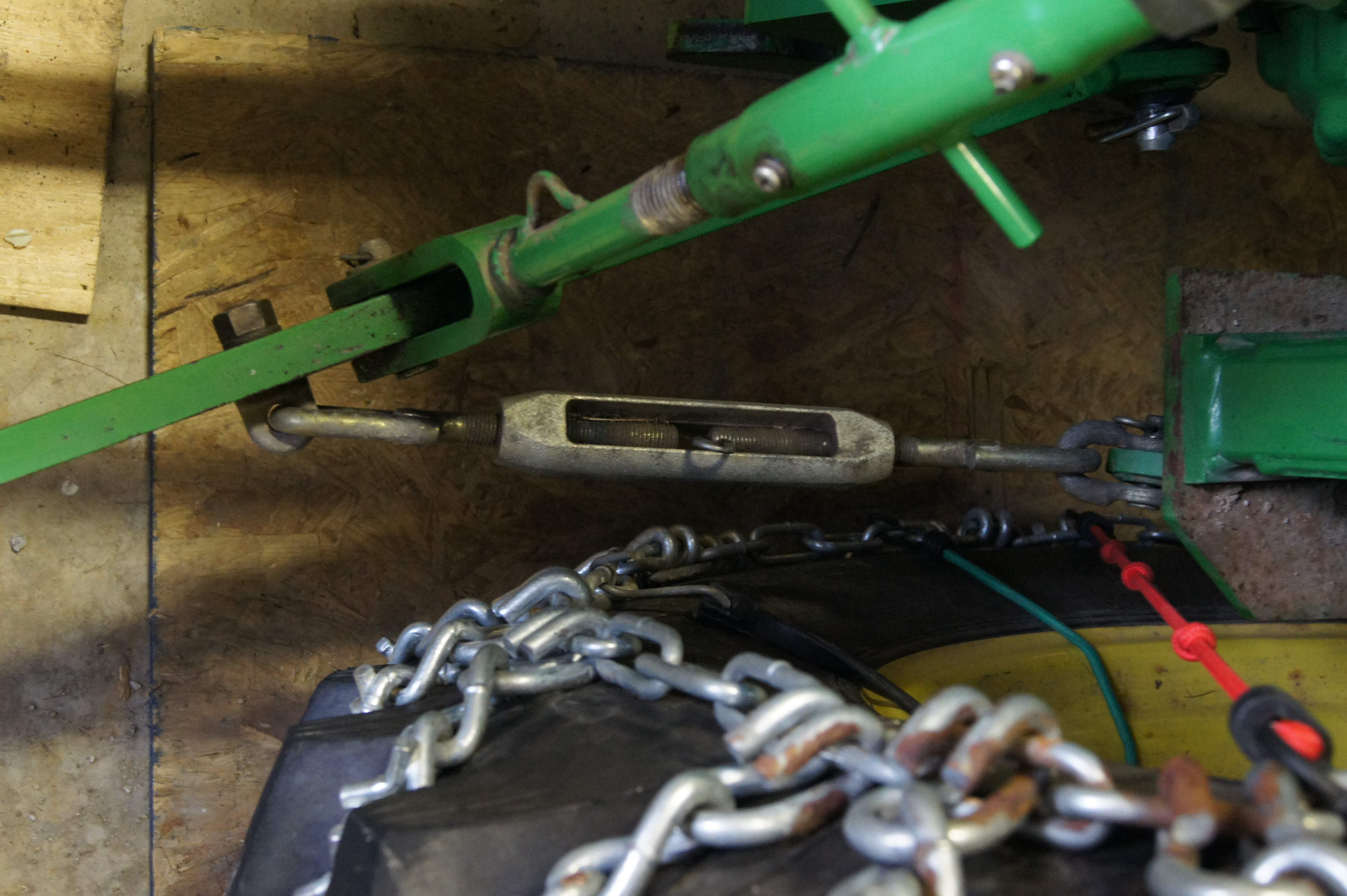

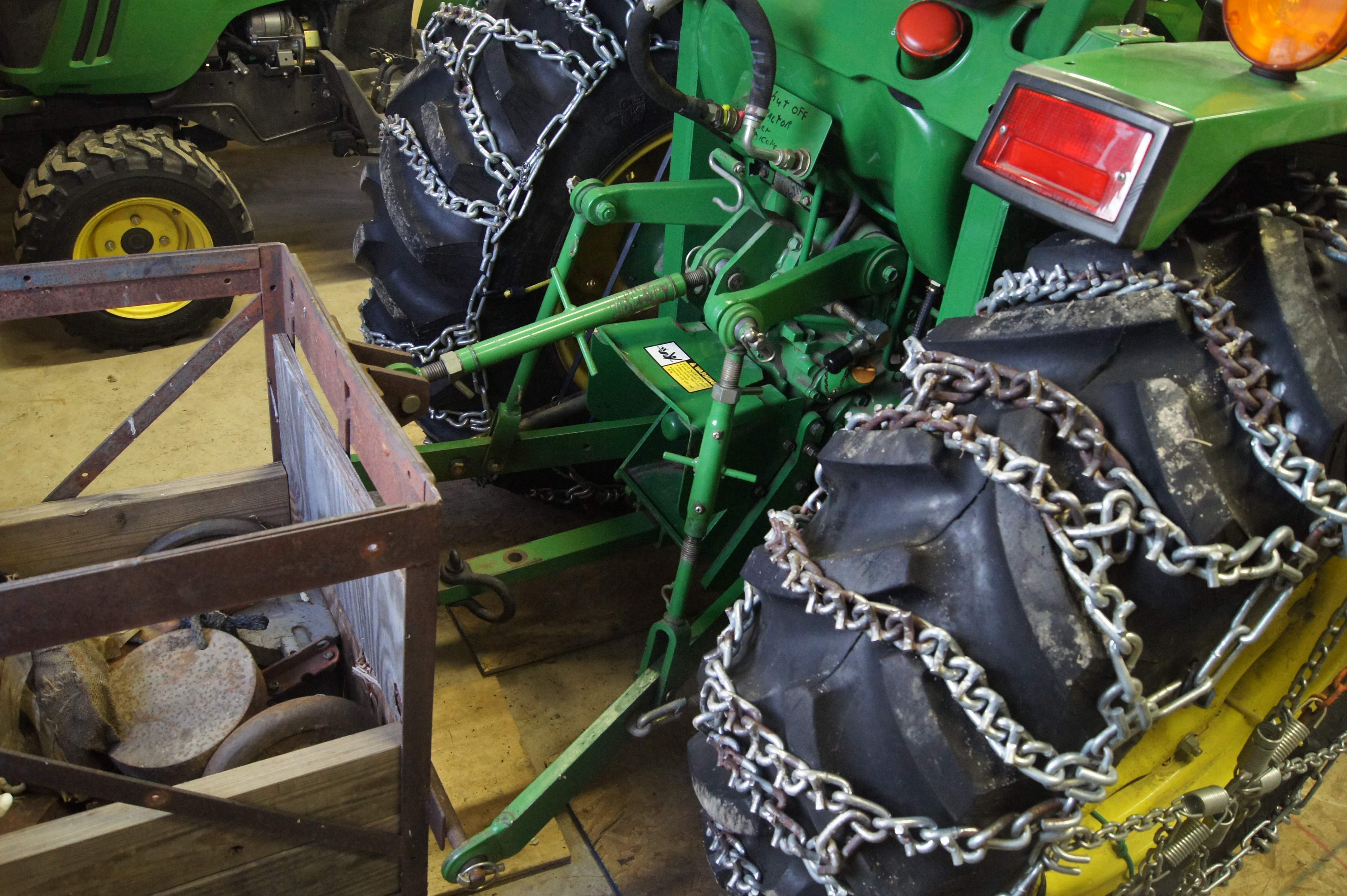

hello maby these pics will help you. DSC03952.jpgDSC03953.jpgDSC03954.jpgDSC03955.jpgDSC03956.jpg

Thanks, I really appreciate you posting these. Good pics.
What year is your tractor? Pre s/n 691474?
Edit to add: From looking a parts diagram it looks like you have the older style turnbuckles on the sway chains.
   / Need info for 3-pt on a 990 #9
JP those are the earlier draft links etc. Mine are all black and are different. See if Sal64 would do some measurements for you.
