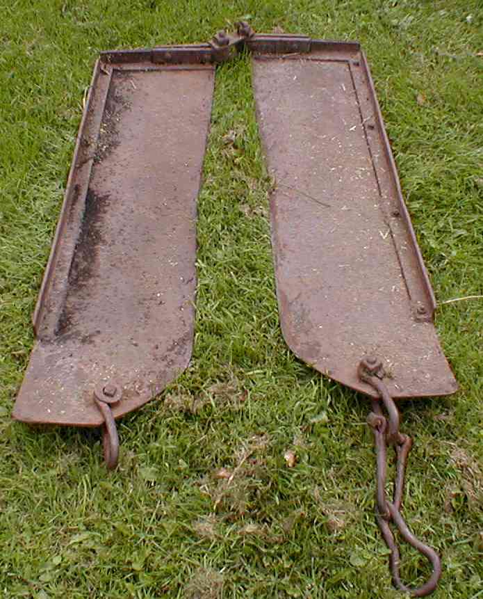

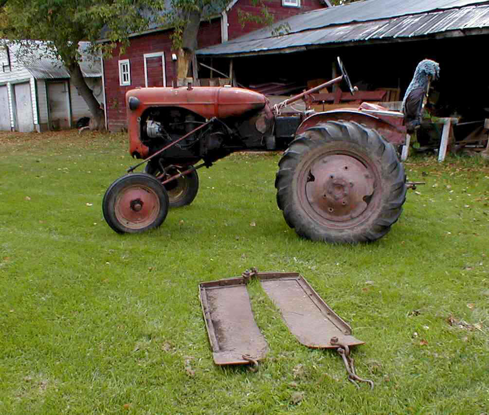

I may make one someday. It will be a two-piece design, like this old one. No loading needed. Place it around the rock, then pull. It closes under the rock.
Bruce

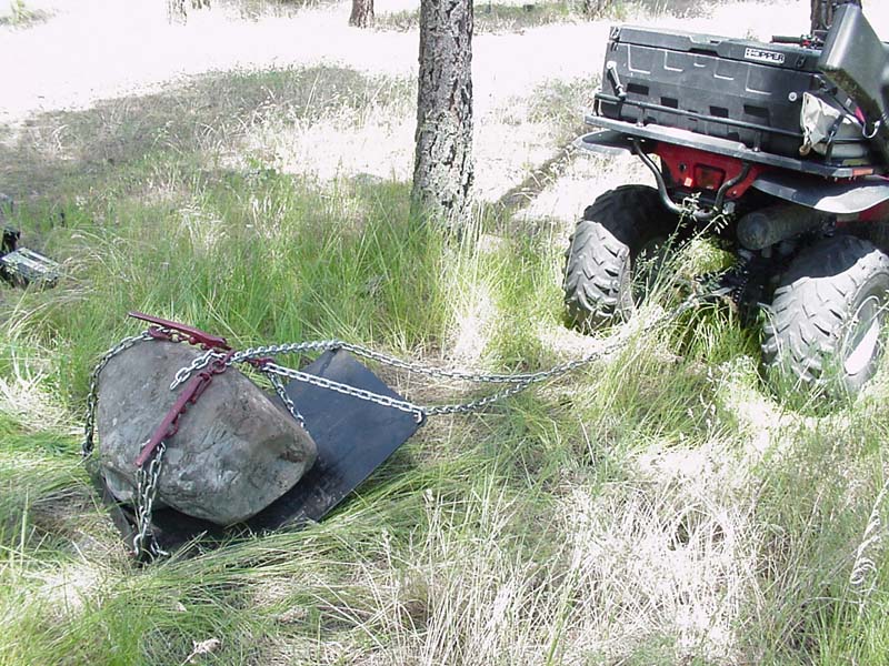

Another simple design, using a small piece of thicker steel than a car hood.
Bruce
