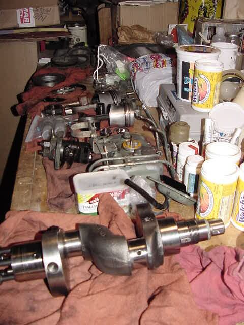

   / Need help #8
Dick,
Here is a picture of my workbench with the 2T72 engine parts laid out. In the foreground is the crankshaft. The focus isn't great, but on the left, you can see the back end of the crank with the six bolts that hold the flywheel on.
