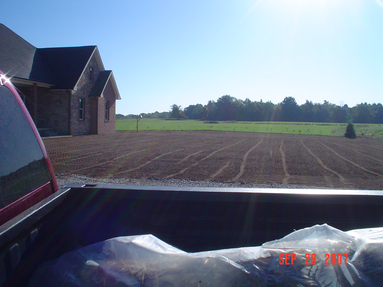

If you want a perfectly smooth seed bed, go rent a harley rake. Awesome piece of equipment. You can usually rent one for about $250 a day...here's a pic, wish I had taken a before shot.
