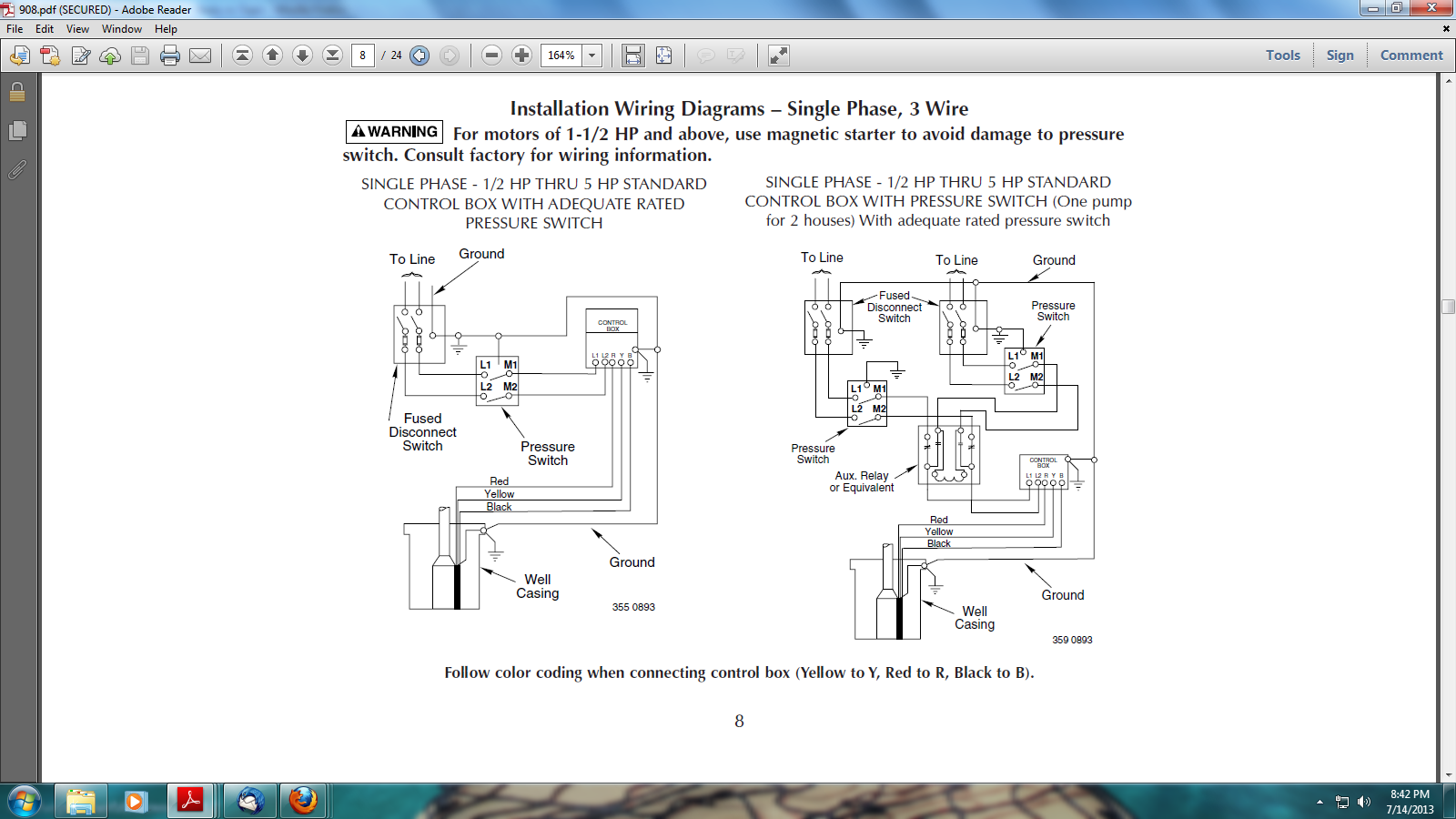

So we went on city water a few years ago and were required to abandon our old well. But I made sure I saved the pump (it was fairly new). I now have a use for it (pumping water out of a pond) but I am unsure of wiring. My hope is that I do not need all the complicated control panels as I have them, but they are now buried behind shelving.
The pump is a gould 4" submersible model # 10LS05412. Wire colors are Red Black Green and Yellow. I intend to run this off my 5K generator which as 220. But now I am stumped. Green appears to be ground as it is thinner (and the color would be correct) but I am unsure of the other colors.
Anyone have any advice they can impart. I have struck out on the net other than tech specs that are over my head.
   / Need help with well pump project #2
Well, yeah you are going to need the stuff that is buried behind the shelving. What you have is a 3-wire system that utilizes a control box to house the capacitors and relay, rather than having them in the submersible pump itself. I have attached a drawing which shows how it is hooked up. Hope this helps.

I think you're going to need the control box. It has a start and run capacitor inside of it that you will need.

Darnit. So, help me with this, I understand the cap gives an extra boost to the pump motor to get it rotating. Is it necessary? Or, How necessary is it? Can the pump start and run without the cap?
You are likely to burn the motor up with out the cap.

Is that because the motor will overheat trying to get up to speed? I am just trying to get the theory down to see how far Ican push and what I need to be careful on. It is a $500 pump motor and I would be bummed to kill it, but by the same standard, It is pumping 7 feet vertical and across a dirt road into a ravine. Maybe 20 feet total with 7 of it vertical.
Also, back to the wires. I see in the diagram Red, Black and Yellow. So, what are the hots and what is nuetral. It has it all running into a switch box with no explanation.
