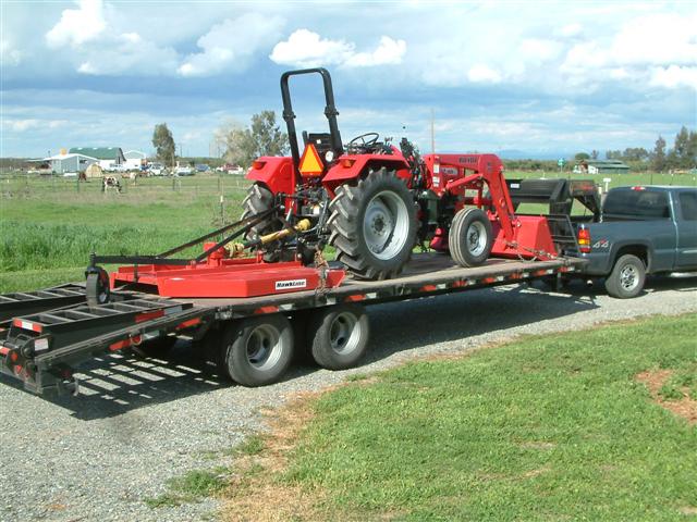

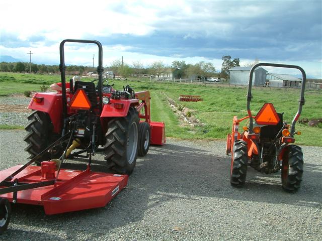

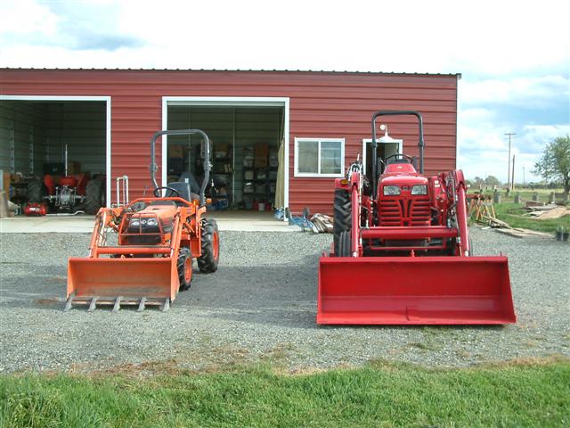

I have a 2008 Mahindra 5525 for handing haying chores on my 10 acres. 54 hp engine, 45 hp pto, 2WD, gear tranny, power steering. It has the ML250 FEL (6-ft wide bucket, 2950 lb lift to 10.5 ft height) which would handle 1000-1500 lb round bales pretty well. I mow with a 6-ft Hawkline brush hog (rotary mower). The tractor with FEL weighs about 6500 lb with loaded rear tires.
The small tractor is a 2005 Kubota B7510HST (21 hp engine, 17 hp pto) that I traded for the 5525. Paid about $18K for the tractor and FEL, $1100 for the mower (new prices). You should be able to find something 5-10 years old that would be more in the $10K range.
