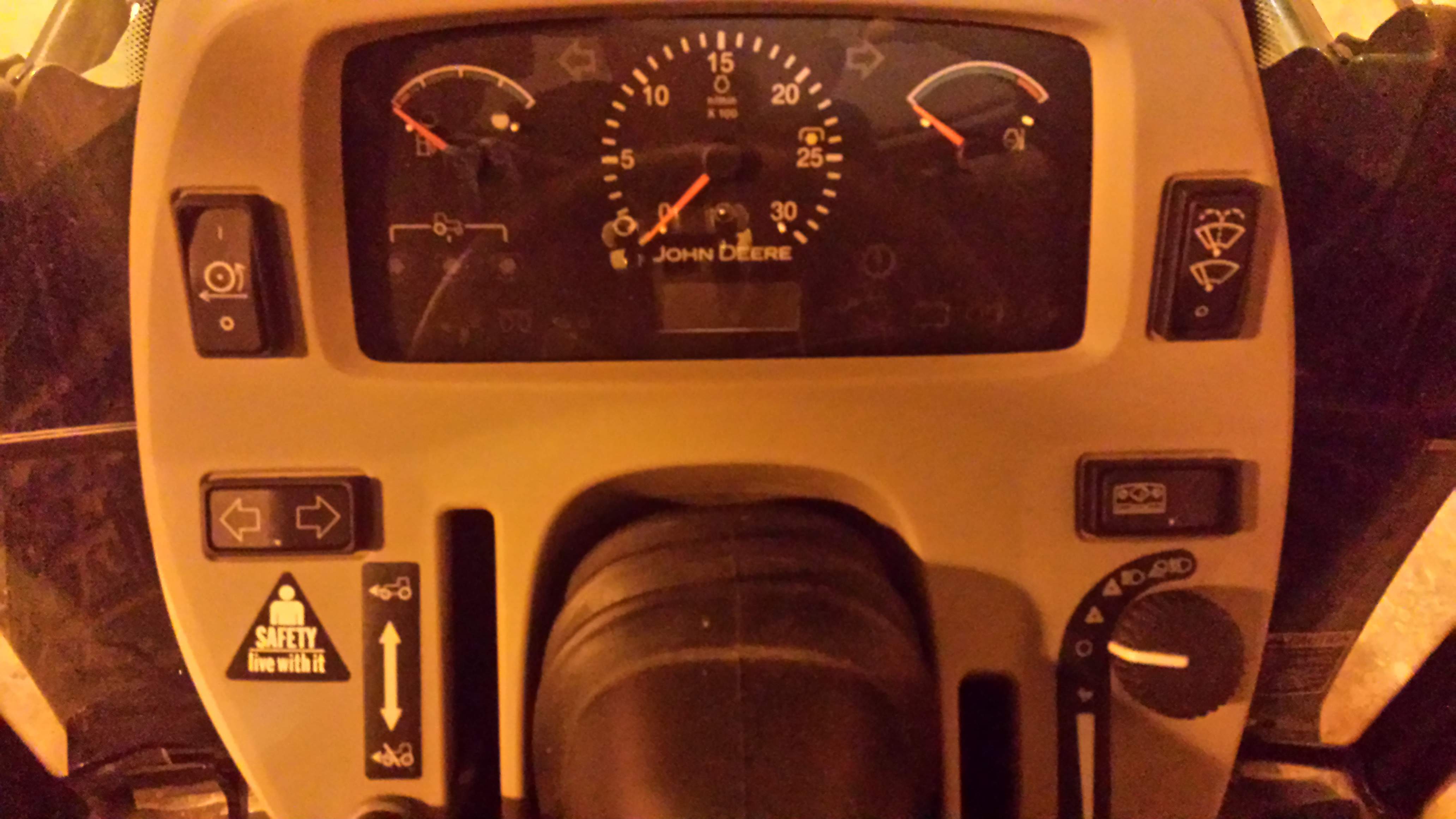

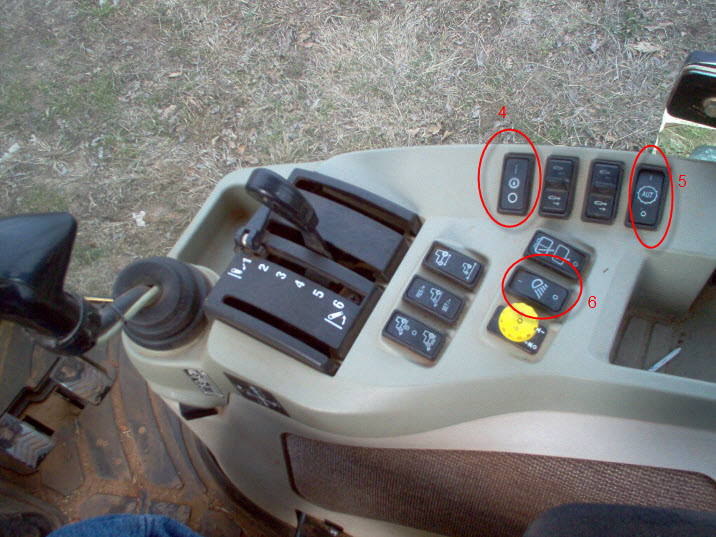

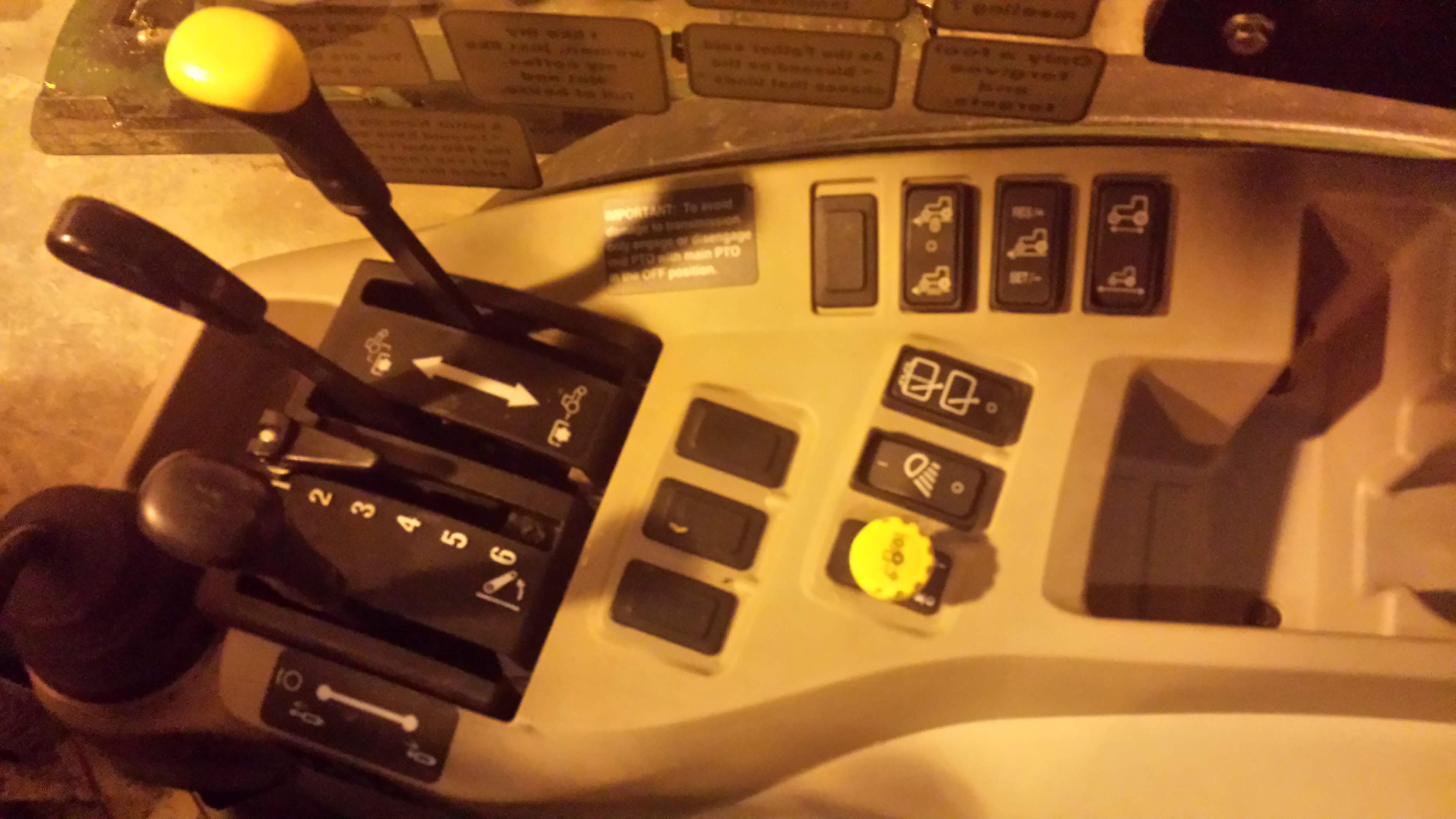

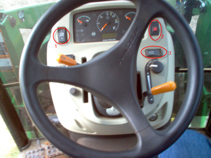

I am looking at purchasing a 2012 4520 with a cab. The seller sent me some pictures of the cab and controls. I am having trouble figuring out what options may be installed on this tractor. I can see the Automotive Cruise Control buttons. But I am not sure what some of the other buttons do. The layout is different from the standard one in the owners manual I looked at online. Can someone identify what these buttons do? i have attached a couple pictures with numbers calling out the different buttons. I really appreciate the help.

This is only a guess. 6 looks to me like the low beam on the head lights. I spent years learning to read and now they're using symbols.

4 I think is the switch to activate the Electro Hydraulic third function. I can see the gray wire running down the shaft of the loader joystick for that.
6 I think is rear worklight.

Thanks. This tractor has 3 hydraulics out the back. It looks to me like they are all electro hydraulic with one on the joystick and 2 on the side center buttons. I'm not sure I like that since I am a little old school and used to levers.

1. roll out setting, 2. who know's not oem, 3. diagnostics, display changes, etc, 4. eh 3rd scv, 5. is the auto hydro switch (ties hydro pedals to throttle), 6. a light

6 is the rear work lights on the back of the cab - i tend to use that one more than the others...
5 is motion match

Just some extra info. My dealer called the #1 switch "Load Match" It matches your ground speed with the load on the engine/ so you cannot stall out the tractor with this switch engaged. To much load on the motor and it slows up your ground speed. I always leave it engaged. There is no mid PTO because there is no lever, door side of control station. No 3rd SCV because there is no lever on seat side of control station, unless that is now electronic thru the loader joy stick. #6 is the rear work light. Somebody correct me if I am wrong.

It does have 3rd SCV, it is electric, it is on the joystick, and switch #4 is the enable for it to activate the joystick switch.
Switch 5 is the eThrottle like Morrisonsteel said.
