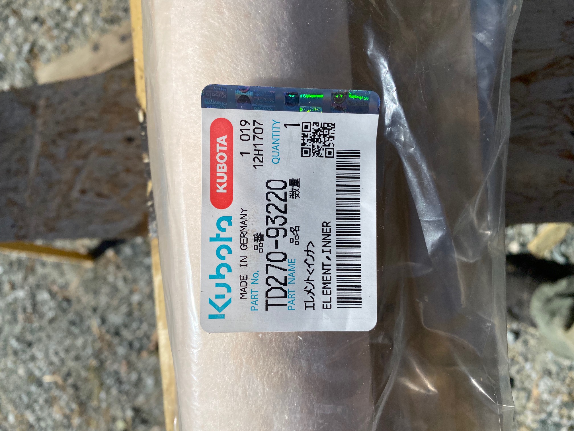

I bought the filter on the left from Messicks ages ago, intending to replace it in my L5240. But when I extracted the filter the previous owner had installed, it looked nothing like the Messicks recommended filter. It was actually a John Deere filter! Go figure.I really wish the Kubota Operators manual would show part numbers for regularly used spares. To make matters worse, the bag says 93220 but the filter says 93221.
Does anyone know what's going on here? Very confused.

The blue filter looks like my Kubota inner filter. The Kubota part number is TA040-93220.
   / Need help with identifying L5240 inner air filter
I think I've figured it out. The filter I got is for a 2010 L5240 or later. Mine's a 2007. The number looks like it should be a 3111-19130. Going to try to exchange.
