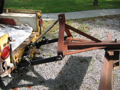

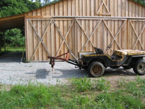

Success! /forums/images/graemlins/grin.gif I got the system plumbed properly and the lift is working. Here is a picture in front of my new barn.
   / Need help with hydraulic system.
And here is a closer look at the lift. Thanks to all for help suggestions. We will post more pictures on our Web site.
