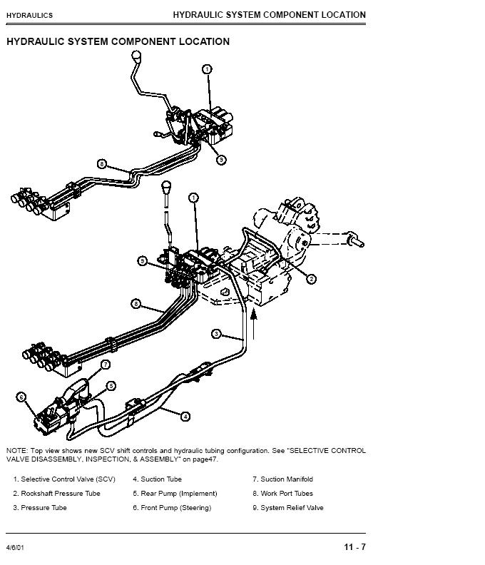

This should help, it's from my yanmar 186d manual, but they are cousins, yanmar made those deere. You are close, you just need a little plug inside the diverter block to force the flow the the loader valve. Without it the flow can just short right to the 3ph, which is why you could get some action when messing with the hitch.

   / need help with hook ups on john deere 750 to hook up FEL #12
And just remember if you ever removed your loader you will need to remove the plug. If not the Hyd system will run in relief and the rockshaft will not function.
   / need help with hook ups on john deere 750 to hook up FEL #13
It'd likely be worse than running in relief and non-fuction. Per the note in the lower right of that page, pump breakage is likely to occur. The relief is in the 3ph valving downstream of the diverter block so without removing the small internal plug when re-installing the external plugs the pump would be deadheaded and would shear the key or damage the pump.
To clarify, this is if you remove the loader permanently like if you sold it. Just removing for non-load work is not usually a problem.
When the valve stays with the tractor and the QDCs are in the working ports there is almost zero risk of the above.
Some loaders are plumbed so the loader valve removes with the loader, so the QDCs are in the pressure and return line vice working ports and you have to connect them together when the loader is removed, or else what is described above happens. This is a very bad way of doing the plumbing on this tractor.

Here are some pictures,as well as the John Deere tech manual illustration.Maybe this gets us closer.

   / need help with hook ups on john deere 750 to hook up FEL #16
From what John DeereHere posted, your loader valve must have three ports for hydraulic lines. IN, OUT and POWER BEYOUND.
IN the next picture it shows two HEX PLUGS to the right of the vertical steel line. Top hex plug is labeled "I" Bottom hex plug is labeled "O"
From the hex plug labeled "O" go to IN port on the loader valve.
From the hex plug labeled "I" go to the POWER BEYOND port on the loader valve.
From the OUT port of the loader valve you need to find a place to return the hydraulic oil to the transmission case (sump). There must be a plug for that on the side or top of the transmission case some where.
