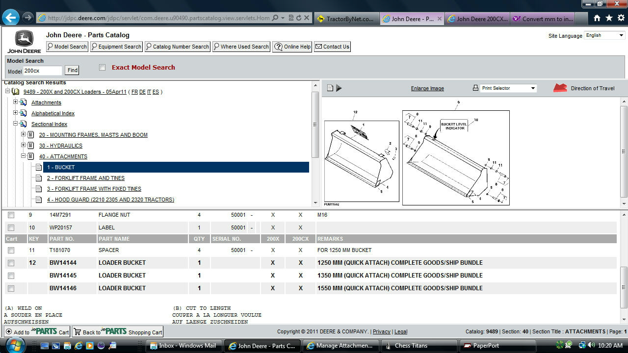

I'm shopping the 2210/2305/1026 with loader. What has the wisdom been in regards to the 49" vs. 53" bucket width?

Those tractors are roughly 47" wide. I would like to be able to rip-up topsoil at least. The tractors vary between 22-25 hp.

If I remember correctly the 49 inch bucket is a pin on design, but when you upsize the bucket you get a JDQA quick attach which allows you swap the bucket for forks in about 1 minute. What every you do get the JDQA, one day you will get forks and then you will wonder why you didn't get them sooner.
