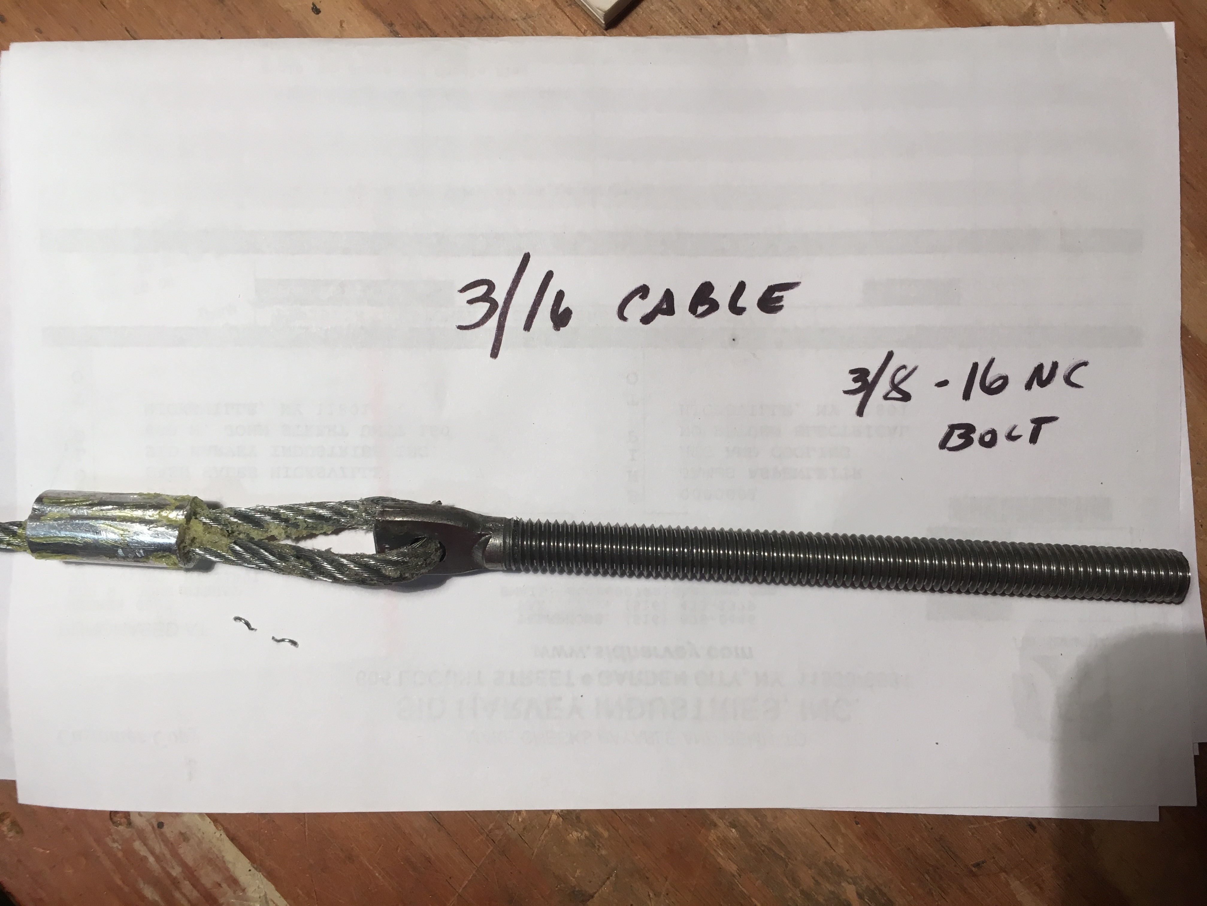

looking for a place or someone who makes custom 3/16 galv cable with compressed ferrules and a spade bolt attached.

Unless that hole is cleaned up real well, lots of them:) Looks like the cable will take a lot of abuse where it comes through the bolt.

Why not use a thimble in that wire loop and use a clevis to join the loop with the spade bolt?

i would not expect that to last long. use a cast eye bolt and a thimble or use a quick link between the spade and cable with a thimble in it. I hope you are not using this for any kind of structural application.

Actually what you really want is a swaged threaded cable end like they use for aircraft control cables.
