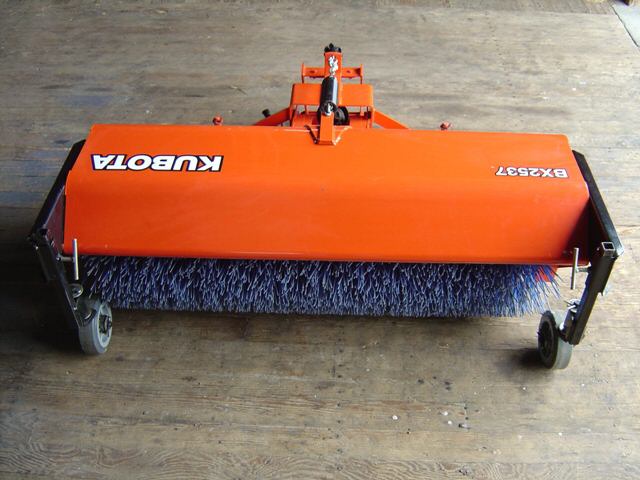

Now that I have answered your question, could you possibly post a few close up pictures of the front wheel assemblies on the rotary broom? My broom didn't come with them since they are also an accessory item. I am planning on manufacturing my own rather than buy the Kubota ones. Also, be careful using the broom on pavement that you don't wear down the bristles. A replacement bristle broom is over $600, plus labor to install it. I know of someone that purchased a broom and didn't read the instructions who wore the brush out in less than a week. He thought that the harder that you put it to the pavement the better it will sweep. To the contrary, the broom should have a light touch. I have owned a walk behind brooms for many years. Also, it is best to broom after a rain to keep the dust to a minimum... Junk..........
Kubota BX2752 mid pto for the BX1800, BX1830, BX2200, BX2230, BX22, BX23
Kubota BX2751 quick hitch for the BX1800, BX1830, BX2200, BX2230, BX22, BX23
Kubota BX2537 Sweeper for the BX1800, BX1830, BX2200, BX2230, BX22, BX23

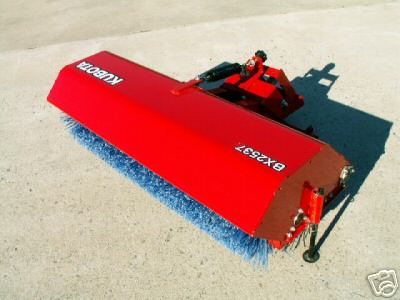

   / Need Help with BX2751 Quick Attach Assembly #5
Sweeper with Kubota Front Wheel Kit..........
