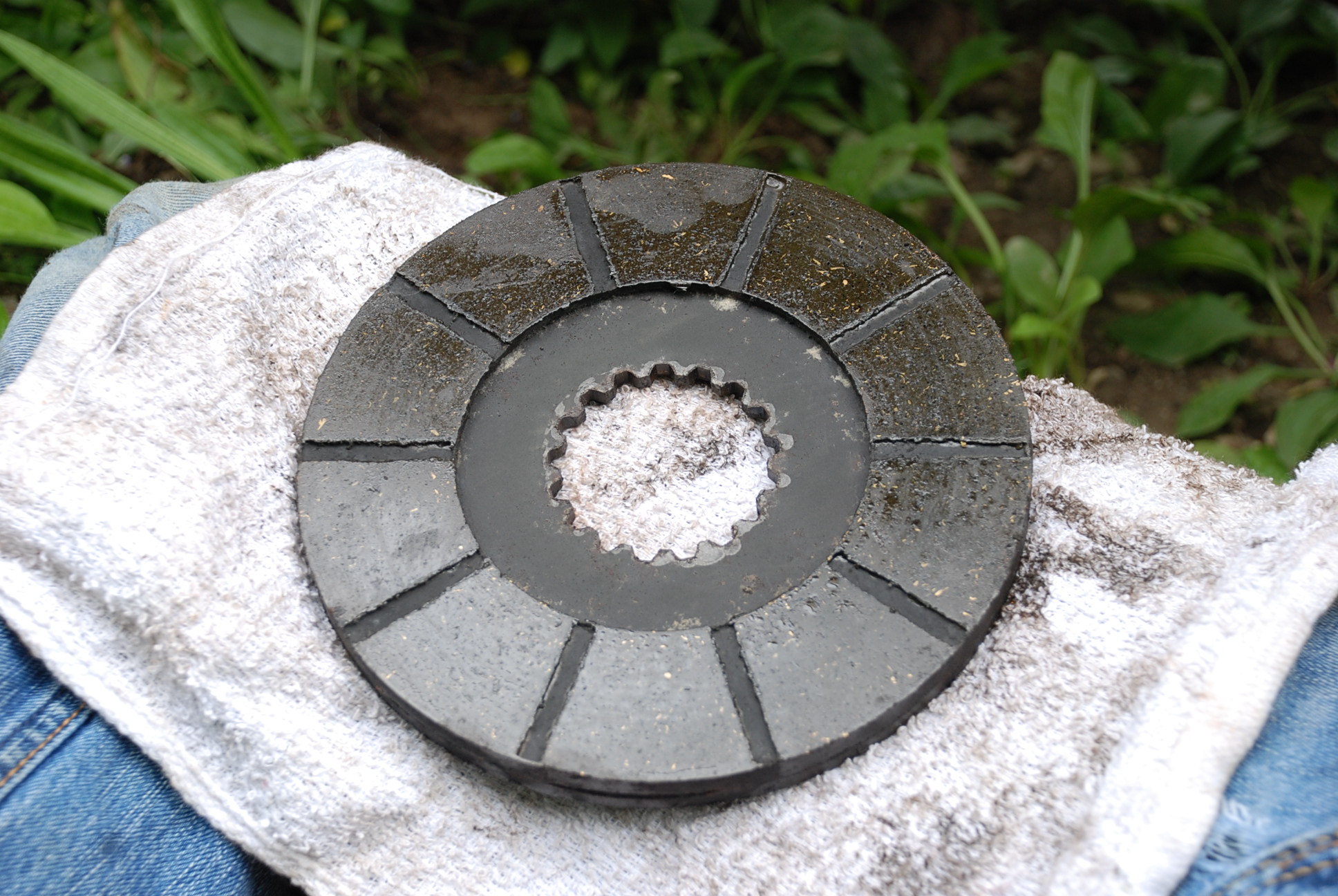

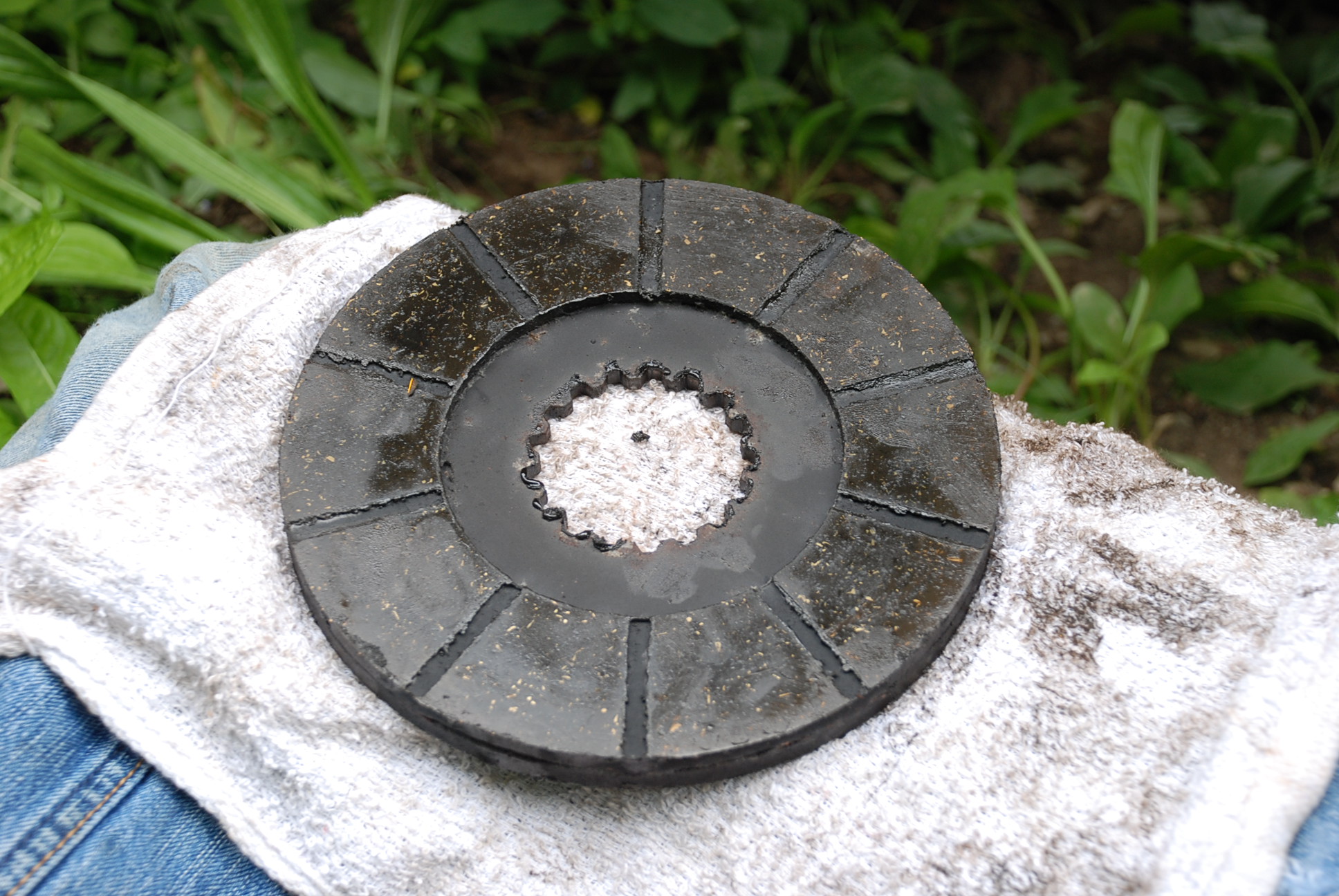

yes i found my serial plate and i have a 680-b so it looks to me that it is kinda like a clutch setup for braking... and the plate looks to me to have meat on it so to say? i'll post a pic for opinions

Looks like you have a leaky seal. You can clean those up, but it takes more than spraying with brake cleaner. This is a trick I learned from a couple of Case owners I personally know, that has had them for years, and had mechanics tell them to do this.
You need to suspend those disc's in a fashion, so as to have good clearance on both sides. I hung mine on a piece of 3/8" rod, clamped to my old hydraulic press that sets outside. Just be sure to be away from anything flammable.
If you have a propane torch, fire it up, to like medium setting, and run the flame directly on the facing. Stay on it long enough, and it will literally boil the oil out of them. My first thought was, it would surely cause them to lose their bond to the plate, but they assured me it wouldn't. The one fellow has been doing it to the same set on his 630 for years. It will take a while to get it all out. You'll not believe how much oil is in them. When the oil stops boiling out, let them cool, and do a final clean with brake cleaner. I buffed mine with a medium Roloc pad, but some fine sandpaper will buff them too. This will get you by for a short while, until you replace that seal. Last I bought were like $15.00 ea.
The seal on the bull pinion shaft, is notorious for leaking on all models with this type of brake. Not a real bad job to replace, but I have a few pointers I've picked up from another forums from old mechanics that shared their tricks of the trade, and makes it a lot easier.
