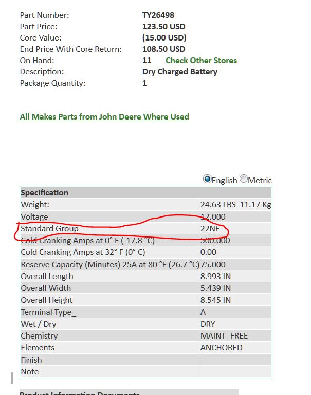

My employer owns a John Deere 3320 and the battery has gone dead. The local dealership is wanting $150 for a replacement that comes with a 6 month warranty. That can't be right but I'm having difficulty finding what model/where to purchase it. I have a hard time believing that they engineered this tractor to use a battery that only they control. Any help would be greatly appreciated.
   / Need help with battery for John Deere 3320 #2
For that size tractor, no doubt it's a standard automotive-type battery. Take it out and head down to your favorite auto parts store or other retailer that sells car batteries. If there's not a "group" number listed on the battery somewhere, try to match the size, shape, terminal orientation, and cranking amps.
   / Need help with battery for John Deere 3320 #3
TY26498 Dry Charged Battery ADD 123.50 USD Battery group 22NF is the battery(BCI) group size no matter who sells it. I'll bet the actual JD warranty is longer than 6 months.

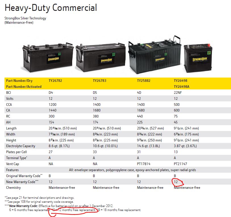

   / Need help with battery for John Deere 3320 #5
Just as I thought on warranty 12 months free replacement. Please overlook my wobbly red line as I have nerve damage and have a difficult time controlling the mouse. Pro-rata battery warranty for this battery is 36 MONTHS
