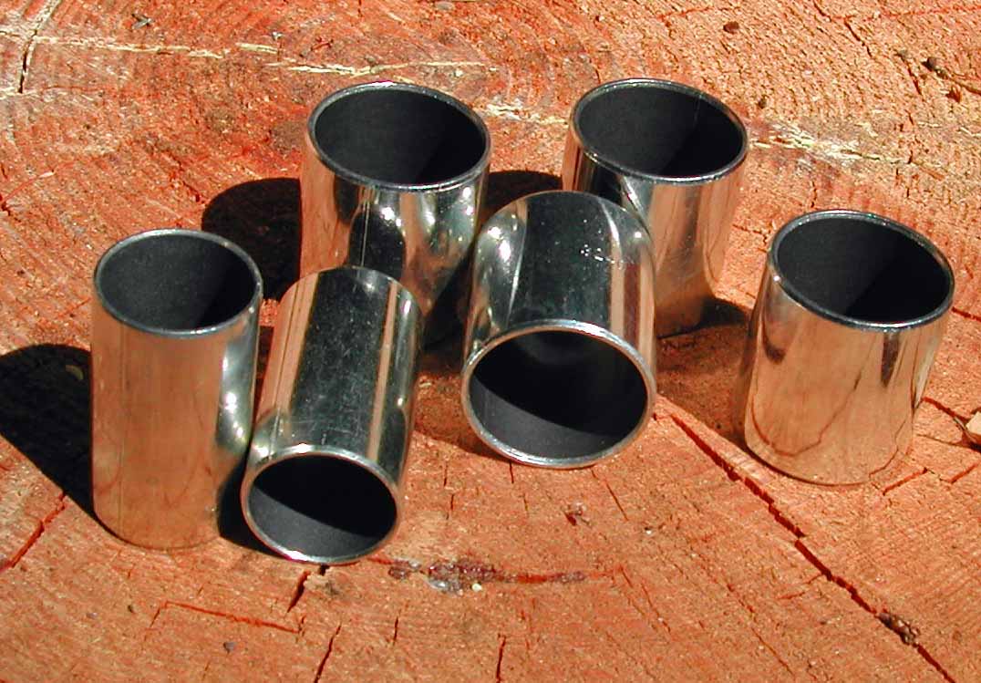

Hello all,
I have a 2015 Kubota KX-091 that I am trying to mount up a hydraulic thumb. I didn't want to spend a lot on a 'factory' one as I just put a lot of money on the initial purchase. Anyway, I picked up a very nice 32" long manual thumb and brackets online and they work great, but I want to make it a hydraulic one. I ordered a cylinder (2x14) with 1" pinholes. I was hoping to connect the 1" into the factory Kubota thumb attachment point on the dipper. It's metric of course so I'm not sure of the diameter. I do know that a 1 1/4" pin is only so slightly to big and a 1 3/16" pin is too 'sloppy'. Was hoping maybe to get a 1" inside diameter bushing with the correct diamter outside bushing to fit the machine.
Thanks
   / Need help with a thumb bushing size. #2
I buy plain bearing inserts (aka sleeve bearings) from bearing suppliers by size. My hoe uses both 25mm and 30mm pins, so the bores (without inserts) are about 2mm bigger. The inserts often have Teflon inside coatings. You can go to a place like astbearings.com and view their PDF catalog. I have also found the bearings I needed direct from China on eBay.
You may find that getting the old ones out is a lot harder than installation of the new ones.
