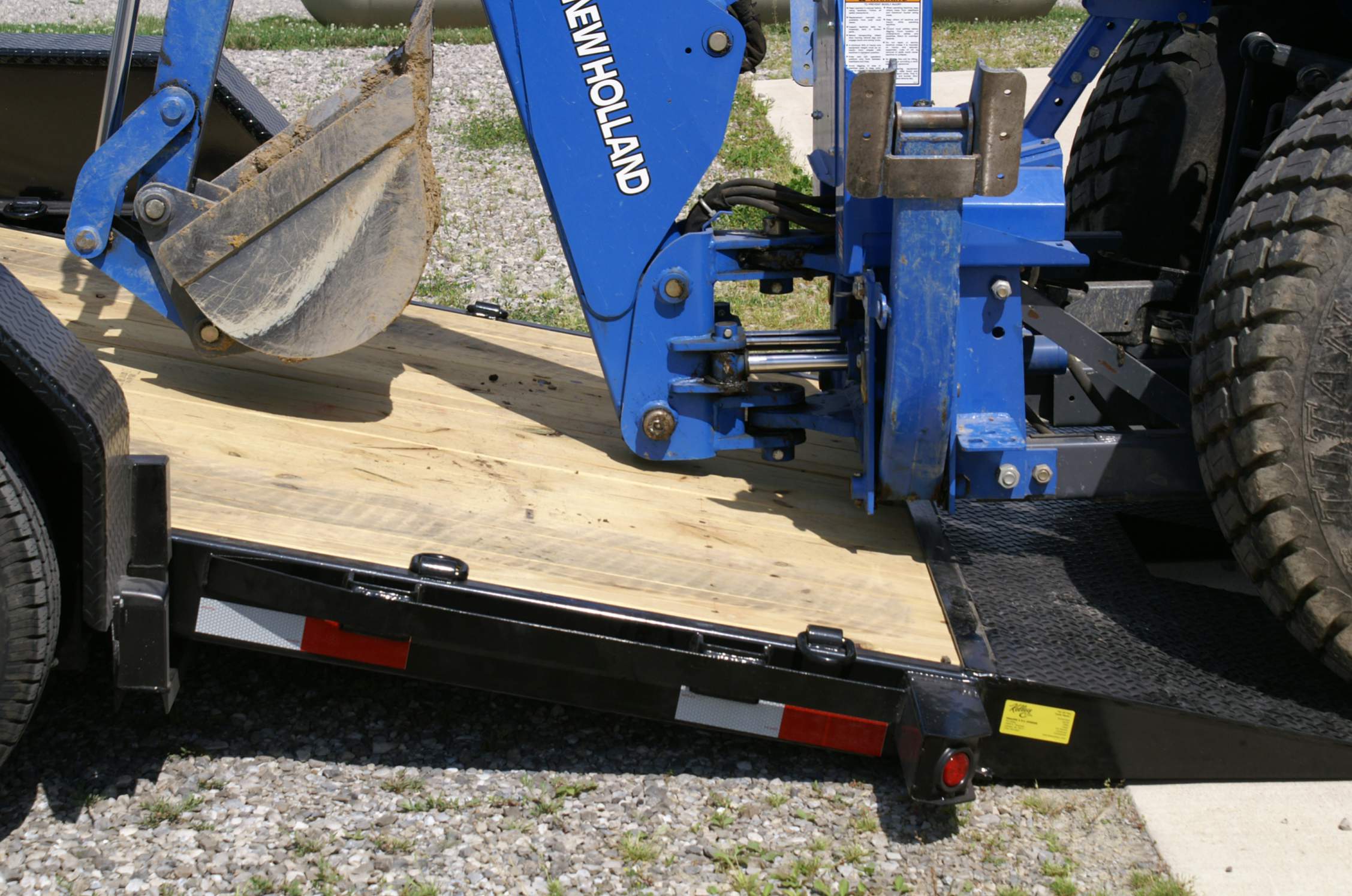

Well I got the BH hooked up. Thanks to past posts and Gregkabob. Had to order some parts because the selling Dealer would not send them to me. He did however replace the 120" hose that broke in transit but I think thatys only because he's getting reimbursed by freight co. In any case got tire of dealing with them and ordered the missing bolt and 30" hose myself. Waiting on the bolt.
I have a question. There is a bracket on the left side of the BH frame where the long hose goes through the frame, right next to a support bracket. This bracket sticks up in a sort of step shape. I have yet to figure out the purpose of this bracket. My curiousity is killing me.
Can someone enlighten me?
Thanks
   / Need help with 758c subrame install #9
When you install the backhoe, set your 3 pt arms to the narrowest positions, or just let them float so that they fit inside the sub-frame. When you lift the backhoe into position, the bracket will lift the arms up and prevent them from interfering with the swing cylinders or hoses. You can barely see them in the picture below.
