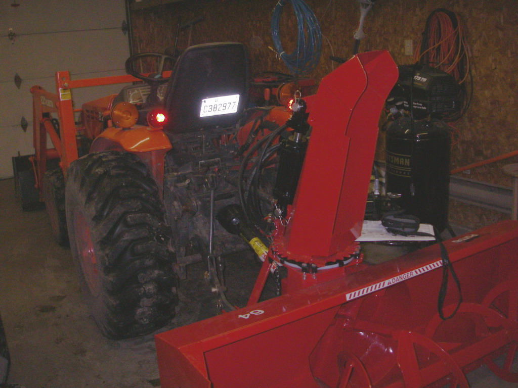

Now my concern is more about the location. My first location choice is shown in the middle of the third picture. I would install a fixation on the ROLL OVER BAR rear right and the valve should be on the side with the joystick pointing the front of the tractor. I know that there will be minor interference between the seat when rotating for Backhoe but i think i can handle it. What do you think?
Also i will not be able to use the Backhoe outlet because there a switch valve that choose between the 3 point and the backhoe. Now i am wondering where and how can i connect the main driveline to the valve ?
Thanks!

if you have a post for your fel valve why not mount it there? easier to use than on your roll bar or fender
   / Need help want to install rear hydraulic valve on b21
The idea to put the valve on the rear right was because when I snow blow with a rear snow blower i always look behind and I have my right hands near the rear fender. It was also to have the connection line near the snow blower (shorter hoses). Third it was to have valve near the rear of the tractor to use with a 3 point wood/log splitter.
But you have a very good point:
1- easy to install
2- hidden hoses
Maybe a little less ergonomic but we don't often play with rotation when we look behind. I can install a secondary valve into the wood splitter. Also I will be able to use the actual oil driveline on the FEL post valve to supply oil to the new one.
thanks! For your comments
   / Need help want to install rear hydraulic valve on b21 #6
The remotes I have seen on B21’s have had the valves mounted to a bracket that was clamped to the right rear roll bar post. I run my log splitter off of the backhoe hydraulic connections. Most log splitters will have their own valve so only a supply is needed and the backhoe supply will work for that. You do need to connect your remote valves to a power beyond port and not to the backhoe hydraulic supply though. As you mentioned the diverter valve will not let the 3pt and backhoe supply work at the same time.

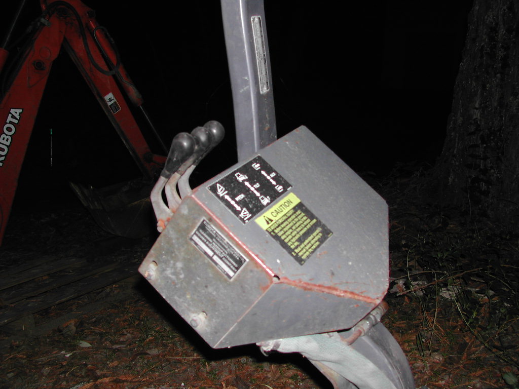

Here is photo of the 3-spool remote valve the dealer put on this
B21. It is made for Kubota by Gannon (Woods) and was used for
T & T, plus hydraulic rippers on a box scraper. My B21 also has
a 1-spool remote mounted on the FEL cross bar for a 4-in-1 bkt.
The 3-spool valve looks very OEM, the other one looks like a bit
amaturish, in terms of the installation.

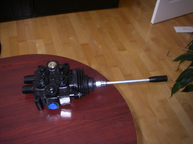

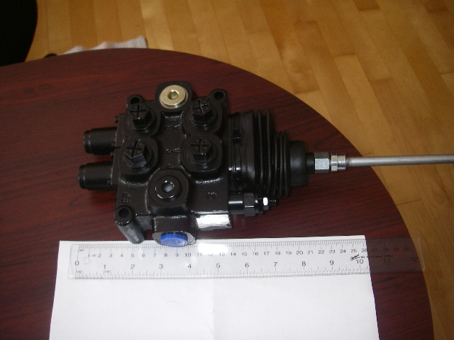

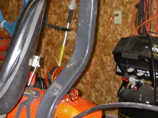

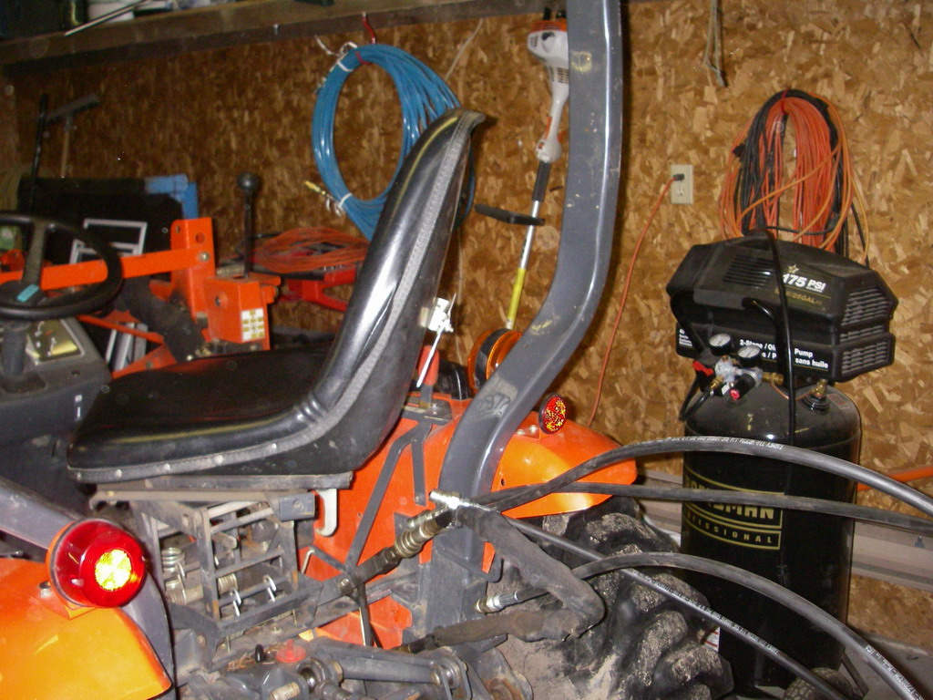

I finally bought the valve. It is a Galtech joystick q45 13 g/min. I think that I will install it on rear right fender. I will remove the flasher to have additional space. I will curve a little bit the arm of the valve. To follow, I will send additional pictures when done.
Alain
