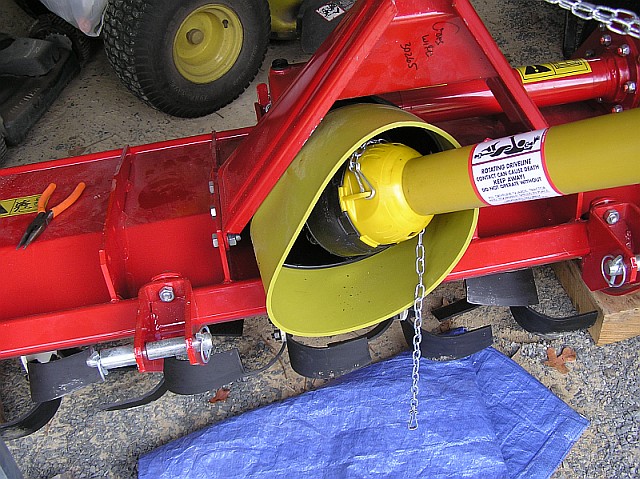

Thanks Botabill! I was hoping to actually remove the PTO shaft before cutting it, but I haven't had any luck getting to the circlip that holds the retaining pin in the PTO shaft. My springclip pliers aren't stout enough to spread the clip, and I can't figure out how to spread that ends of the clip to get it to release from the pin shaft. It doesn't help I have a 1 1/2" wide by 3" long window in the PTO guard to work through.

My Caroni flail came with a pto shaft that has spring-loaded pins both ends, not circlips - the mower end had this big "collar of shame" in addition to the guard on the shaft itself - took it off in frustration.

Here ya go. My first go at picture posting, so bear with me. Once I figure out how to get that shield off, I don't believe I'll be replacing it. Yeh, I know it's there for safety, but frankly, no one is going to be near it when it's turning.

The pic on the right looks exactly like my Caroni flail - I would get REAL familiar with the tractor end of your pto shaft - it should have a spring-loaded "button" that you push, this releases the inner pin that locks into the groove that is partway along the splines of the pto stub on EITHER end - once you're used to doing the tractor end (with your eyes closed, by braille) then you can deflect both the smaller, shaft-mounted plastic guard AND the larger, gear-box mounted plastic guard, enough (hopefully) to get your hand in and release the (I hope) spring-loaded button on the implement end.
Check the yellow tubing guarding the shaft itself - it should say "AMA (stuff) CARDAN, followed by some groups of numbers. If so, and you're lucky, this means your shaft is the same make as mine.
If all the above works out, you will then need (IIRC) a 10mm socket and maybe a 6 or 10 inch extension to remove 4 bolts holding the large "salad bowl" and a metal stiffener ring. I just set the "salad bowl" aside and replaced the bolts and ring.
Now the shaft is MUCH easier to R&R, the air doesn't get so "blue" anymore, and IMO if I have a freaky enough accident that the toplink tower doesn't keep me from getting any body parts mangled, then it's probably time to croak anyway. Besides, it's not like I'm gonna let the grandkids ride on the flail - I kinda LIKE the little buggers... Steve
