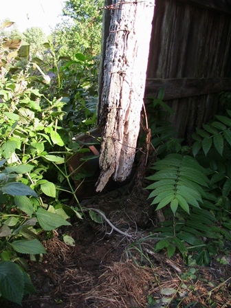

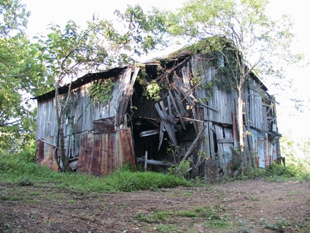

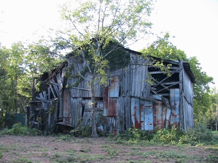

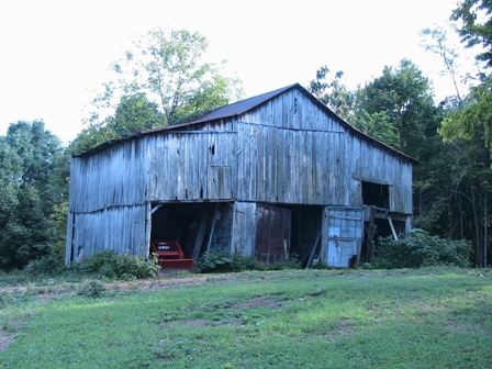

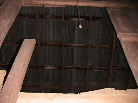

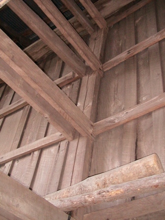

Howdy. We recently purchased an old farm that had not been used for farming in 15-20 years and we have cleared some land for fences (goats/horses) and a house for my parents. On this farm we have an old barn that could use a bit of restoration. ;)
The barn measures (if I remember the dimensions correctly) 30’ deep by 40’ wide. It is divided into 3 sections with two outer bays being roughly 12’ wide, and the center section being 16’ wide. It is about 25’ tall at the peak and at the eaves it is 15’ and 17’ tall.

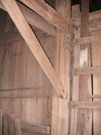

The center section is the oldest and in the best shape. It is made from square cut lumber and the posts are notched. It is braced and cross braced, and appears in fairly solid shape, save for a few posts that are rotted or with insect damage.

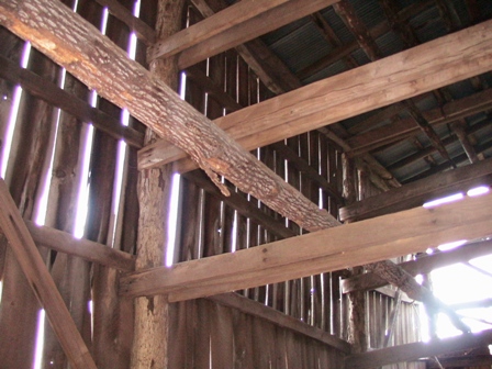

The outer bays are in the worst shape with the majority of the outer posts cut from trees which are now rotting away. The outer sections are braced against the center section and nailed into the outside tree posts (which are notched) and then nailed into ~2x12(10?) which in turn appears to be nailed to the outside wall & posts of the center section.
The barn has survived numerous strong storms, one of which recently produced 80 mph winds in our area. I would like to save/restore the barn and put it back to use as an animal shelter/hay storage building. Any ideas/suggestions/links on how to do so would be most appreciated. (I have access to old utility poles, I just need to get them hauled to the site.)
The picture of the barn front shows a Kubota L3010 peeking out of one of the bays. It was through advice on these forums that I was able to recently purchase that machine and I have been very happy with it (many thanks!). I now hope y’all can help me save this barn!

What you have there is a "Witches Hat" style barn. The beams you showed are sawn, not hand hewed, so it isn't as old as many around here. The main problems of rot are from someone not keeping the water/manure etc. off the wood and choosing the wrong species of wood in the first place.
Step one would be to put up some tarps to protect what you have from getting any more weather exposure.
Step two is brace and reinforce the parts you think you can save
Take off those parts you figure are too far gone to work with, like the bad sections of siding.
Find a small local sawmill if you can since you'll be wanting a fair amount of wood. Native stuff is way stronger than the pine/spruce/fir you'll get at a lumber store.
Rebuild the frame using locust or sassafras or treated wood where you will be in ground contact. Better, get some concrete in there and set your posts off the ground a ways. Locust is best of the naturally rot resistant woods, but it's heavier than stink. The weight is indicative of the weight, however. Sassafras doesn't rot much, but it's a lot lighter and not quite as stong as the locust. The utility poles are good, but they tend to be tapered and so you might want to get them sawed parallel on two sides at least. Cutting them produces a pretty offensive brand of sawdust from the creosote and they will burn like a coal fire if they get started, so choose your uses wisely.
There's all kind of tricks involved in jacking the thing up, straightening it out, and so on. You'll need some bottle jacks, lots of 2, 3, 4, and 5 foot sections of stout wood -- old RR ties are good -- pulleys or come alongs, and stuff like that.
I admire you wanting to save it, but that's a big job for one guy. Try to find some Amishmen or local guys familiar with barns to help. There are also professional barn restorers out there, but I don't know that they have websites.
Keep us posted as you get into this thing. It could be interesting.

You only take on a project like this if money and time are plentiful. It's extremely expensive and time consuming to save an old building, so don't even start unless it's something you really want to do.
It would be chaeper to knock it down, salvage what you can from it and burn the rest. Then build a brand new building. There are lots of options for building a barn or shop that you can do for allot less then you'll end up putting into that building.
Of course, I've been wrong on these things before and I could be wrong again, but from what I've seen in your pics, I'd walk away from it.

Thanks for the detailed restoration information. We do have a local sawmill that I can get lumber from. I’ll see what I can find there. I know that oak is plentiful, as my neighbor used 1” oak boards for siding his barn. Do you know of any good links to show the concrete post details (like diameter, depth & height of the post, rebar configuration, & the wood to concrete connection)?
As the utility poles I have access to are used, I would probably have a hard time getting them sawed parallel by someone else (worries about nail/spikes buried in the wood). Would there be a way to connect the beams (boards) without shaving the sides of the poles, such as metal hangers?

Just from the pictures restoring means rebuilding on a new foundation if you want any type of sound results.
