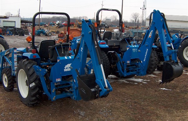

Attached are photos of the TC 30 and TC40da with the hoes on, hope they help.

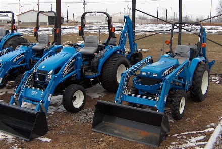

   / Need help sizing and pricing a backhoe #10
2nd.
