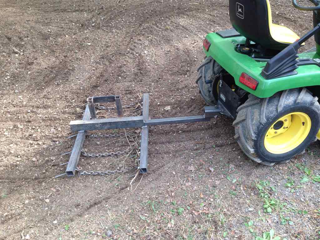

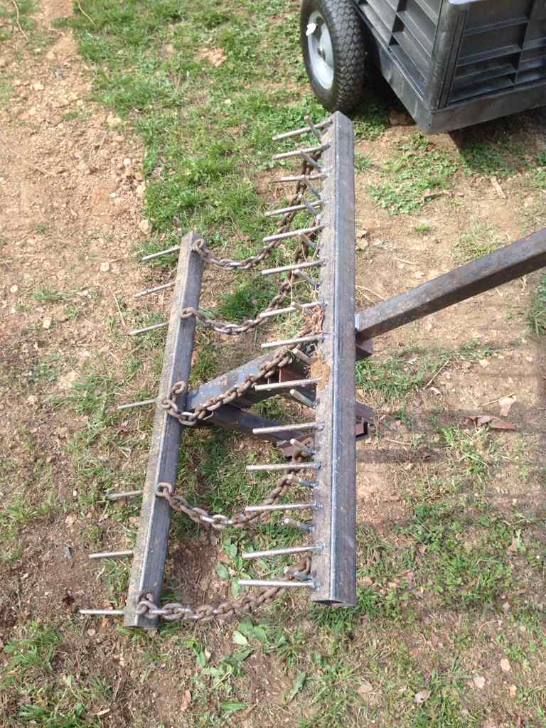

I am trying to locate plans for the Trail'GradeR road grader. Allow me to explain. I am a missionary in South Africa and reside in an area that is off the paved road. The road to our camp is less than adequate and our spring rains have begun. We have no way of grading our road and I am trying to locate some type of plans that I can weld together a road grader before the rains totally wash out our road. Our electric and internet varies depending on the day. In the little research I have done, I saw a video of the Trail'GradeR and it looks like something I may be able to cobble together with scrap I have here in Africa. If someone knows of some free plans or a free PDF download, please let me know. It would be greatly appreciated. Thanks in advance from South Africa. Sunbury Christian Camp.

Check this out:
homemade driveway drag - Yesterday's Tractors
From there I saved these:
1)This is the same as #5

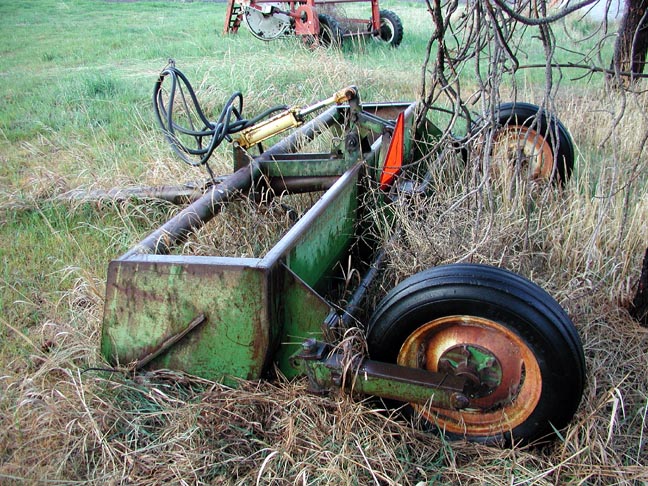

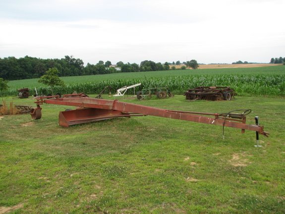

2) This can be made with various other methods of adjustment [other than hydraulics] same as #10: JD Kilefer land grader2.jpg

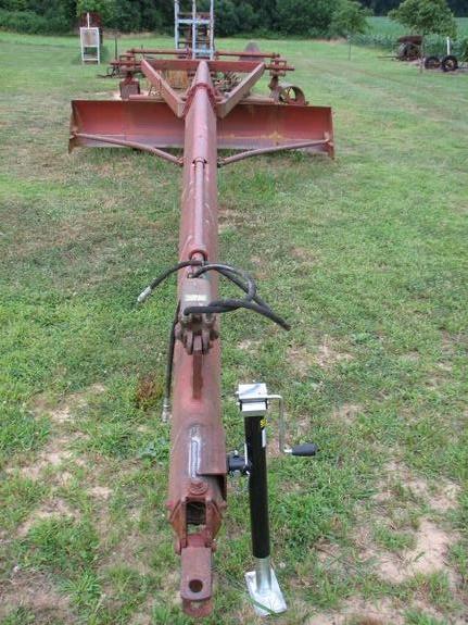

3) The longer the tow bar, the less waviness of the road- it keeps the blade from moving as much up and down with shifts in the tractor IMG_165221.JPG

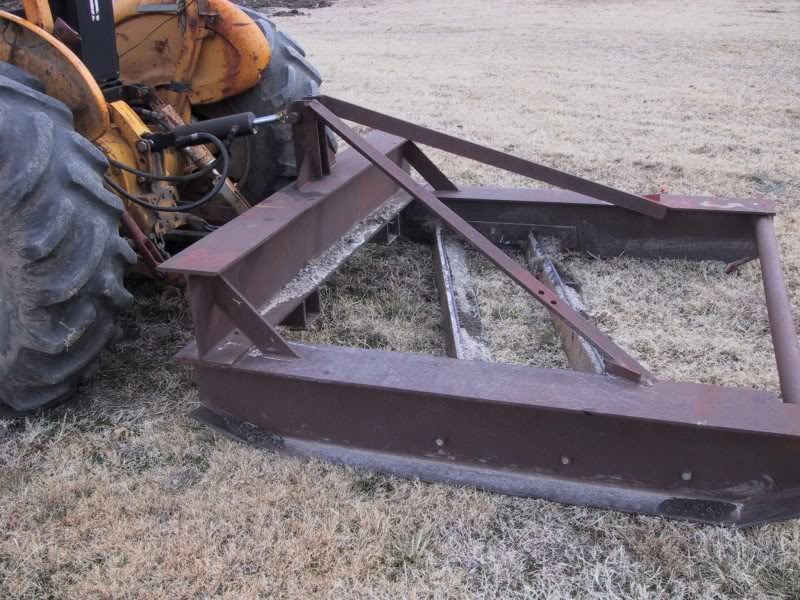

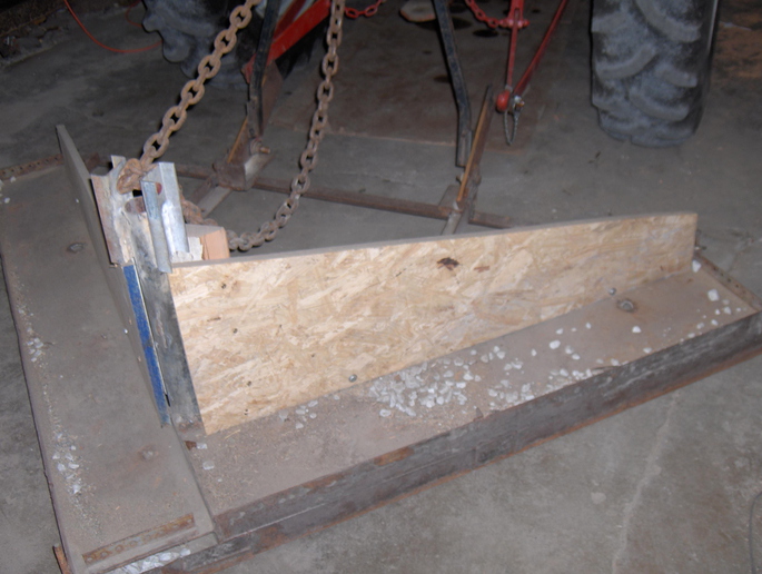

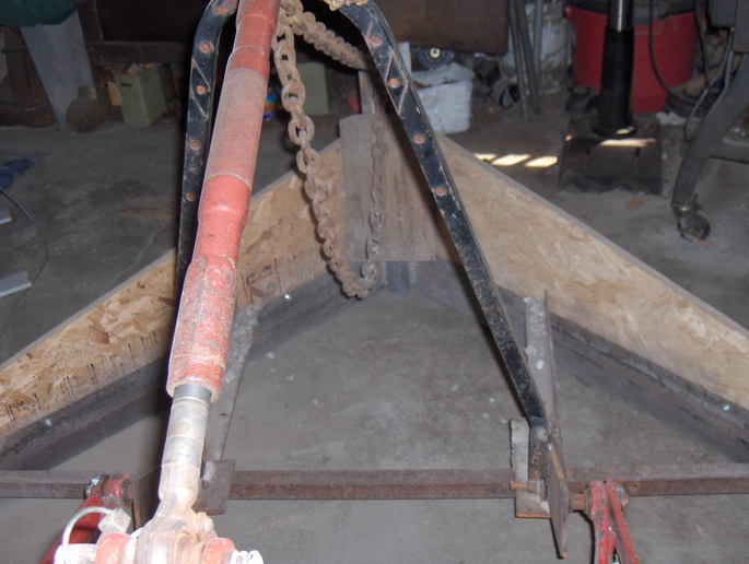

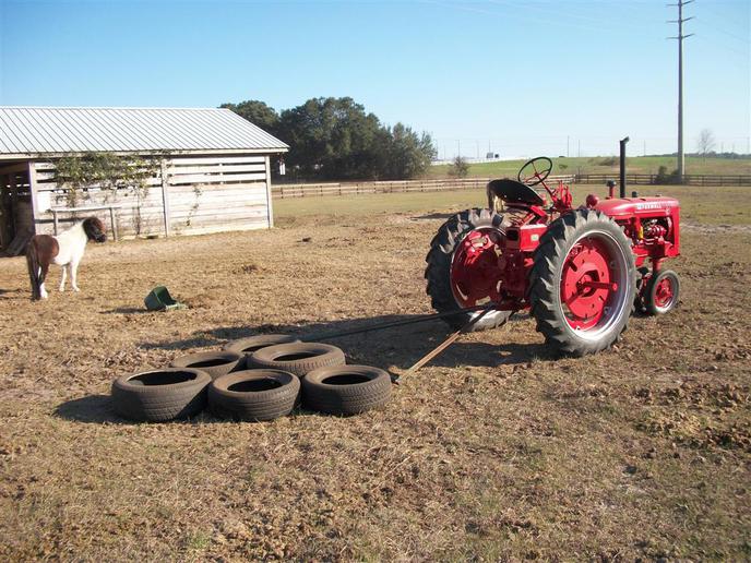

8) This is perhaps the simplest way to grade, but probably also the least aggressive and efficient. It could be made more so by either adding weight on top of it, or, adding bolts through the tire sidewalls similar to the tines on #1 & 3. Tire grader.jpg

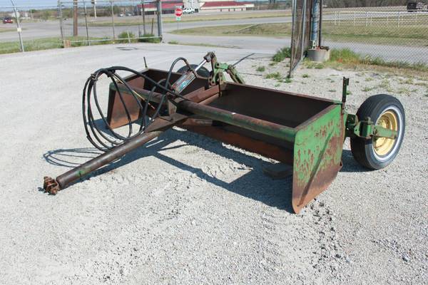

10) This is a box grader [same as #2] and again, the adjustment mechanism could be fabbed from a screw and thread assembly like a trailer jack or even using a pin-through post and sleeve arrangement. JD Kilefer land grader.jpg
While none of them are plans- most would be easy to figure out a way to copy - and the 6th and 7th pictures in particular would be amenable to kludging up with whatever parts/pieces of scrap you could lay hands on.
On the other hand, many people here have used such makeshift graders as a towed I-beam or a raft of tires very effectively.
One thing they all mention is that adding weight almost always makes it more effective in use.
I hope this helps.

You didn't tell us what you intend to pull it with.
Something along the line of the grader that comes up from post #4 would be the way I'd go.
